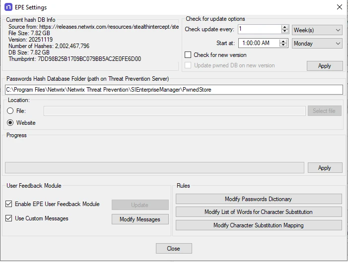

EPE Settings Window

Configuration Settings
Click Configuration > EPE Settings on the menu to open the EPE Settings window.
The EPE Settings window is only available to Threat Prevention administrators.
The window displays current hash database information and has the following configuration settings, displayed in sections on the window.
Current Hash DB Info
The Current hash DB Info area is enabled after the HIBP database has been deployed to Enterprise Manager for the first time. It displays the source from where the database was downloaded, its size, version, and the number of hashes it contains. It also shows a thumbprint value that changes whenever the content of the Hash DB changes.
Remember, the HIBP dataset is updated at random intervals by its publisher. It can go weeks or even months with no changes.
Check for Update Options
The Check for Update options area specifies when the Netwrix website is checked for a new version of the HIBP database.
These options are enabled after the HIBP database has been deployed to Enterprise Manager for the first time.
Configure the following options:
Check update every [number] [unit of time] – Select how often the Netwrix website is checked for a newer version of the HIBP database
Start at [time] [day] – Select the time and day when Threat Prevention will check the Netwrix website for a newer version of the HIBP database
Check for new version – Checks the Netwrix website for the latest password hash file details and compares the SHA-1 to the local hash file to determine if the website has a newer version of the HIBP database. If only this option is selected, then an alert is generated in the Administration Console when a new version is detected.
noteThis checkbox doesn't automatically download the new HIBP database version.
Update pwned DB on new version – Checks the Netwrix website for HIBP updates and then updates the Enterprise Manager server if a new version is detected
After making selections, click the Apply button to enable checking for updates at the scheduled intervals.
Passwords Hash Database
Threat Prevention uses the Passwords Hash database to check if users’ new and pending password (i.e. during a password reset) matches the hash of a compromised password from a data breach.
First-time configuration of this window requires downloading the HIBP database from the Netwrix website. If the Administration Console doesn't have internet access, see the Download and Configure the Have I Been Pwned Hash List topic for instructions.
Ensure the initial update of the database occurs during non-office hours. Due to the size of the hash file, this download takes up a significant amount of CPU and download time.
- Passwords Hash Database Folder (path on Threat Prevention Server) – Central location of the Pwned database on the application server. The default path is:
…\Netwrix\Netwrix Treat Prevention\SIEnterpriseManager\PwnedStore
Location:
File – If the application server doesn't have internet access, you can manually download the HIBP database and select the File radio button to browse to your local copy of the database.

Website – This option points to the Netwrix website that hosts a copy of the latest HIBP database. This is the default option and the preferred method if the application server has internet access.
Apply:
- If Website is selected, then clicking Apply downloads the HIBP database from the Netwrix website and then processes the database for use by the application
- If File is selected, then clicking Apply will process the local copy of the (manually obtained) database for use by the application
User Feedback Module
The optional EPE User Feedback module (also known as the Credential Provider) provides feedback to end users by listing the reasons the Enterprise Password Enforcement (EPE) event type has rejected a candidate password.
EPE offers multi-language support, ensuring users receive clear and consistent password rejection messages. Supported languages are:

Remember, the module must be deployed to end user computers.
The User Feedback Module section has the following check boxes:
- Enable EPE User Feedback Module – Select this checkbox to enable integration between an optional EPE User Feedback module and the Threat Prevention Agent on a domain controller. Click Update to apply the current state of the checkbox to the module.
- Use Custom Messages – Select this checkbox and click Modify Messages to open the Custom Messages Editor window, where you can customize password rejection messages for the EPE User Feedback module.
By default, messages are available in the English language.
- Use the Language dropdown menu to select a language, The Default Message column displays messages in English while you can edit the Custom Message column to provide the message in the selected language.
- To edit, double-click a row in the Custom Message column and enter a message. Click OK to save changes or Cancel to discard them. Select Reset to revert all customized messages back to defaults.
The string "0" is a placeholder populated at run time with specific values leading to the password being rejected. The string "0" must be included in all custom messages where you want to display the run time generated information.
Rules
The following windows are global settings for the EPE Password Rules filter within the EPE Settings window. Whatever is configured in these windows is applied across all EPE Password Rules filters in the Administration Console.
You can monitor or block an event with these global settings:
- Modify Password Dictionary – Requires an exact match between a user entered password and the password in the dictionary
- Words List of – Global list of character substitutions found in passwords. Uses the Substitution Editors map to check all permutations of a pending password.
- Substitutions Editor – Create a character substitution map used to create password permutations for the Words List dictionary
