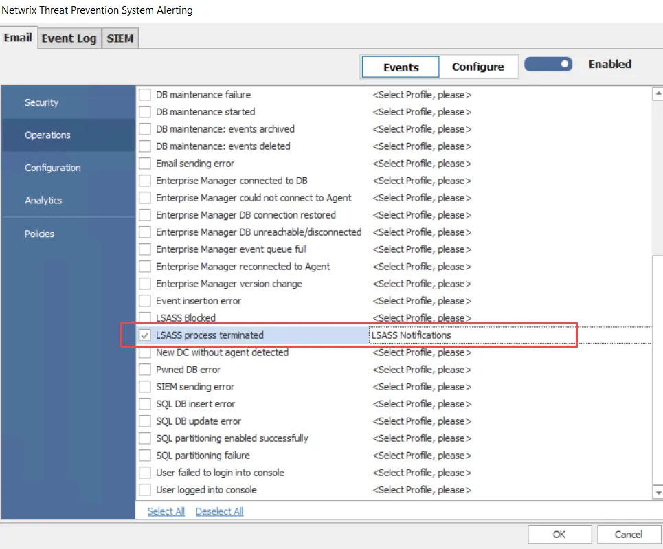

Step 1 – Click Configuration > Alerts on the menu to open the System Alerting Window.
Step 2 – On the Email tab, click Configure.
Step 3 – Create a Message Profile for the LSASS notification with the recipients to be notified when the LSASS process terminates. See the Create Message Profiles topic for additional information.
System Alerting window - LSASS Process Terminated alert
Step 4 – On the Email tab, click Events, and then click Operations in the left pane. Check the LSASS process terminated event alert and select the Message Profile created in Step 3 from the dropdown menu. See the Email Tab topic for additional information.
Step 5 – Ensure that the email alerts are enabled, as indicated by the Enabled toggle button, and click OK.
When the LSASS process terminated event alert is triggered, an email notification is sent to the assigned (step 3) recipients.
