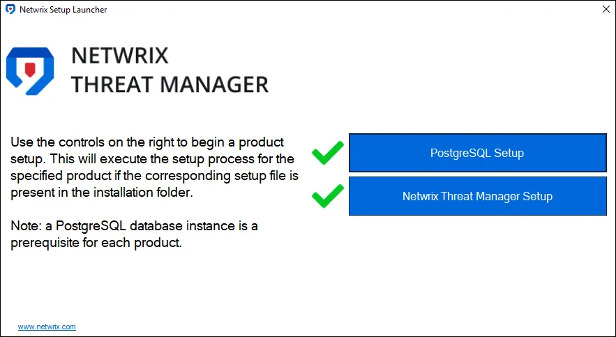

Step 1 – Run Netwrix_Setup.exe as an administrator. The Netwrix Setup Launcher window is displayed.
Netwrix Threat Manager Setup window

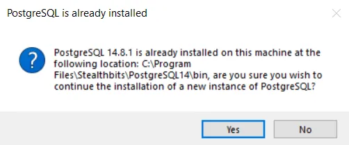

Step 2 – Click PostgreSQL Setup to upgrade the PostgreSQL version. The following message is displayed, indicating the installed version:
Threat Manager Reporting - Upgrade DB Confirmation dialog box
Step 3 – Click OK to upgrade. The Netwrix PostgreSQL Setup wizard opens.

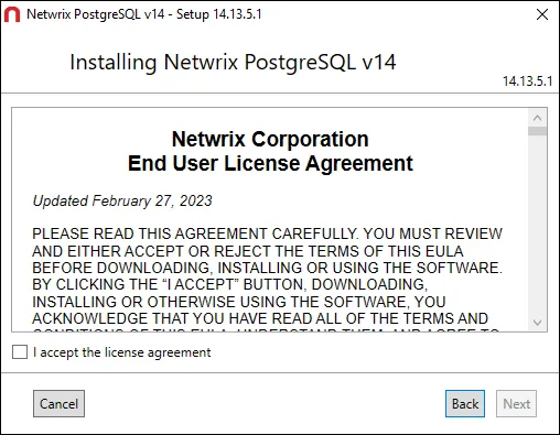

Netwrix PostgreSQL Setup wizard on the EULA page
Step 5 – Read the End User License Agreement and select the I accept the license agreement checkbox. Click Next.
Step 6 – The installation begins and the installer displays a Setup Progress window. Click Exit when the installation is successful to close the wizard.

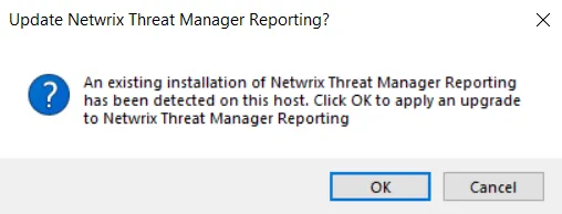

Step 2 – Click Netwrix Threat Manager Setup to upgrade to version 3.0 of the Netwrix Threat Manager Reporting Module. The following message is displayed:
Threat Manager Reporting - Upgrade Application Confirmation dialog box
Step 3 – Click OK to upgrade. The Netwrix Threat Manager Reporting Setup wizard opens.
