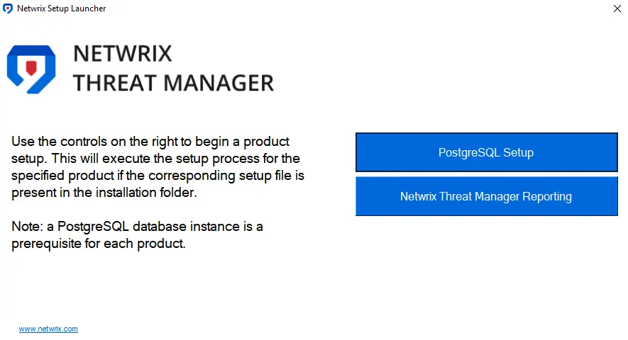

These steps assume you have launched the installer through the Netwrix Setup Launcher (Netwrix_Setup.exe). If you aren't using the launcher, right-click NetwrixPostgreSQL14.exe and select Run as administrator. Then skip to Step 2.
Step 1 – Click PostgreSQL Setup. The Netwrix PostgreSQL Setup wizard opens.

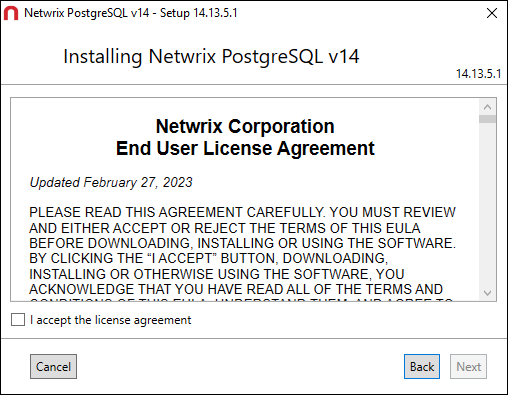

Step 2 – Click Install.
Netwrix PostgreSQL Setup wizard on the EULA page
Step 3 – Read the End User License Agreement and select the I accept the license agreement checkbox. Click Next.
