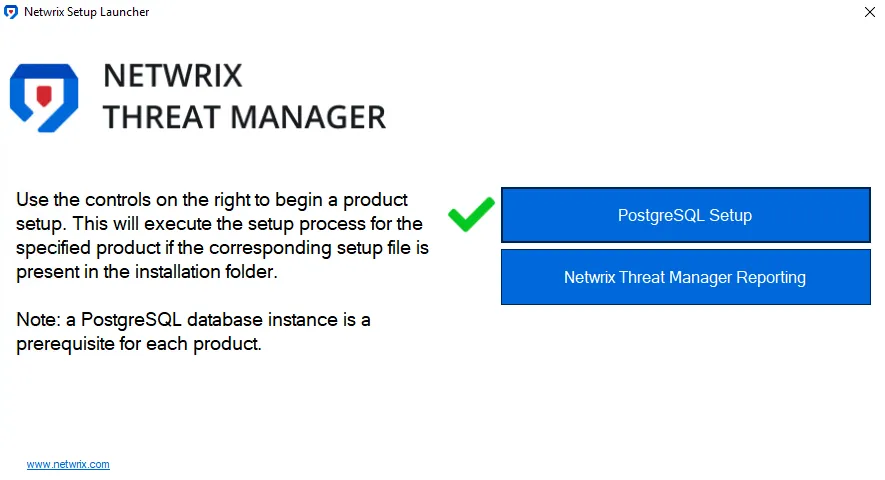

These steps assume you have launched the installer through the Netwrix Setup Launcher (Netwrix_Setup.exe). If you aren't using it, right-click NetwrixThreatManagerReporting.exe and select Run as administrator. Then skip to Step 2.
postgresqlcheck
Step 1 – Click Netwrix Threat Manager Reporting. The Netwrix Threat Manager Reporting Setup wizard opens.

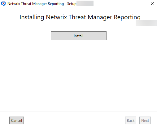

Step 2 – Click Install.

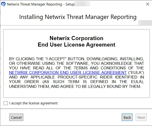

Netwrix Threat Mannager Reporting Setup wizard on the End User License Agreement page
Step 3 – Read the End User License Agreement and select the I accept the license agreement checkbox. Click Next.

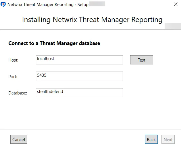

Netwrix Threat Mannager Reporting Setup wizard on the Database page
Step 5 – On the Database page, ensure the host and port are set correctly. If installing on the same server where the PostgreSQL database application was installed, this information will be accurate by default. The default database name is stealthdefend; however, it can be modified as desired. Click Test to validate the connection information.
Warning message that the database doesn't exist, Create?
Step 6 – If a successful connection is made, a message window displays confirming the database doesn't exist and you want to create it. Click OK and the window closes.

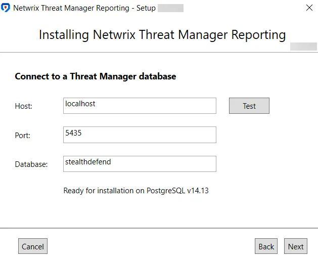

Netwrix Threat Mannager Reporting Setup wizard on the Database page showing Ready for installation message
Step 7 – A "Ready for installation" message appears on the Database page of the wizard and the Next button is enabled. Click Next.

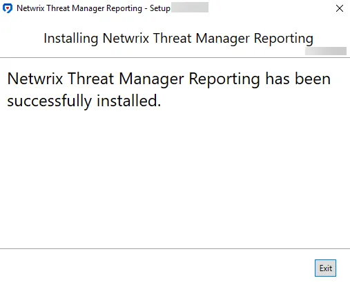

Step 9 – The installation process will begin and the Setup wizard will display the progress. Click Exit when the installation completes successfully. The Netwrix Threat Manager Reporting Setup wizard closes.

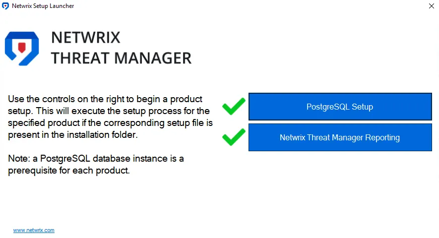

Netwrix Setup Launcher showingThreat Manager Reporting Setup completed
Step 10 – Now that both components have been installed, close the Netwrix Setup Launcher.
