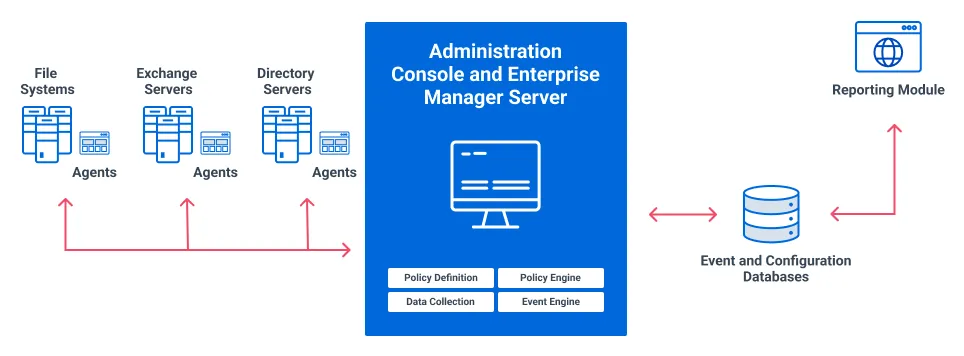

Threat Prevention Architecture
Threat Prevention Architecture Diagram
Threat Prevention Enterprise Manager
The Threat Prevention Enterprise Manager stores and maintains policies and policy templates, as well as receives and processes all captured events. Only one Enterprise Manager is needed for any environment.
Threat Prevention Administration Console
The Threat Prevention Administration Console is used to create and manage policies and their associated alerts and actions. Multiple instances of the Administration Console are supported.
Threat Prevention Agents
The Threat Prevention Agents retrieve configuration data from the Enterprise Manager, monitor network activity, and report events to the Enterprise Manager. The events collected by an Agent are those specified by the policies that are active in the system. There must be an Agent deployed on every server being monitored. See the Agent Information topic for information on where to deploy Agents and supported platforms. See the Agents Interface section for deployment procedures.
Netwrix Threat Manager Reporting Module
The Netwrix Threat Manager Reporting Module application provides a way to generate and to view reports for the event data that is collected by the Agent and stored in the event database. Reports can be generated for specific time frames and saved as CSV or JSON files. These files can be downloaded or emailed. See the Reporting Module topic for additional information.
