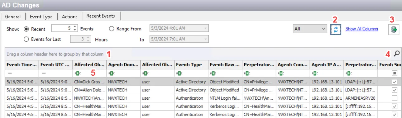

  • The Group by Box [1] ribbon impacts how much data is displayed. See the Sort Data topic for additional information.
  • The Refresh [2] button populates the data grid with the current information according to the selections.
  • Columns can be reordered as desired as well as removed from the data grid. Removed columns can be added back through the Customization Window.
  • Many data grids also contain an Export Data [3] button. This provides different export options with respect to the interface. See the Export Data topic for additional information.
  • The Search [4] icon opens the Enter text to search… textbox where you can search for the required data in the data grid. See the Search Data topic for additional information.
  • The Auto Filter row [5] uses comparison operators to filter the grid against a single attribute. See the Filter Data topic for additional information.

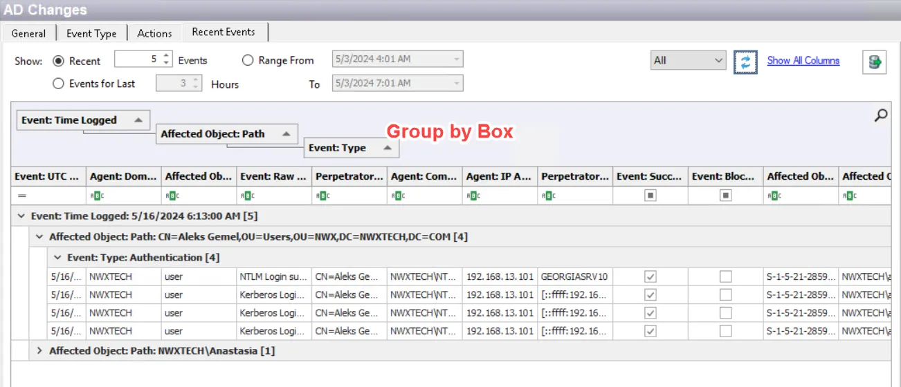

Data can be grouped by columns using the Group by Box ribbon above the data grid.
Sort Data function in the data grid
Drag a column header into the Group by Box area to group data from that perspective. You can group by a single header or by tiered headers.
Data can also be sorted alphanumerically ascending or descending by clicking on a column header. An arrow displays in the right corner of the column header indicating the type of sorting.

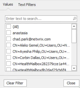

Pin Icon
A small pin icon is displayed in the upper-right corner while hovering over a column header or if an Auto Filter Row filter is enabled.
Click the pin icon to open additional filtration options in a filter window. The options displayed depend on the column it is opened from.
Window with filtration options
  • Values – Displays for every column in the data grid. Multiple values can be selected.
  • Text/Numeric – This is linked to the Auto filter Row filter with the addition of three new filtration options including a custom filter option
  • Date – Calendars with date timestamps display this filter with an array of scoping options including a custom filter
  • Custom Filter – Found within Text filters, this filter creates an AND or OR statement between two filtered comparison values

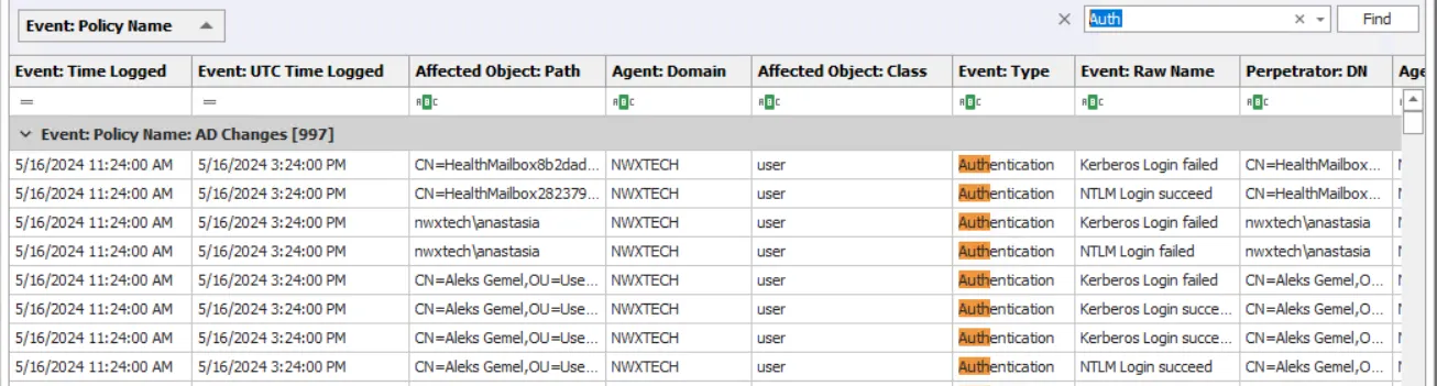

Use the Find Panel to search for data in the data grid. It is represented with a magnifying glass icon. It is displayed by default but you can choose to hide or show it using the Show/Hide Find Panel option on the Data Grid Right-Click Menu.
When you click the magnifying glass icon, the Find box appears as:
Search function for data grid
  • Enter a search criteria and click Find. The data grid filters to events where the search criteria is matched, highlighting the match.
  • The dropdown arrow in the textbox provides a history of recent searches for quick reference.
  • Click Clear to clear both the search criteria and the filtered view.
  • The X at the far left of the panel closes the Find Panel.
