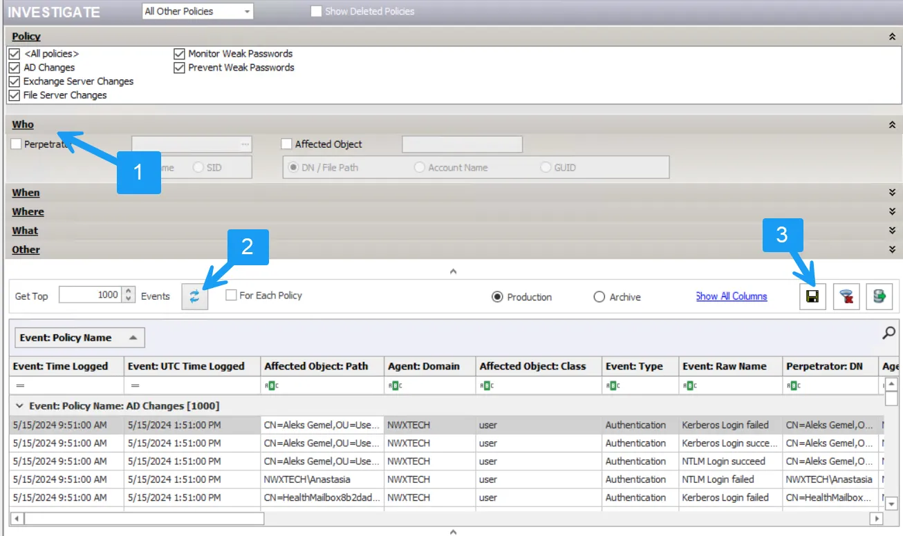

Step 1 – Click Investigate in the left pane to launch the Investigate interface.
Step 2 – Set the filter [1] as desired, Refresh the data grid [2], and click Save Filter Settings and Layout [3]. The Filter Set Name window opens.
Step 3 – Enter a name for this filtered view and click OK.
Saved filter view in the navigation pane
The saved filtered view becomes a node in the Navigation pane under the Investigate node. Select the node to return to the saved filtered Investigate view.
