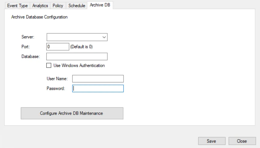

Configure the Archive Database​
Step 1 – Click Configuration > Database > Maintenance on the menu. The Database Maintenance window is displayed. Click the Archive DB tab.
Database Maintenance window - Archive DB tab
Step 2 – Enter the following information for the database where data is to be archived:
  • Server – SQL Server where the archive database is located
  • Port – Instance port number, by default this is set to 0
  • Database – Name of the archive database
  • Authentication
    • For Windows Authentication – Check the Use Windows Authentication box
    • For SQL Authentication – Enter theuser name and password of an account to use for SQL authentication
Step 3 – Click Save to save the configurations.
Ensure archive database settings have been configured and the archiving process has run at least once.

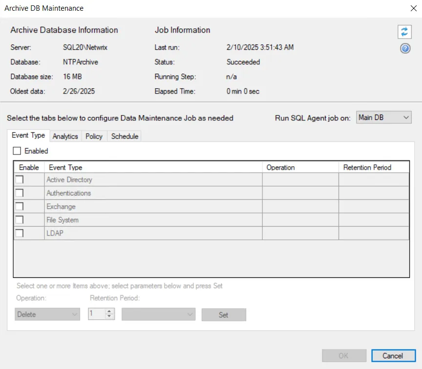

Step 2 – Click the Configure Archive DB Maintenance button. The Archive DB Maintenance window is displayed.
The following information is displayed at the top of the window:
  • Archive Database Information:
  • Server – SQL Server where database maintenance is performed
  • Database – Name of the database
  • Database Size – Current size of the database
  • Oldest Data – Date of the oldest data in the database
  • Job Information:
    • Last run – Date timestamp when the last database maintenance job was executed
    • Status – Status of the job. Different statuses are:
      • Idle – Indicates that no database maintenance task is running
      • Succeeded – Indicates that the most recent job finished without error
      • Running – Indicates that a job is running
      • Error – Indicates that the job started but terminated on an error
    • Running Step – During job execution, this field populates with the step being executed
    • Elapsed Time – Overall elapsed time of job execution
The Refresh button in the upper-right corner refreshes this database and job information.
Step 3 – From the Run SQL Agent job on dropdown menu, select an option to determine the SQL Agent that will run the maintenance job.
  • Select Main DB if the archive database resides on the same SQL Server machine as the NVMonitorData database.
  • Select Archive DB if the archive database resides on a different SQL Server machine than the NVMonitorData database.
Step 4 – On the Event Type, Analytics, and/or Policy tabs, enable maintenance for all or some of the options. See the Enable Database Maintenance topic for additional information.
The Event Type Tab, Analytics Tab, and Policy Tab on the Archive DB Maintenance window are the same as on the Database Maintenance window, except that only the 'Delete' operation is available for the archive database.
