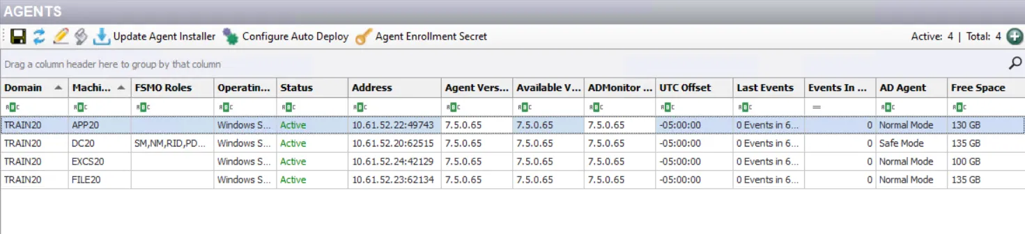

Agents Data Grid​
The Agents data grid displays information on each domain where an Agent is deployed.
The upper-right corner of the data grid displays the Agent tally, indicating the number of active Agents as well as the total number of deployed Agents. The data grid displays the following information for an Agent:

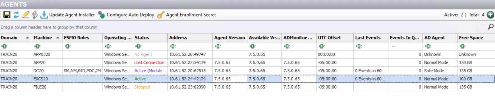

  • Status – the Agent’s current status:
    • Active (green) – The Agent is actively monitoring/blocking events and communicating with the Enterprise Manager
    • Active (Modules Pending) – The Agent is active, but the Windows AD Events module hasn't been loaded due to Safe Mode. See the Agent Safe Mode topic for additional information.
    • Stopped (orange) – The Agent has been stopped and isn't monitoring/blocking events
    • Lost Connection (red) – The Agent isn't actively communicating with the Enterprise Manager
    • No Agent (gray) – a domain controller has been found within the targeted domain where the Agent isn't yet deployed
