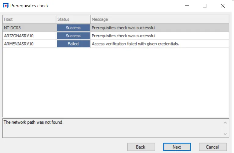

Deploy Agents wizard – Prerequisites Check page
Step 6 – On the Prerequisites Check window, the credentials provided on the Set Options window either succeed or fail during a prerequisites or verification check. It also initiates a prerequisite check for the Agent. See the Prerequisites Check Window topic for additional information.
