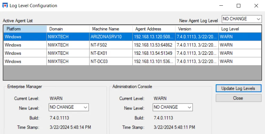

Log Level Configuration Window
The Log Level Configuration window displays the current log levels for the Agents, Enterprise Manager, and Administration Console. You can set new log levels from this window.
Since Threat Prevention supports multiple instances of the Administration Console, each instance has its own settings for log levels. Changing the settings affects only the respective console instance. The Enterprise Manager and Agent log settings are global — the most recent changes from any console instance apply.
Step 1 – Click Agents in the left pane to launch the Agents interface. Then click Update Logging Levels on the top bar to launch the Log Level Configuration window.
Step 2 – To update the logging level for an Agent:
  • The Active Agent List data grid lists the active Agents with the following information:
    • Platform – Operating system platform for the machine where the Agent is deployed, for example, Windows
    • Domain – Targeted Active Directory domain
    • Machine Name – Server where the Agent is deployed
    • Agent Address – IP address of the server where the Agent is deployed
    • Version – Agent build version
    • Log Level – The current log level set for the Agent
  • Select an Agent in the data grid and choose a new log level from the New Agent Log Level dropdown menu, then click Update Log Levels to assign the log level to the Agent. Available file log levels are:
    • Debug – Records everything that happens, most verbose level of logging
    • Info – Records information about individual APIs called, in addition to warnings and errors
    • Warn – Records all warnings that occur, in addition to errors
    • Error – Records all errors that occur
    • Fatal – Records only when catastrophic system failures/crashes occur
    No matter what log level is selected, the logs have a maximum cap size of 55 MB. When a log file reaches 50 MB, it is closed and a new file is started. No more than ten closed files (50 MB) are kept. When the eleventh file reaches 50 MB, the oldest closed file is overwritten.
Step 3 – To update the logging level for Enterprise Manager and the Administration Console:
  • Current Level – The current log level set for the Enterprise Manager / Administration Console
  • New Level – Use the dropdown menu to select a new log level.Then click Update Log Levels to assign the new log level to the Enterprise Manager / Administration Console.
  • Build – The build of the Enterprise Manager / Administration Console. The builds may differ in rare scenarios.
  • Time Stamp – The date and time when the Enterprise Manager / Administration Console build was last updated
Step 4 – Click Close to close the window.

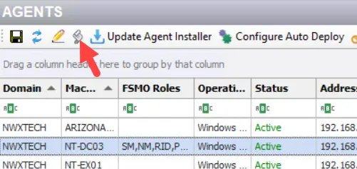

Step 1 – Click Agents in the left pane to launch the Agents interface. Select a server/Agent and click Get Agent Log.

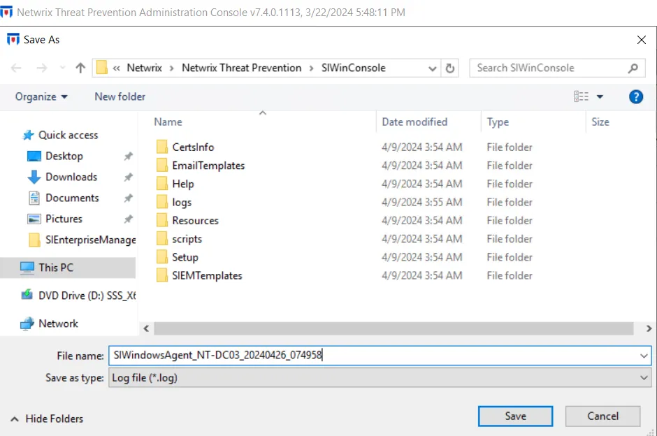

Save As window for Agent logs
Step 2 – The Save As window opens with the selected Agent’s log already selected from its original location. Select the new location and click Save.
You can now view a copy of the log file without navigating to its location on the machine where the Agent is deployed.

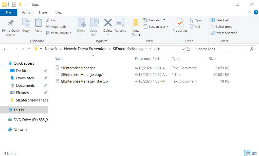

The Enterprise Manager log files are stored on the Threat Prevention server while the Administration Console log files are stored on the machine where the respective console is installed.
Log files are stored in the following locations:
Enterprise Manager Log Files
Enterprise Manager Log File Location
The default location is:
*…\Netwrix\Netwrix Threat Prevention\SIEnterpriseManager\logs*

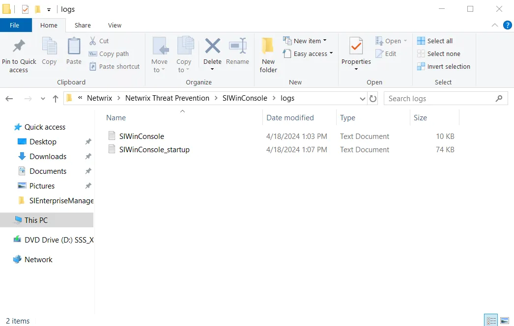

Administration Console Log Files
Administration Console Log File Location
*…\Netwrix\Netwrix Threat Prevention\SIWinConsole\logs*
Log files for a remote instance of the Administration Console are available at the same location on the respective machine.
