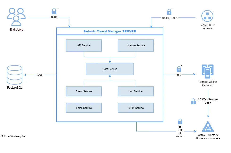

Ports Requirements
The following figure shows Netwrix Threat Manager architecture and component interactions.
Configure appropriate firewall rules to allow these connections.

Threat Manager requires the default dynamic port range specified by Microsoft (49152 through 65535) for Windows Server client/server operations. If a firewall or other appliance is blocking these ports, this server will no longer properly respond to client requests and no longer support standard IP Stack operations that are required for the operation of this product.
