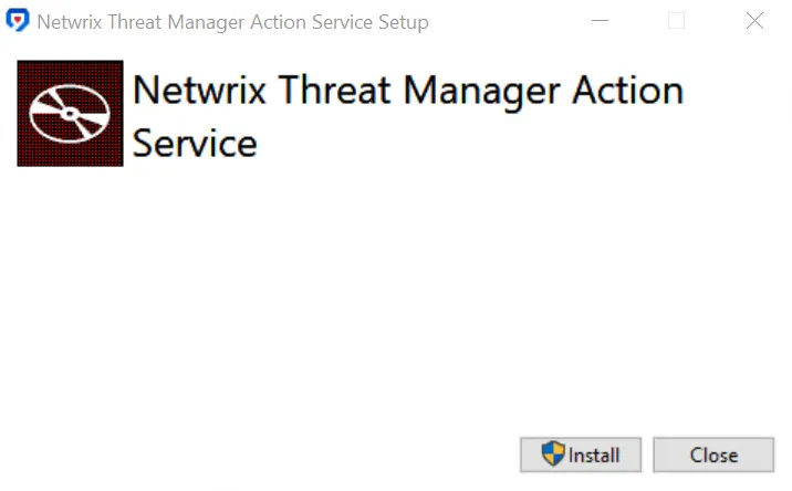

Step 1 – Run the StealthDEFEND.ActionService MSI installation package and the Threat Manager Action Service Setup wizard will open.

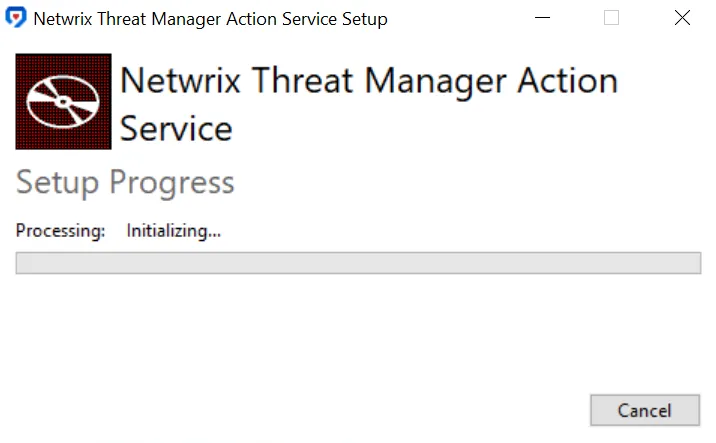

Step 2 – Click Install to begin the installation. The setup wizard displays installation progress.

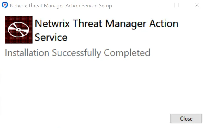

Step 3 – When the installation is complete, click Close to exit the installer.
The Threat Manager action service is now installed on a remote server.

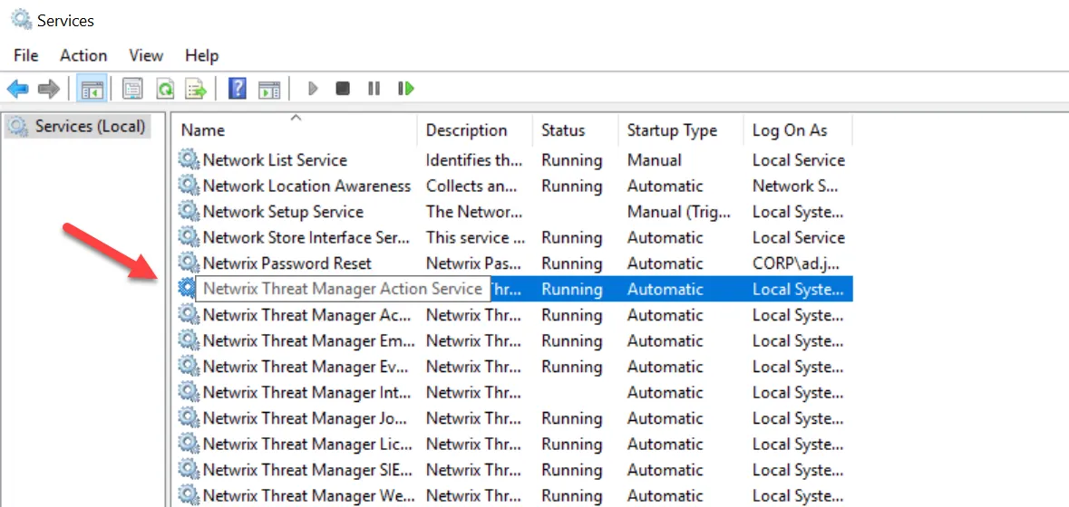

Step 1 – Open Services (services.msc).

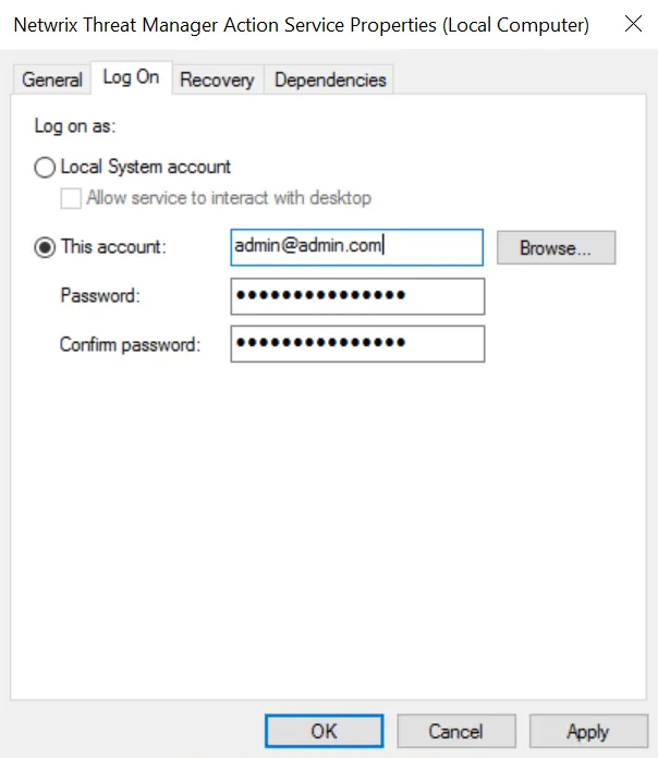

Step 2 – Double-click on the Netwrix Threat Manager Action Service. The Threat Manager Action Service Properties window opens.
Step 3 – Click the Log On tab.
Step 4 – Select the This account: radio button and specify the desired Active Directory account and credentials. If desired, select the Browse button to open the Select User window to select an account.
Step 5 – Click Apply and then OK. This sets the Action Service to “run as” the specified account.

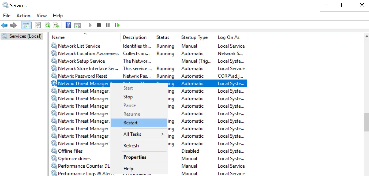

Step 6 – Restart the Threat Manager Action Service by right-clicking on the Netwrix Threat Manager Action Service in the Services window and clicking Restart.
Once restarted, the Threat Manager Action Service will use the specified service account.
