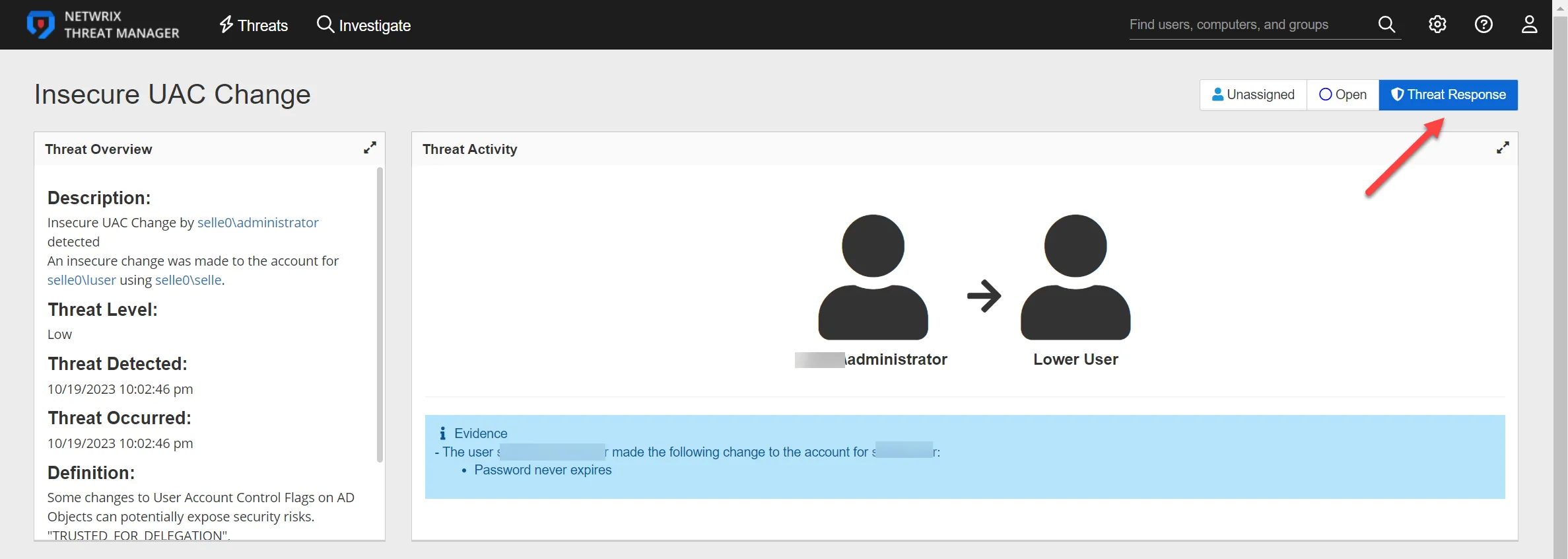

If a playbook is configured to be allowed for a threat, a Threat Response button will be shown on the allowed threat.
Follow the steps to trigger a playbook manually.
Step 1 – Navigate to the Threat Details Page for a user with a threat type associated with a playbook.
Step 2 – Click the Threat Responsebutton. The Threat Response window opens. The window provides the ability to respond to the threat by selecting a playbook from the drop-down list. The window also provides a description of the playbook, the status, and the timestamp for when the playbook was last executed.
