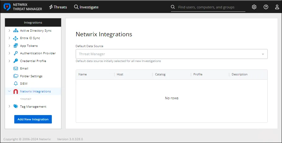

Netwrix Integrations Page
The Netwrix Integrations page within the Integrations interface lists the products for which the application is configured to connect.
Integrations with other Netwrix products enables you to run Investigations on the event data within the connected database. When you add a Netwrixintegration, the selection for Default Data Source identifies which database is the default source for Investigation reports. You can change it by selecting a different database from the drop-down menu. The table provides the following information:
- Name – The name of the integration, as supplied when it was added
- Host – The name of the database host
- Catalog – The name of the database
- Profile – The Name of the Credential Profile assigned to the integration
- Description – Integration description, as supplied when it was added
To view integration details or make modifications, select an integration from the list or under Netwrix Integrations in the navigation pane.

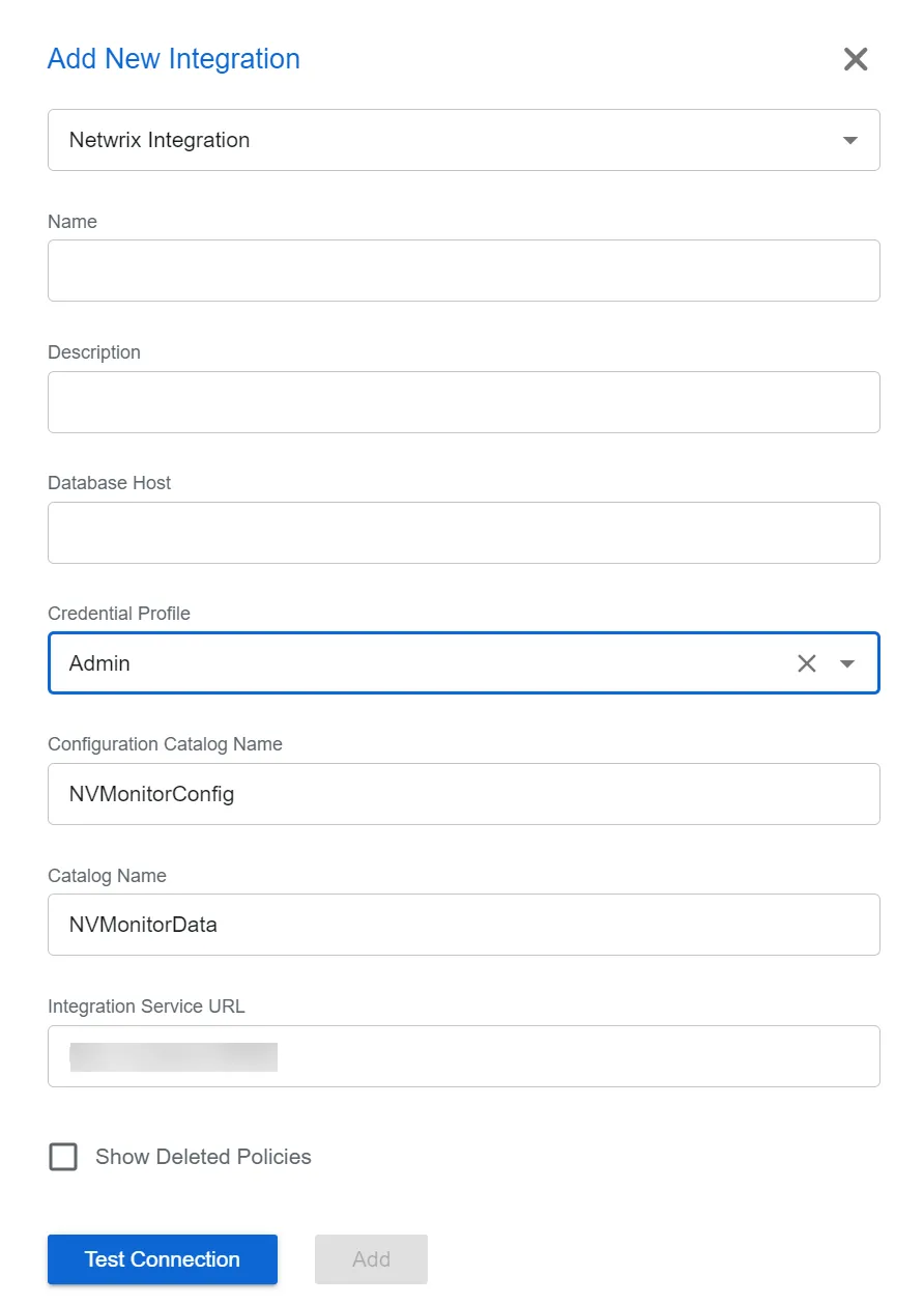

Step 1 – On the Integrations interface, click Add New Integration in the navigation pane. The Add New Integration window opens.
Step 2 – In the Type drop-down list, select Netwrix Integration.
Step 3 – Enter the following information:
Name – Provide a unique, descriptive name of the integration
Description – Provide an Integration description
Database Host – Enter the database server hostname (NetBIOS name, FQDN, or IP address) with the instance name or non-standard port, if applicable, in one of the following formats:
- No named instance, use
[SQLHostName], for exampleNT-SQL02 - Named instance, use
[SQLHostName]\[SQLInstanceName], for exampleNT-SQL02\Netwrix - No named instance with non-standard port, use
[SQLHostName],[PortNumber], for exampleNT-SQL02,72 - Named instance with non-standard port, use
[SQLHostName]\[SQLInstanceName],[PortNumber], for exampleNT-SQL02\Netwrix,72
Credential Profile – Select the Credential Profile by name from the drop-down menu. This was pre-created in the Credential Profiles page.
Configuration Catalog Name – Enter the name of the configuration database. By default, this is set to the name of the Threat Prevention database,
NVMonitorConfig. -
Catalog Name – Enter the name of the database. By default, this is set to the name of the Threat Prevention database,
NVMonitorData. -
Integration Service URL – This should not be modified. It is the URL for the service endpoint, by default
http://localhost:55558. -
Show Deleted Policies – When this option is checked, deleted policies will show on the Policy Sync tab of this Netwrix integration.
Step 4 – Click Test Connection to ensure connection to the database. This will take a moment. Then a message will appear in the upper right corner of the console indicating a successful or failed connection. If successful, move on to the next step. If failed, recheck your entries for error and repeat this step until a successful connection is established.
Step 5 – Click Add. The Add New Integration window closes.
The NetwrixIntegration is listed in the Integrations navigation pane.

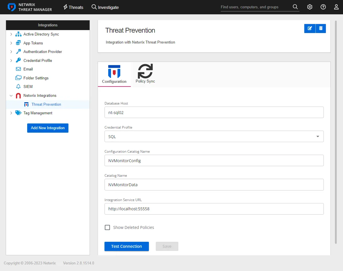

Step 6 – Use the gear icon in the upper right corner of the console to open the Configuration menu. Then select Integrations to open the Integrations interface.
Step 7 – On the Integrations interface, click Netwrix Integrations in the navigation pane to view a list of the already integrated Netwrix products.
Step 8 – Select a product from the table or the navigation pane to view the integration details.
Select the integration from the list to see the details and modification options:
Name and Description – The box at the top displays the name and description of the integration
- Edit – The edit button in the upper right corner of the box changes those fields from read-only to editable. See the Edit Integration Name and Description topic for additional information.
- Delete – The delete button in the upper right corner of the box opens the Delete Stealthbits Integration window to confirm the action
Configuration – Displays the settings entered for the selected integration. These settings can be modified on this tab. See the Configuration Tab topic for additional information.
Policy Sync – Displays information on the last policy sync executed. See the Policy Sync Tab topic for additional information.

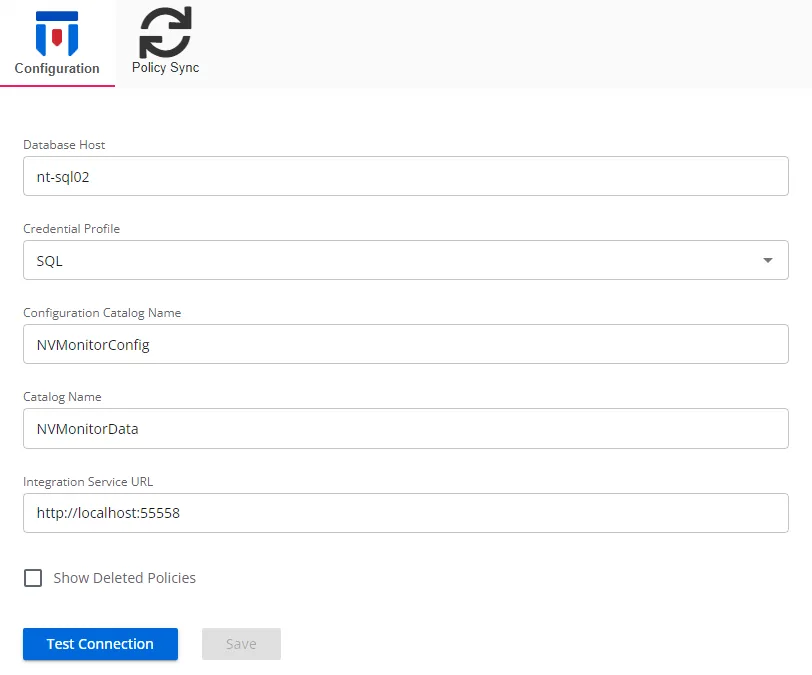

Configuration Tab
The Configuration tab displays the settings entered for the selected integration.
The tab provides the following settings:
- Database Host – Displays the name of the database host in the supplied format
- Credential Profile – Displays the Credential Profile by name
- Configuration Catalog Name – Displays the name of the configuration database .
- Catalog Name – Displays the name of the database
- Integration Service URL – Displays the URL for the service endpoint. This should not be modified.
- Show Deleted Policies – When this option is checked, deleted policies will show on the Policy Sync tab of this Netwrix integration.
- Test Connection – Click Test Connection to ensure connection to the database. This will take a moment. Then a message will appear in the upper right corner of the console indicating a successful or failed connection.
The Save button is enabled when any settings are modified. Click it to commit the changes before leaving the page.
