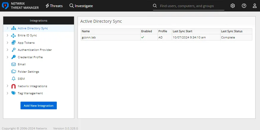

Click Active Directory Sync in the navigation pane to view a list of the already added Active Directory domains, if any. Each added domain represents a sync policy.
A service named Active Directory Service continuously runs to collect data for the specified domain(s). It evaluates the USN value of an object and syncs when the object changes. The table provides the following information:
Name – Name of the domain. This may be either the domain DNS name or domain controller hostname.
Enabled – icon indicates the enabled state:
- Checkmark icon – Enabled
- X icon – Disabled
Profile – Name of the Credential Profile assigned to the policy. As mentioned earlier, each added domain represents a sync policy.
Last Sync Start – Date timestamp when the task started for the most recent sync
Last Sync Status – Event status for the most recent sync task
To view policy details or make modifications, select a domain from the table or under Active Directory Sync in the navigation pane.

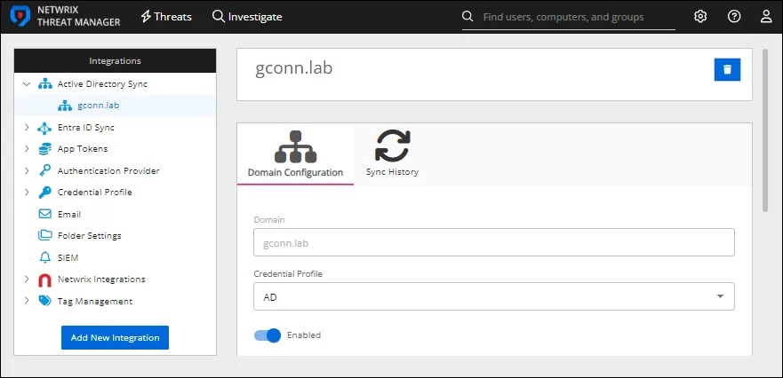

Active Directory Sync Policy Details
Follow the steps to view the details of an Active Directory sync policy.
Step 7 – Use the gear icon in the upper right corner of the console to open the Configuration menu. Then select Integrations to open the Integrations interface.
Step 8 – On the Integrations interface, click Active Directory Sync in the navigation pane to view a list of the already created Active Directory Sync policies, if any. A policy is represented by the domain for which it is created.
Step 9 – Select a domain from the table or the navigation pane to view the details of the Active Directory Sync policy created for that domain.
Select the domain from the list to see modification options:
Name – The box at the top displays the name of the domain
- Delete – The delete button in the upper right corner of the box opens the Delete Domain window to confirm the action
Domain Configuration – Displays the sync policy settings entered for the selected domain. These settings can be modified on this tab. See the Domain Configuration Tab topic for additional information.
Sync History – Displays the information on each synchronization event. See the Sync History Tab topic for additional information.

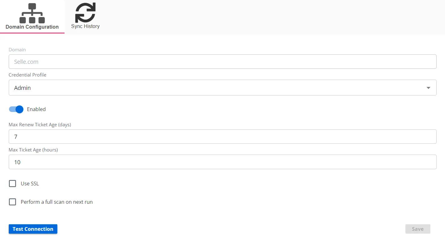

The Domain Configuration tab displays the sync policy settings entered for the selected domain. With the exception of the domain itself, these settings can be updated as needed.
The Domain Configuration tab displays the following settings:
Domain – Displays the domain DNS name or domain controller hostname in the required format of [DOMAIN.COM], e.g. NT-DC03.NWXTech.com
Credential Profile – Displays the Credential Profile by name
Enabled / Disabled – Toggle indicates if the policy is enabled to run the sync service
Max Renew Ticket Age (days) – Displays the value indicates the maximum number of days of the Renew Ticket Age for the domain. This value must match the domain configuration. See the Microsoft Max-Renew-Age attribute article for additional information.
noteThis value is required to accurately evaluate the Golden Ticket threat.
Max Ticket Age (hours) – Displays the value indicates the maximum number of hours of the Ticket Age for the domain. This value must match the domain configuration. See the Microsoft Max-Ticket-Age attribute article for additional information.
Use SSL – Indicates whether you have enabled SSL for secure communication with the domain. See the Microsoft 5.1.1.2 Using SSL/TLS article for additional information.
Perform a full scan on next run – Indicates whether the next sync will only look for domain changes or run a full scan of the domain. By default, this option is enabled for the first sync executed when a new domain is added; however, it is disabled automatically after the first sync. This can be used to fully refresh domain information, but is typically not needed for normal operation.
Test Connection – Click Test Connection to ensure connection to the domain. This will take a moment. Then a message will appear in the upper right corner of the console indicating a successful or failed connection.
The Save button is enabled when any settings are modified. Click it to commit the changes before leaving the page.

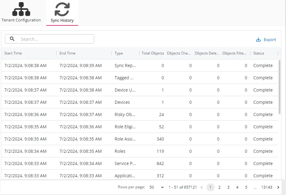

Sync History Tab
The Sync History tab displays the information on each synchronization event. This includes general information about user, group, and computer objects within the selected domain.
- Start Time – Date timestamp when the task started
- End Time – Date timestamp when the task completed
- Users – Number of user objects in the domain
- Users Changed – Number of user objects with changes detected since the last sync
- Groups – Number of group objects in the domain
- Groups Changed – Number of group objects with changes detected since the last sync
- Computers – Number of computer objects in the domain
- Computers Changed – Number of computer objects with changes detected since the last sync
- Status – Event status for the sync task
The table is designed to display 10 records at a time, by default. However, you can set this to 50, 100, or 1,000 rows with the drop-down menu above the right corner of the table. There is a search box above the left corner of the table. Page navigation buttons are below the table. You can also export the data from the current page using the Export CSV button.
Modify Active Directory Sync Policy
Follow the steps to modify the Active Directory Sync policy for the selected Active Directory domain.
Step 1 – On the Integrations interface, click Active Directory Sync in the navigation pane to view a list of the already created Active Directory Sync policies, if any. A policy is represented by the domain for which it is created.
Step 2 – The Domain Configuration tab opens, where you can make the desired modification.
Remember, the domain cannot be modified.
Step 3 – To modify the Credential Profile, select the Credential Profile by name from the drop-down menu. This was pre-created in the Credential Profiles page.
If you modify the Credential Profile for a domain, click Test Connection to ensure connection to the domain. This will take a moment. Then a message will appear in the upper right corner of the console indicating a successful or failed connection.
Step 4 – Click the toggle to change the Enabled/Disabled state of the policy.
Step 5 – For the Max Renew Ticket Age (days) value, modify the value by typing in the textbox.
Step 6 – For the Max Ticket Age (hours) value, modify the value by typing in the textbox.
Step 7 – Select or deselect the Use SSL box for the desired security state for communication with the domain.
Step 8 – Select the Perform a full scan on next run checkbox to force the next sync to run a full scan of the domain.
Step 9 – The Save button is enabled when any settings are modified. Click it to commit the changes before leaving the page.
The changes to the Domain Configuration have been saved.
