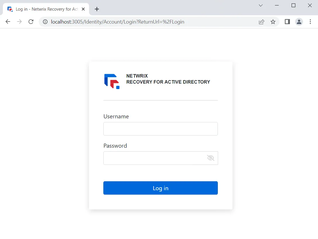

Step 1 – Launch the Recovery Console. The Log in page is displayed.
Step 2 – Log in with credentials configured on the Administrator Role page of the Recovery for Active Directory Setup wizard during installation. See the Install the Application topic for additional information on the administrator role. The username must be entered in the following format:
- Domain\Username
Step 3 – Click Log in.
