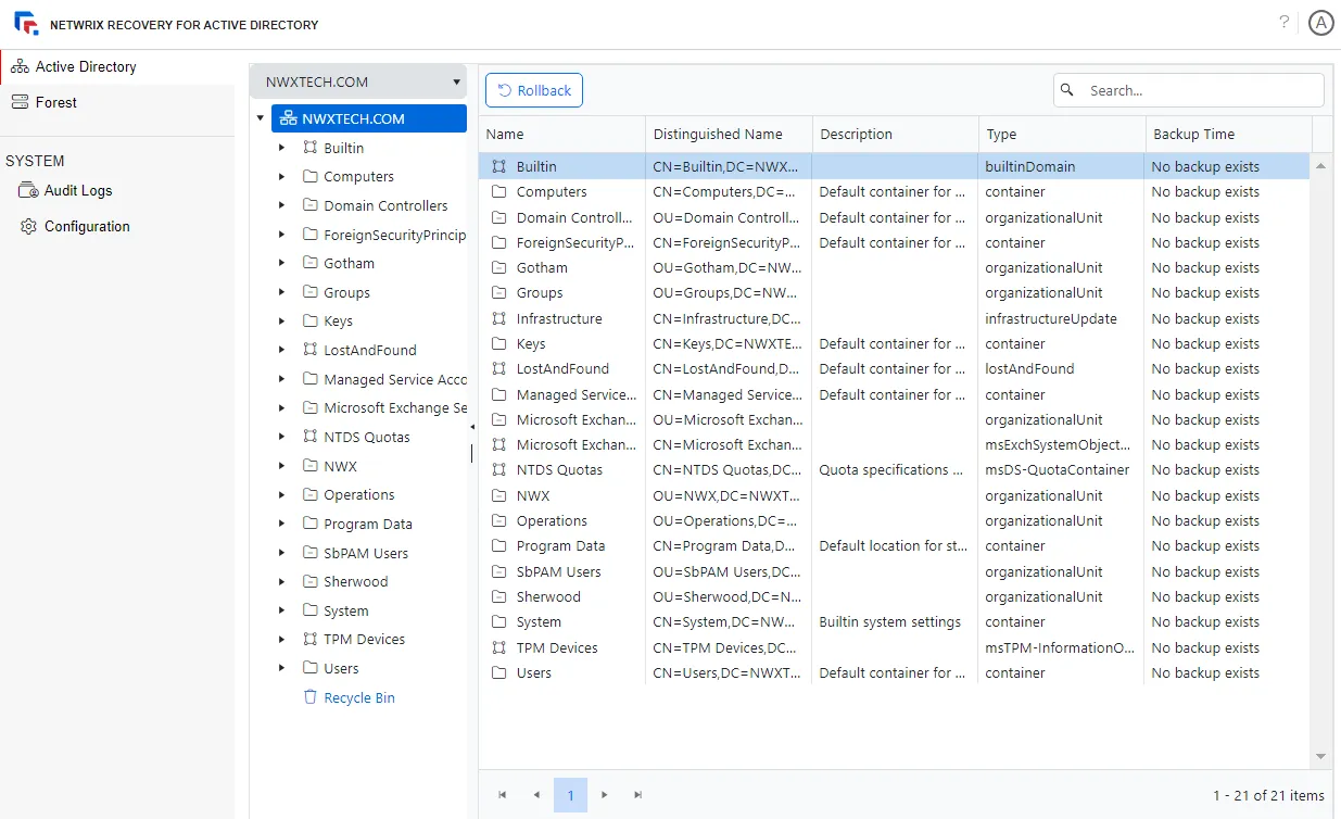

Click Active Directory in the left pane to open the Active Directory page.
Select a domain from the drop-down menu and expand it to view the domain tree and container structure, which is exactly the same as you get in Active Directory Users and Computers. Objects in the domain are also available in the same hierarchical structure.
The page displays the following information:
- Name – The display name of the object
- Distinguished Name – The unique name identifying the object in the directory
- Description – A description of the object
- Type – The object type, showing whether it is a container, organizational unit, computer, group, user, etc.
- Backup Time – The date and time of the last the backup
You can perform the rollback and recover operations for objects.

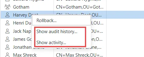

Integration with Threat Prevention
When you right-click an object in a domain on the Active Directory page, the right-click menu is displayed as:
The Show audit history and Show activity options are enabled only when both the following conditions are met:
- Threat Prevention data is tied with Recovery for Active Directory data
- The user is logged in with an account that is specified in the Account section of the Netwrix Integrations Page
These options display data from Threat Prevention.

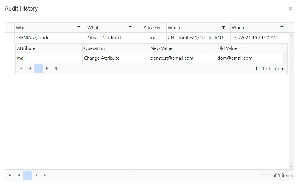

View the Audit History for an Object
You can view the changes made to an object by other users.
On the Active Directory page, select and expand a domain in the left pane and locate the object you want to view the audit history for. Right-click this object and select Show audit history on the menu. The Audit History window is displayed.
The following information is displayed for every action performed on the object:
- Who – The user who performed the action
- What – The action performed
- Success – Shows whether the action was successfully performed; True indicates success and False indicates failure
- Where – The object the action was performed on
- When – The date and time of the action
To view the details of an action, click the plus sign in the respective row to expand it. Information includes the object attribute that was affected, the type of change made, and the old and new values.

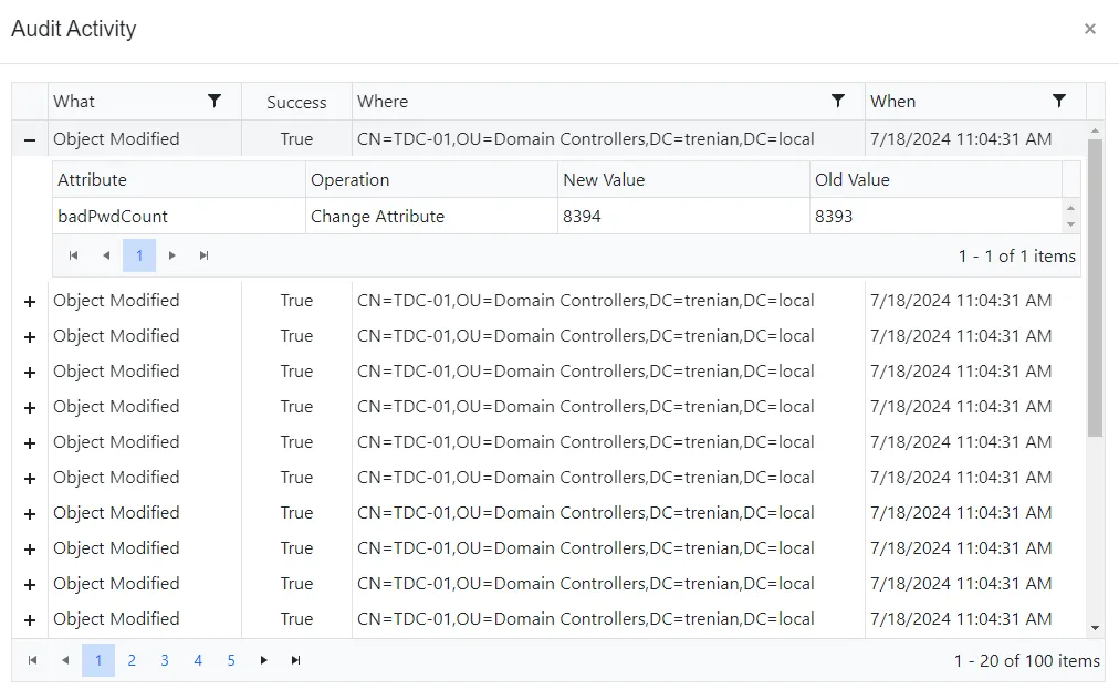

View the Activity Perpetrated by an Object
You can view the activity performed by an object in the environment.
On the Active Directory page, select and expand a domain in the left pane and locate the object whose activity you want to view. Right-click this object and select Show activity on the menu. The Audit Activity window is displayed.
The following information is displayed for the actions performed by the object:
NOTE: For objects in the Recycle Bin, the Show activity option is not available.
