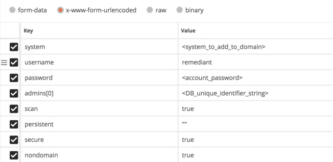

Select the “Body” option beneath the URL field, and create the keys pictured below:
  • system – The name of the Linux system being registered to the Privilege Secure interface.
  • username/password – The name/password of the service account currently on the Linux endpoint which will be used to create the Privilege Secure service account.  Administrative account being added.
  • admin[0] – The DB identifier unique string for the account being added. For additional accounts being added, the [0] will need to be incremented upwards by 1 for each account: [1], [2], [3], etc. It is rare to have more than 2 persistent administrative accounts, but there is reason for more on occasion.
  • scan – Set as ‘true’ by default.
  • persistant – Set as an empty string using the double quotation marks by default.
  • secure – Set to ‘true’ by default.
  • nondomain – Set as ‘true’ by default.
Once all values are in place, click the blue “Send” button in the top right corner, and verify that it updates successfully in Postman. This initial registration process may take up to 30 seconds per machine.
