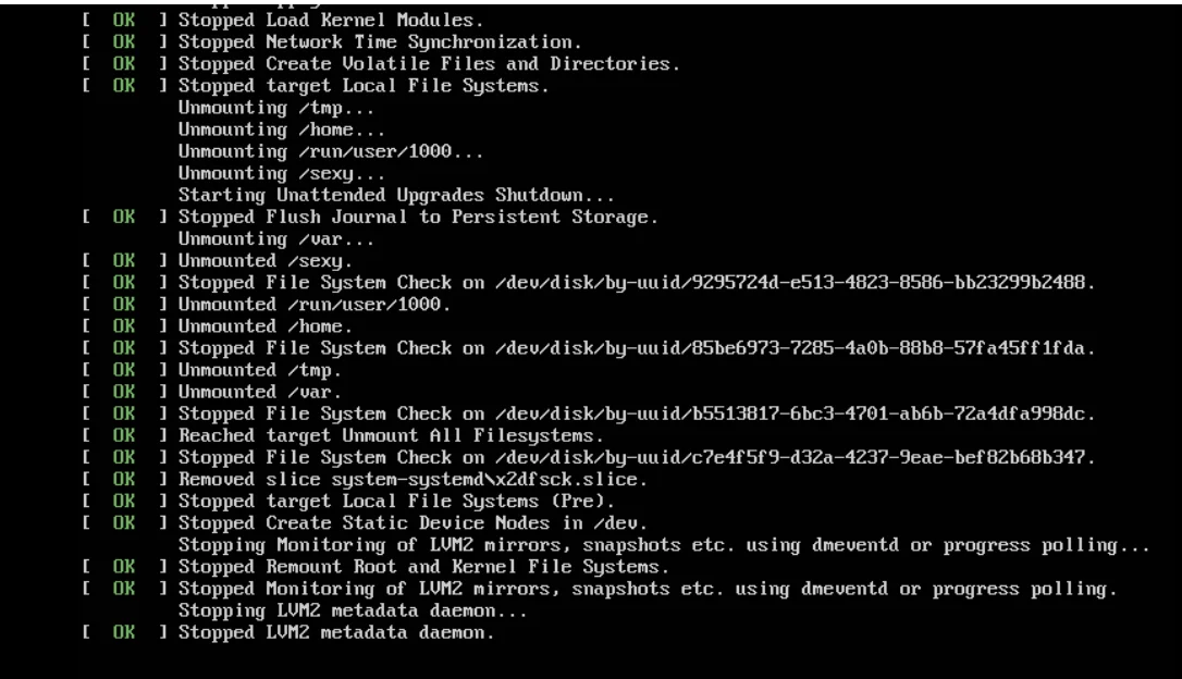

Step 2 – Once the above information is gathered/confirmed, a reboot of a single node can be completed to load the Boot menu. For a non-impactful process to Privilege Secure, this process should be completed on a single node at a time. To reboot the node use the command sudo reboot.

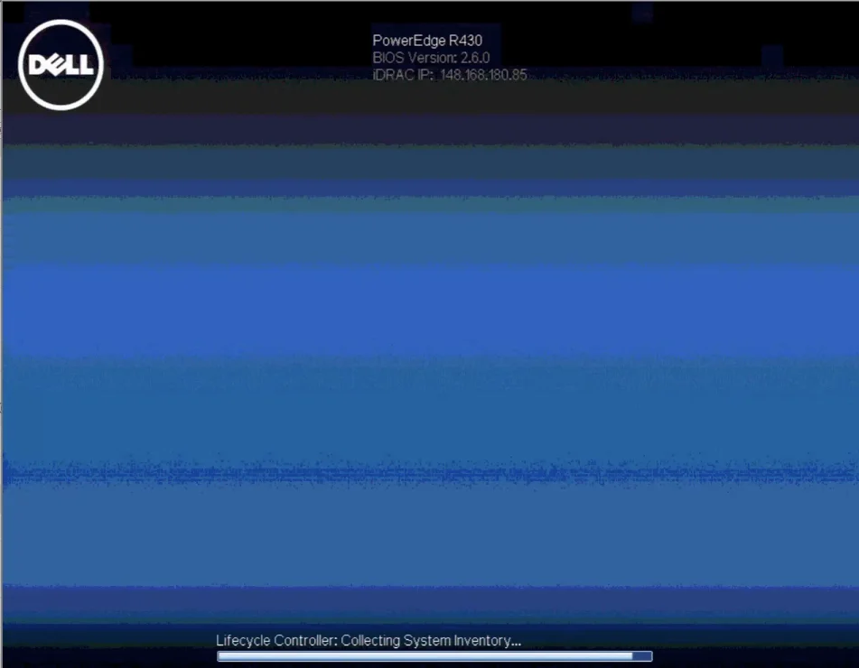

After the reboot command runs, the next screen will either show the “STOPPED” processes and then the “No Signal” screen, or will jump directly to the “No Signal” screen before loading the "Dell" trademarked screen.
After the shutdown is completed, the boot up process will start with the below “Dell” trademarked screen. This screen will show with a “loading bar” at the bottom as it loads the different system configurations.
NOTE: The IP address for the iDrac will likely be different or not display at all in reference to the screenshot below.

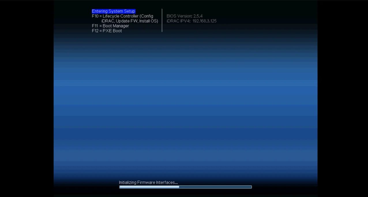

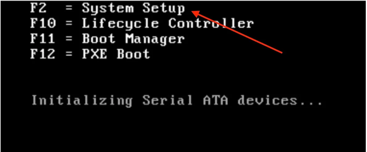

Step 3 – After the above “Dell” screen is cycled through twice, the next screen should show the boot menu with the options below through the “F” keys. At this screen choose the F2 = System Setup option.
The next screen will show the highlighted text below of “Entering System Setup”.

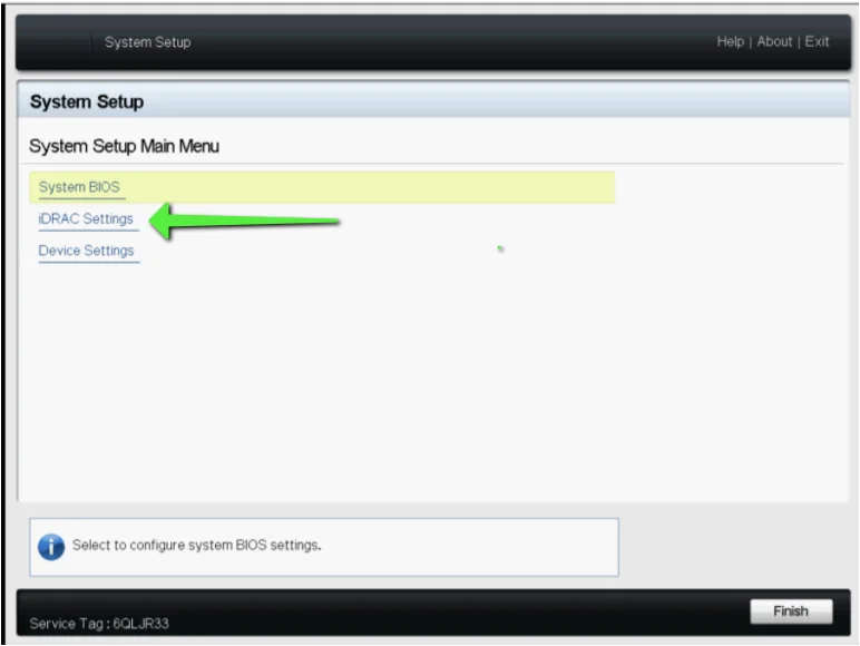

Step 4 – Select the “iDRAC Settings” option on the System Setup page.

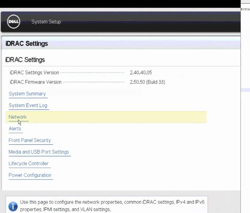

Step 5 – Select “Network” on the iDRAC Settings screen.

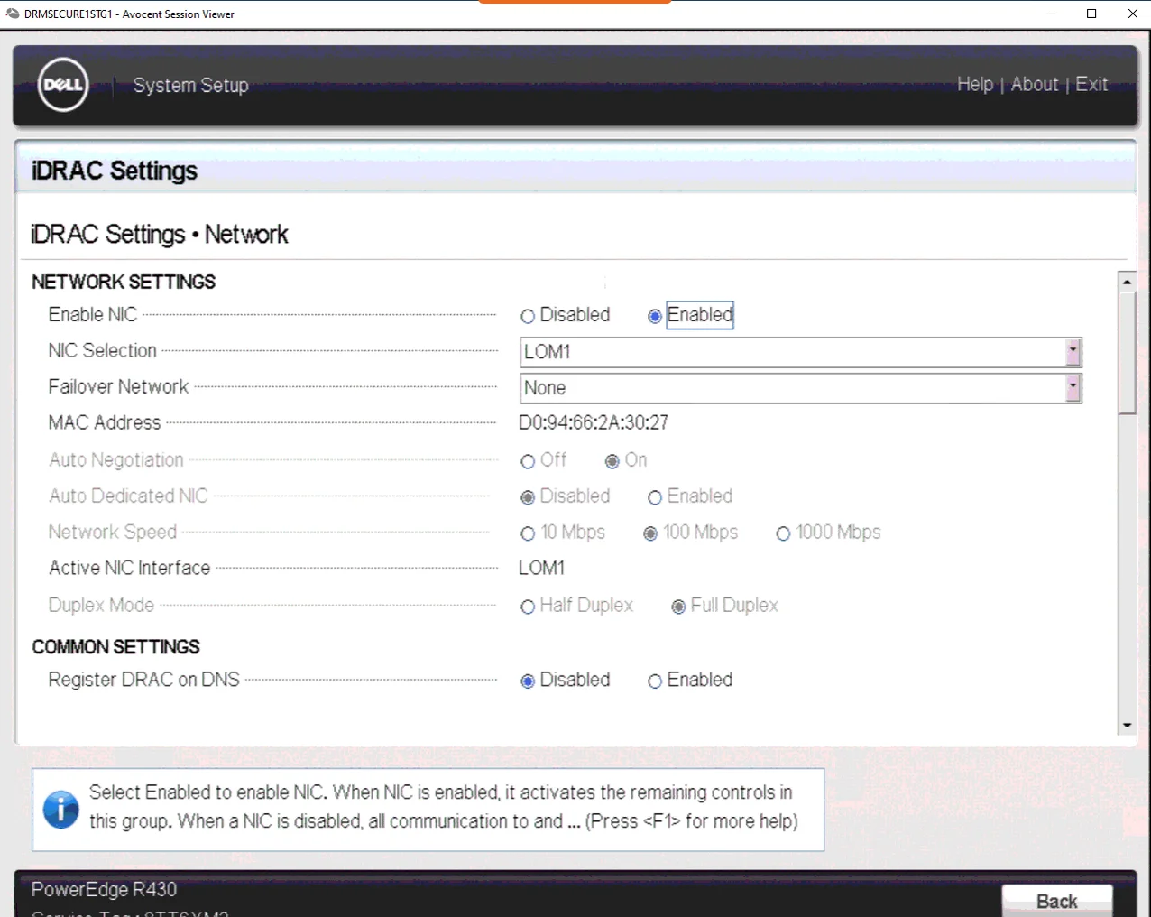

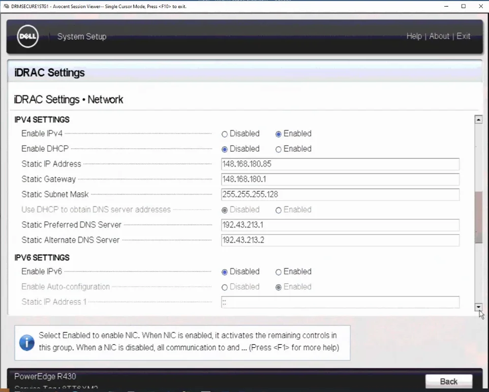

Step 6 – Under the iDRAC Settings > Network page. Here is where the iDRAC NIC selection, static IP address/gateway/subnet mask, and DNS servers will be set for remote iDRAC access through a browser. The NIC selection should be set to LOM1 for the shared NIC port with the hosted OS. Make sure the settings in the screenshots below match. The required settings have been listed above the images in bullets.
  • Enable NIC: Enabled
  • NIC Selection: LOM1
  • Enable IPv4: Enabled
  • Enable DHCP: Disabled
  • Static IP Address: Dedicated and specific to each server.
  • Static Gateway: Dedicated and specific to each server.
  • Static Subnet Mask: Dedicated and specific to each server.
  • Static Preferred DNS Server: Set to the organizations DNS server
  • Static Alternative DNS Server: Set to the organizations DNS server
Step 7 – Once the specific networking details have been enter, click Back, click Finish, and then click Yes. The network information is saved, and the system reboots.
