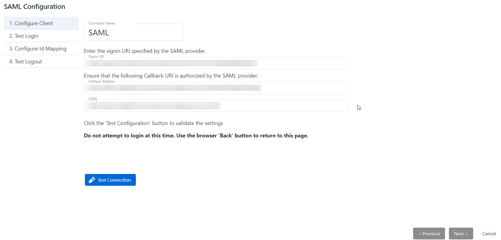

Step 3 – On the Configure Client page, enter the following information:
  • Signin URI– The SAML provider issuer URI. Out-going redirection requires the correct “Issuer” path to be set. Incorrect settings generally results in a 404 error.
  • Callback Address – The SAML provider requires the Privilege Secure callback path to be authorized. Generally this appears by the provider after redirection. Enter the address and port of the Privilege Secure server:
[protocol]//[hostname]:[port]/callback
  • CORS – The SAML provider requires the Privilege Secure callback location to be configured for CORS. This either be displayed by the provider after redirection, or a 500 error is returned. If an error is returned, CORS is probably not configured with the correct information. Enter the address and port of the Privilege Secure server:
In the next step, verify that the Sign In page displays as expected, but don't sign in at this step.
Step 4 – Click Test Connection to verify the connection configuration. This opens the Sign In page in the browser. don't sign in.
  • If the Sign In page doesn't display as expected, review the values configured for the SAML connector and modify them where needed. Then, verify the Sign In page again.
Step 5 – Click the browser’s back arrow to return to the Configure Client wizard page.
Step 6 – If the Sign In page displayed as expected, click Next.
