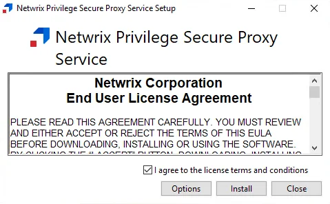

Step 2 – Right-click the installer and select Run as administrator. The Netwrix Privilege Secure Proxy Service Setup wizard opens.
Netwrix Privileged Secure Proxy Service Setup wizard on the EULA page
Step 3 – On the End User License Agreement page, accept the license terms and conditions and click Options.
tip
Remember, it is a best practice to read the agreement before accepting it.
