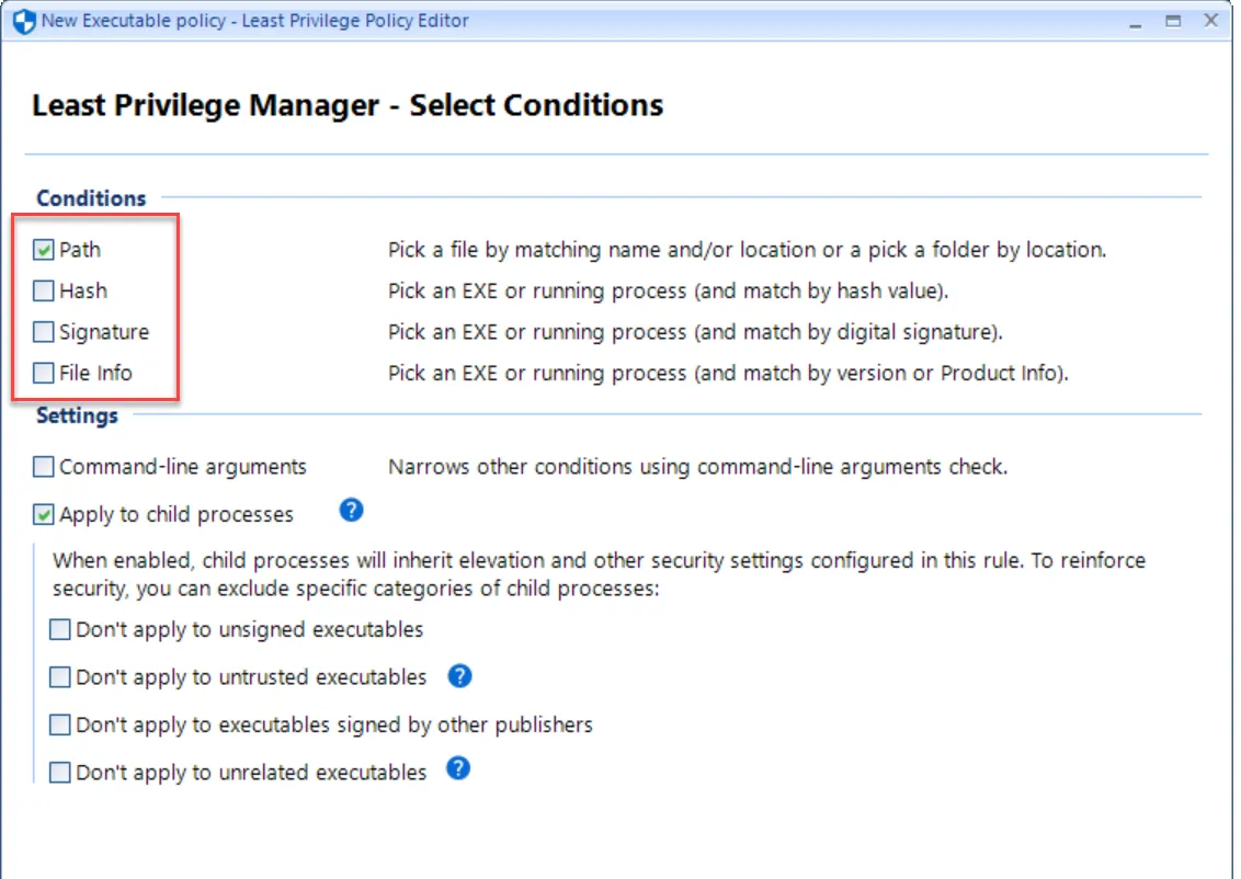

Simple rules often suffice. However, sometimes you need more tuning. In previous examples, PolicyPak Least Privilege Manager UI prompted you to create Combo rules, because it detected a non-Best Practice.
A Simple rule can be any one of these items:
  • Path (name or location)
  • Hash (fingerprint of the file)
  • Signature (digital signature of the file)
  • File info (file attributes)

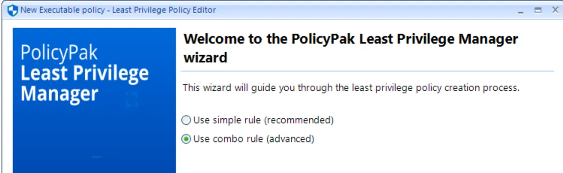

However, you can begin correctly by making your own Combo rules.

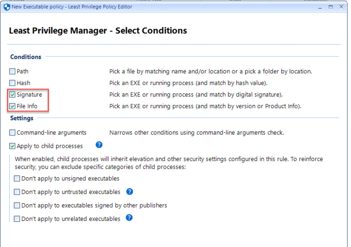

Combo rules are useful in a variety of situations. The most common situation occurs when you want to elevate an application to allow it to run or install. You can do this based on its digital signature and inner product info. You could use all four conditions if you want to make the tightest match possible.
To do this, create a Combo rule and select the two (or more) types of characteristics. Again, the most secure method is Signature and File Info.

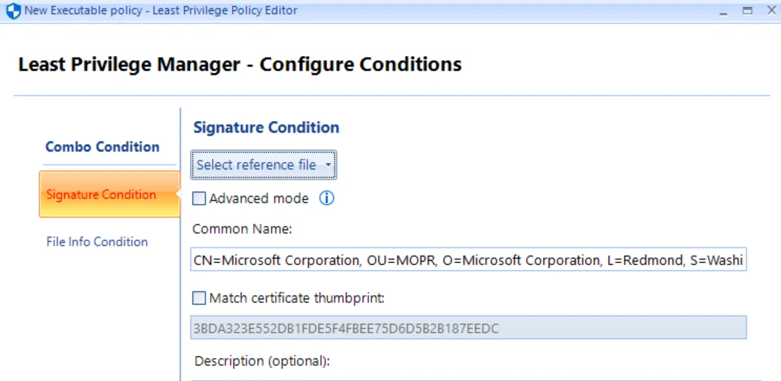

The Combo rule wizard is different from the Simple rule wizard. This combo rule requires two steps to complete. As you can see, a specific file as a reference file for Signature Condition.

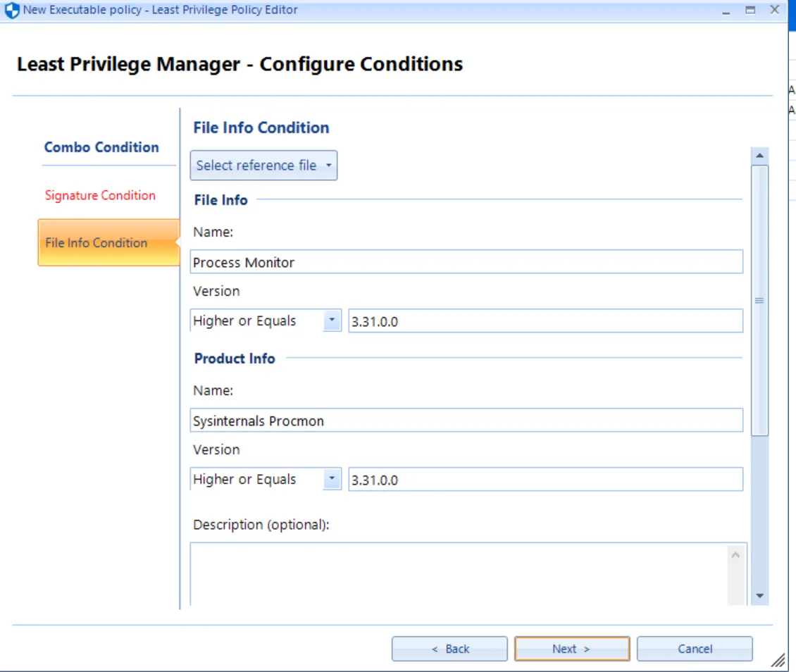

In the next step of the wizard for File Info, select the same file. You could also select a different file, but this isn’t normally done.

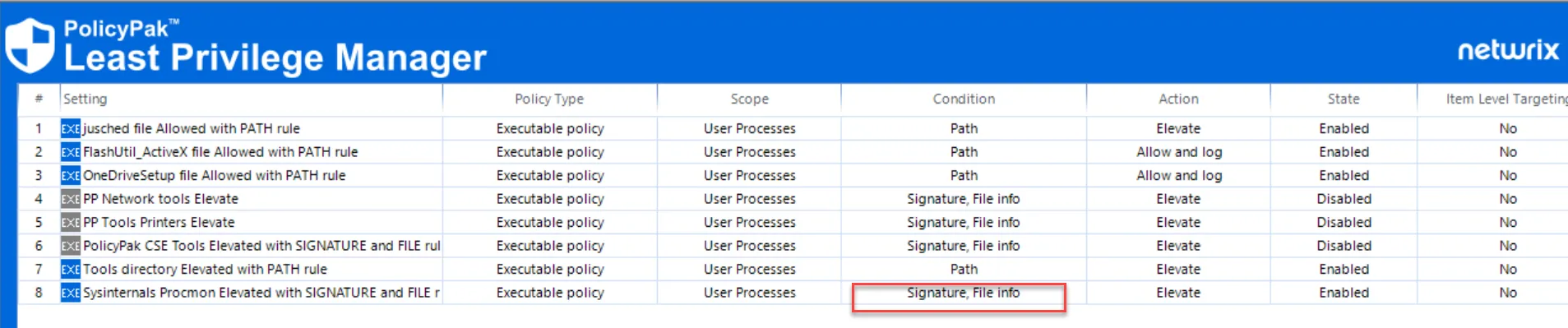

Then choose the same actions as before, such as Run with elevated privileges. When the wizard is complete, the MMC list will demonstrate the multiple conditions in the Condition column with Signature, File Info.
