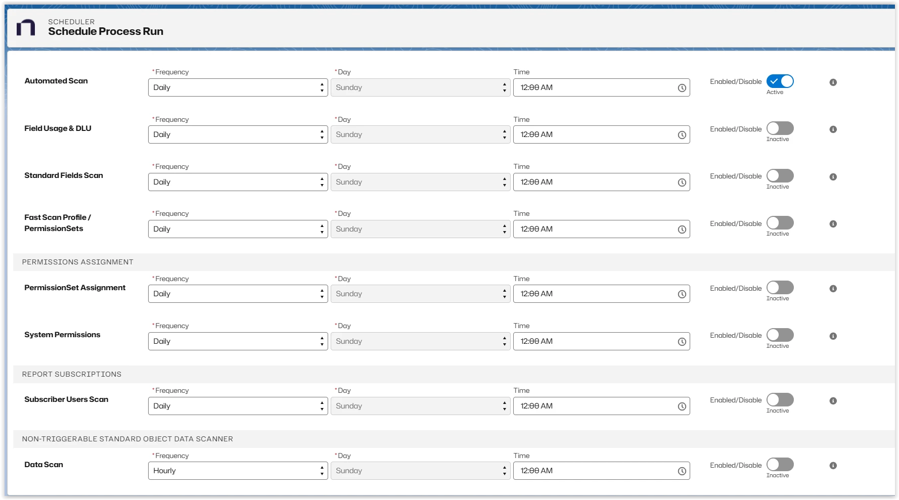

DLU Scheduler
The Scheduler is where you can add frequency, day and time for processes to run. Under Field Usage and DLU, you can set up the scheduler to update the last used date field on customizations with the date the metadata was last used. It populates information for field usage on custom fields and custom objects and catch any permission set assignments related to users.
Once the scheduler has been set up, you can view the DLU under the Metadata tab on the customization record.
