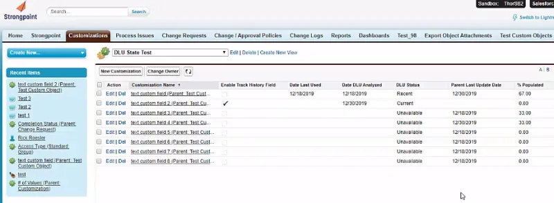

Usage data fields:
- % Populated displays the percentage of Records with the field populated (not blank). Fields with low usage are clean up candidates. For example, if the field appears on 1000 records, but there is only data on 400 of the records, it is 40% populated.
- DLU is now defined to be the last time the field was updated with Field History Tracking enabled. Field History Tracking ensures the DLU is accurate. If Field History Tracking is later disabled, the DLU no longer updates and the data may not be accurate. The new Date DLU Analyzed and DLU Status provide additional insight.
- Date DLU Analyzed displays the last time the scanner was run with Field History Tracking enabled.
- Parent Last Update Date is set to the CreatedDate of the most-recently-created Record with the CustomField populated. This provides usage recency information when Field History Tracking is disabled. CreatedDate is more accurate for the CustomField than the LastModifiedDate for the record.
- DLU Status displays the current status:
| DLU Status | DLU | Field History Tracking | Date DLU Analyzed | Parent Last Update Date | | --- | --- | --- | --- | --- | | Unavailable | Blank | Never enabled for this field. | Blank | Populated | | Pending | Blank | Enabled. Waiting for the scanner to run. | Blank | Populated | | Current | Populated | Enabled. DLU is current and accurate using automated nightly scans. | Today | Blank | | Recent | Populated, May be stale | Disabled. Last scan when enabled was within the past three months. Three months is the default time period. See Setting the DLU Expiration. | Within set time period | Populated | | Expired | Populated, May be stale | Disabled. Last scan when enabled was longer than three months ago. Three months is the default time period. See Setting the DLU Expiration. | Older than set time period | Populated | If Field History Tracking is enabled for a CustomField with a DLU Status of either Recent or Expired, the status is changed to Pending. Here is an example:
Notes
- When Field History Tracking is enabled, the DLU is accurate, and the Parent Last Update Date is blank.
- If Field History Tracking has never been enabled, only Parent Last Update Date has a value. Use Parent Last Update Dateand % Populated together to get a sense of the usage.
- If Field History Tracking was enabled and later disabled, there are values in DLU and Parent Last Update Date. Generally, you would use the most recent of the two together with % Populated to get a sense of usage. If DLU Status is Expired, it is probably safe to ignore DLU.
