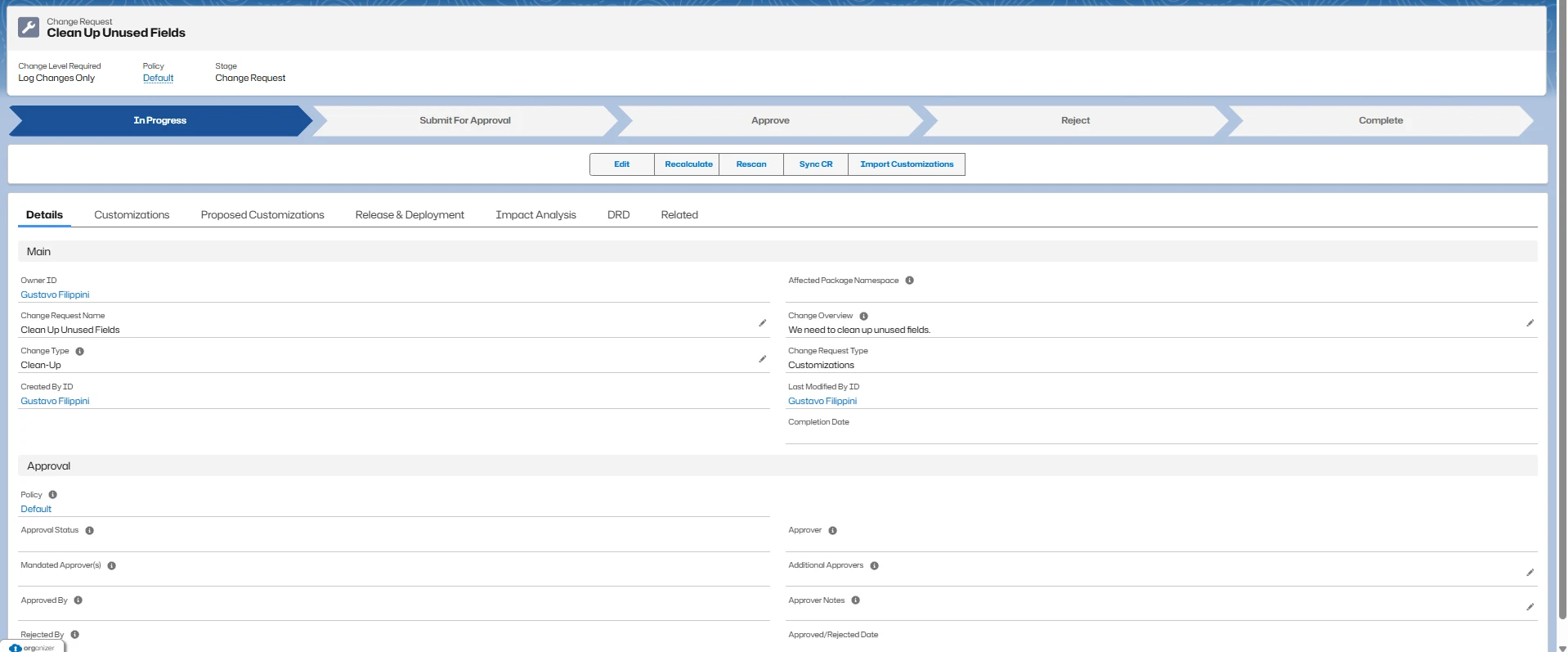

  1. Click the Change Request tab and click New.
  2. Enter the name and a brief description of the clean up project. Set the Change Type to Clean Up. If you are using an external change approval system such as Jira or ServiceNow, you can enter the External Change Request Number.
    Clean Up Unused Fields - Change Request

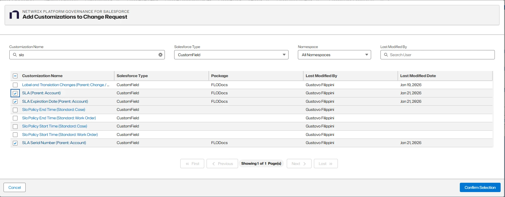

  5. In the Add Customizations to Change Request window:
    • Use Customization Name to search for Customizations.
    • Use Salesforce Type to filter by metadata type (for example, CustomField).
    • Optionally filter by Namespace or Last Modified By.
    • Select one or more Customizations using the checkboxes.
    • Click Confirm Selection to add them to the Change Request.

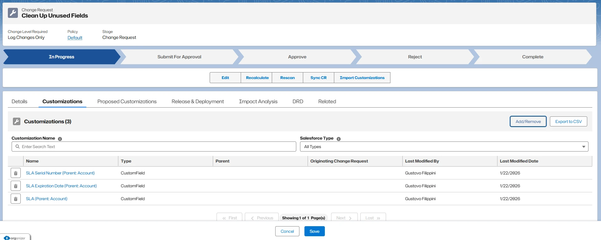

  6. The selected Customizations appear in the Customizations tab of the Change Request. From this view, you can:
    • Review the list of Customizations included in the clean up.
    • Remove Customizations if needed.
    • Export the list using Export to CSV.

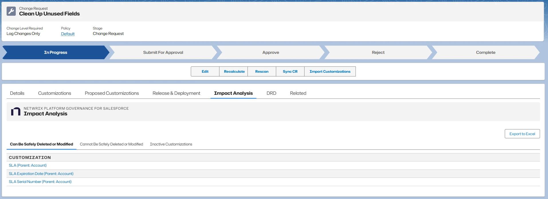

  7. Navigate to the Impact Analysis tab to review the potential impact of cleaning up the selected Customizations.
    Impact Analysis
    Impact Analysis

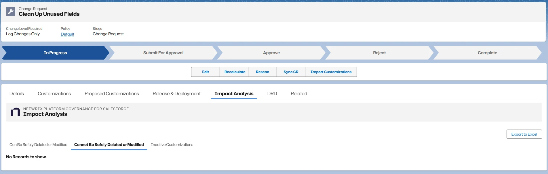

    The Impact Analysis categorizes Customizations into the following sections:
    • Can Be Safely Deleted or Modified
    • Cannot Be Safely Deleted or Modified
    • Inactive Customizations
    This analysis identifies dependencies such as references in reports, scripts, workflows, or other metadata that could be affected by the clean up.
  8. Review the Impact Analysis results carefully. If Customizations appear under Cannot Be Safely Deleted or Modified, further investigation or remediation may be required before proceeding.
