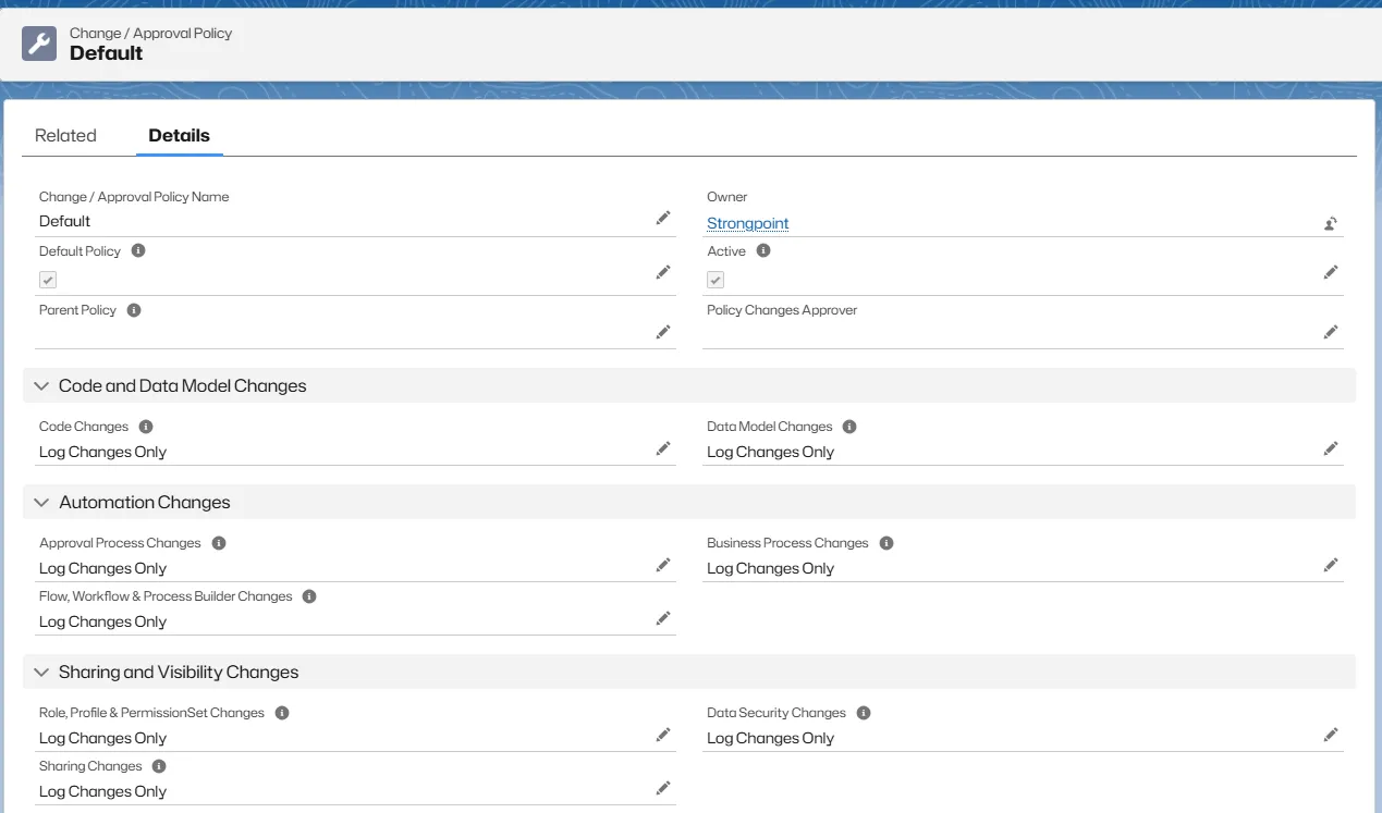

How Change Policies Work: Every time a customization is created or changed in an org, Platform Governance for Salesforce checks to see if the change should have been reviewed or approved. By default, this depends on the dependencies — a picklist with no dependencies is a relatively safe change compared to a picklist with risky code dependencies. Default policies can be customized and applied to specific customizations. For example, most reports do not need change control, but management reports need to be tightly controlled.
Policies define the level of change control to follow to reduce risk. The five change levels contain escalating levels of rigor and/or skill required to address a change:
Change LevelChange ProcessExampleSkill Level Required
L1: Log ChangesThis is a safe change.Ordinary report.Anyone.
L2: Change RequestThis needs approval from management but not sandbox review.Management report or Control.Anyone, provided prior approval is granted.
L3: Sandbox Development and TestingThis is not a complex change, but best practices require it to be tested in a sandbox first.Data model changes with no dependencies. For example, adding a new field.Business Analyst or Admin with prior approval, working in sandbox before deploying in production.
L4: Full Software Development LifecycleThis is not a safe change. It needs to be changed carefully with rigorous testing.Changes to code or a picklist used in field with code or SoQL dependencies.Admin / Developer with prior approval working through a full development cycle in multiple sandboxes.

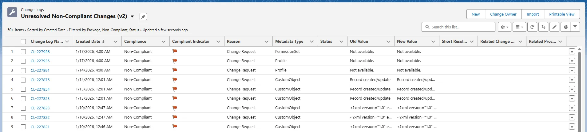

Changes made without the policy-required approval are reported as Non-Compliant. Review the Non-Compliant Changes Report to ensure dangerous changes do not slip through and cause process or data problems.
Policies can also be used to block unauthorized changes.

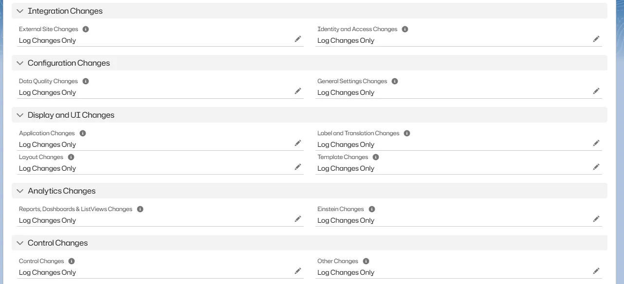

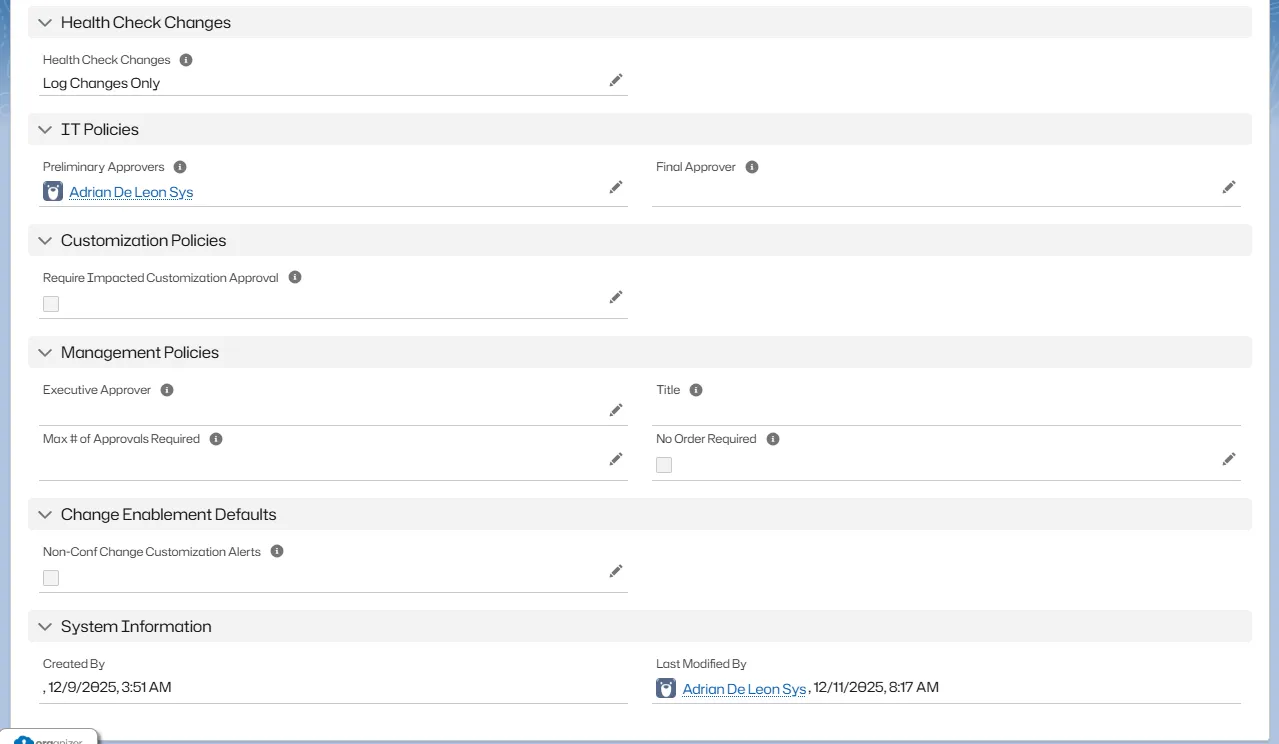

Default Policy
Netwrix recommends our default policy as a foundational best practice. In addition, consider Specific Monitoring for anything needing special protection.
Netwrix Default Policy Netwrix Default Policy Netwrix Default Policy
Platform Governance for Salesforce documents Unresolved Non-Compliant Changes in both a List View and a Report. Both show you all the changes that should have received approval and the level of change control required for the change. The List View enables you to quickly review and manage the resolution from a single screen through the Short Resolution Description and Status fields.
If you are not fully leveraging Platform Governance for Salesforce in your change enablement process, you can restrict your review of changes by filtering out object types or risk levels that do not concern you. Alternatively, you can create different reports for different team members to prioritize what you see.
Unresolved Non-Compliant Changes Report

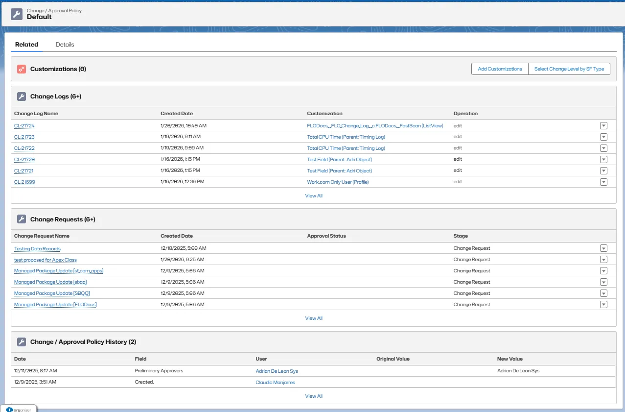

The Related tab on the Policy page provides a consolidated view of all elements associated with a Change / Approval Policy and serves as the main workspace for managing policy scope and tracking its usage.
From this tab, you can:
View Customizations Associated with the Policy
The Customizations section shows which Salesforce customizations are currently governed by the policy.
Add or Manage Customizations
You can associate new customizations with the policy using two actions:
  • Add Customizations: Manually select and assign specific customizations to the policy.
  • Select Change Level By SF Type: Assign the policy automatically to all customizations of selected Salesforce Types (for example, ApexClass, Profile, PermissionSet, CustomObject).
Review Change Logs
The Change Logs section lists all change events related to customizations and/or change requests that are governed by this policy. This provides visibility into what was changed, when it was changed, and the type of operation performed.
Review Change Requests
The Change Requests section displays all change requests that have this policy applied, along with their current approval status and stage.
Track Policy History
The Change / Approval Policy History section records all modifications made to the policy itself, including changes to approvers, settings, and creation details, providing a full audit trail.
Together, these sections make the Related tab the central place to manage policy assignments, understand how a policy is being applied, and audit both customization activity and policy configuration changes.

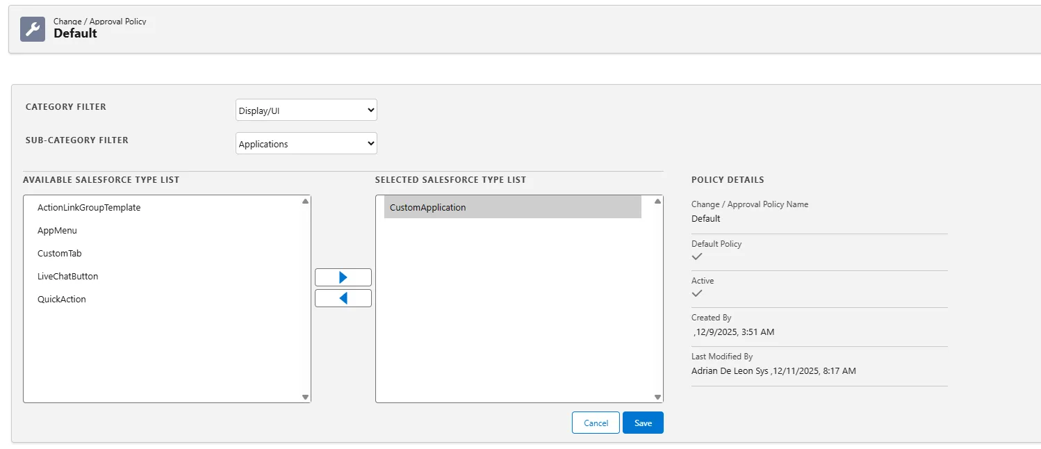

Automatic Policy Assignment
Platform Governance introduces an intelligent policy assignment mechanism for Salesforce customizations. When you define a policy and select specific Salesforce Types (such as Profile, PermissionSet, CustomObject), the system automatically applies this policy to any new customizations that match those types.
How Automatic Policy Assignment Works
There are two primary methods for assigning policies to customizations:
Option 1: Select Change Level By SF Type
To configure Automatic Policy Assignment by Salesforce Type:

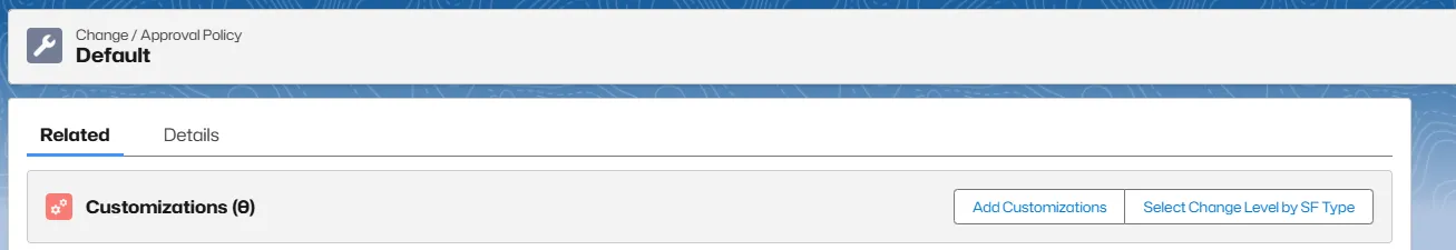

  1. Navigate to the Policy record.
  2. Go to the Related tab in the Customizations panel.
  3. Click the "Select Change Level By SF Type" button.
This method allows you to automatically assign policies to specific Salesforce object types.

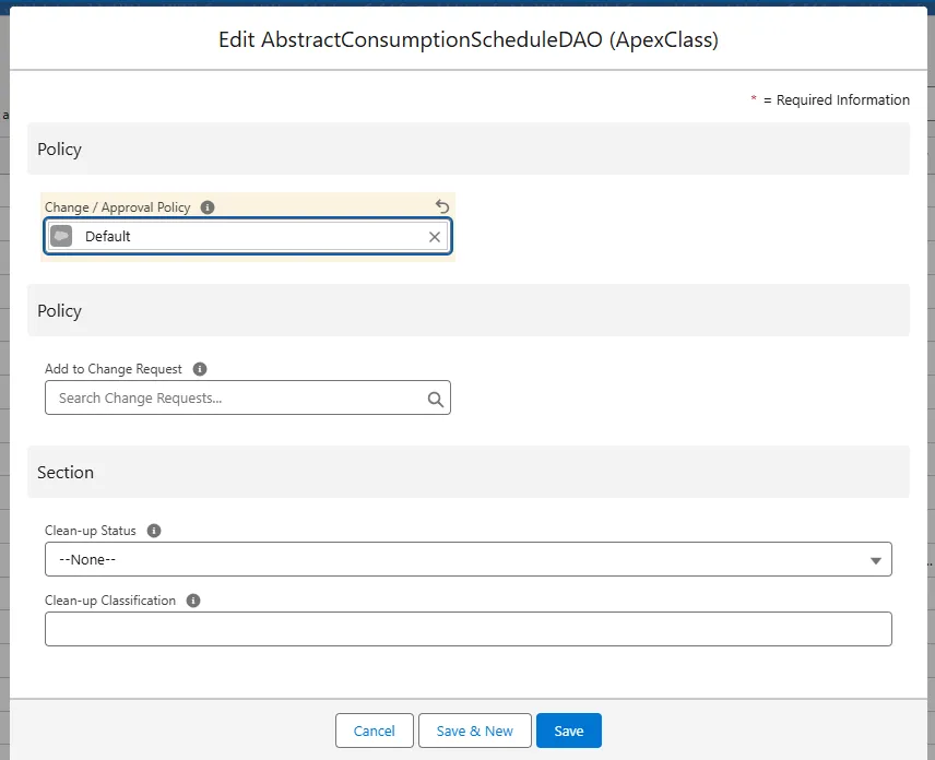

While policies can be automatically applied from the Policy record itself (as described in Automatic Policy Assignment), you can also assign a policy directly from the Customization record for more granular control.

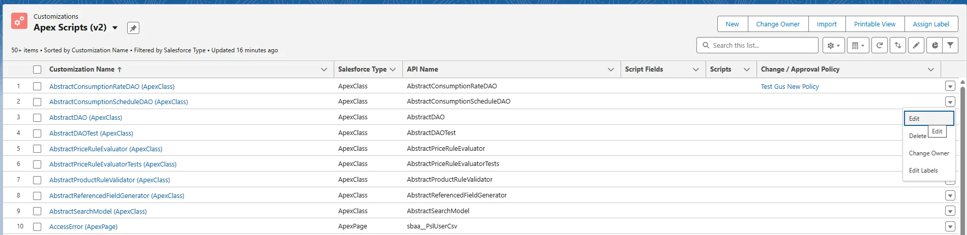

Applying a Policy from a Customization
To associate a Change / Approval Policy with a specific customization:
  1. Navigate to Customizations and open the relevant list view (for example, Apex Scripts, Objects, Fields, or any other Salesforce Type).
  2. Select the customization you want to govern.
  3. Click Edit from the row action menu.
  4. In the Edit Customization dialog:
    • Use the Change / Approval Policy field to search for and assign an existing policy, or create a new one.
    • Optionally, associate the customization with an existing Change Request using the Add to Change Request field.
  5. Click Save to apply the changes.
This method provides fine-grained governance at the individual customization level and complements the automatic assignment mechanisms described in the Automatic Policy Assignment section.

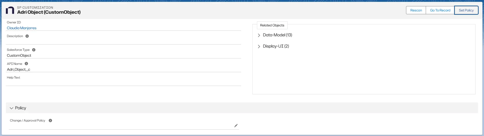

When you add sensitive objects to a policy, you may also need to apply the same policy to the Custom Fields that belong to that object. Platform Governance for Salesforce provides a streamlined Set Policy action directly on the Customization record to support this workflow.
Applying a Policy from a Custom Object
To assign a Change / Approval Policy to a Custom Object and its related fields:
  1. Navigate to Customizations.
  2. Search for and open the CustomObject you want to govern.
  3. On the Customization record, click Set Policy.

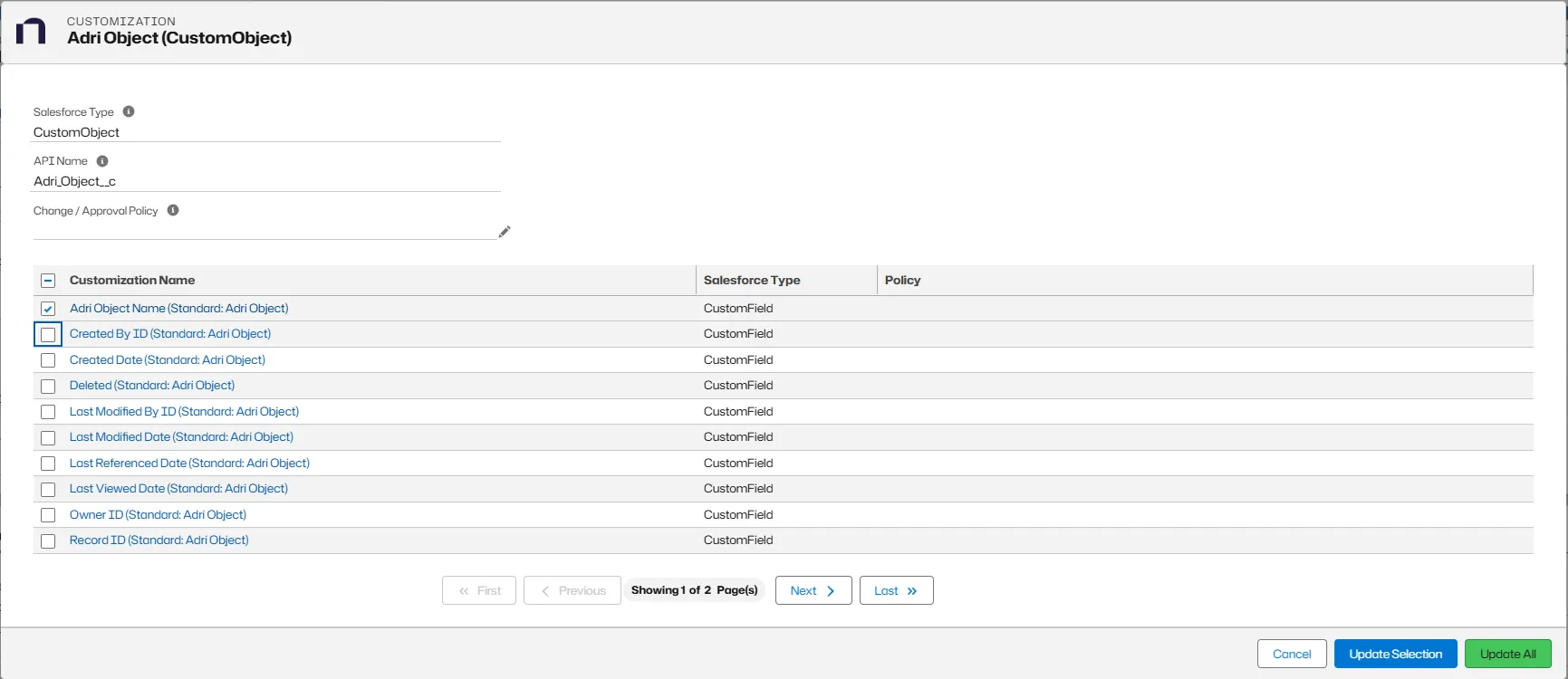

  1. In the Set Policy dialog:
    • Assign the desired Change / Approval Policy to the Custom Object.
    • Review the list of related Custom Fields associated with the object.
  2. Select individual fields, or use the header checkbox to select all fields.
  3. Click:
    • Update Selection to apply the policy only to the selected fields, or
    • Update All to apply the policy to the object and all its fields.
  4. Click Save to complete the assignment.
This approach ensures consistent governance across an object and its underlying fields while allowing flexibility to apply policies only where needed.
