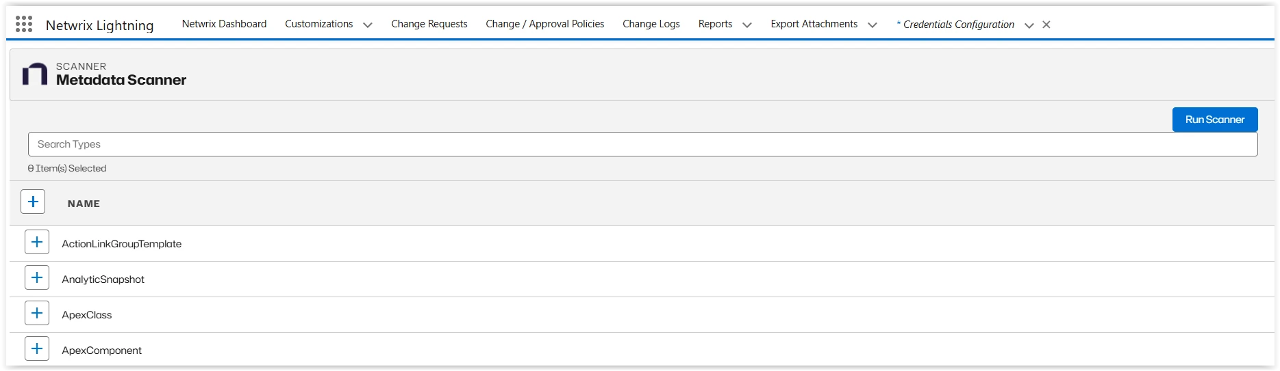

To run the scanner:
  1. Open Netwrix Dashboard > Scanner > Manual Scanners
  2. Use the optional Search Types to narrow the focus of the list if you are looking for a specific type.
  3. You can select + beside one or more types to scan or you can scan the whole environment by clicking + on the Name row to select all the types.
    scanner
  4. Click Run Scanner.
  5. The batch runs in the background. You receive an email notification when the scan is complete.

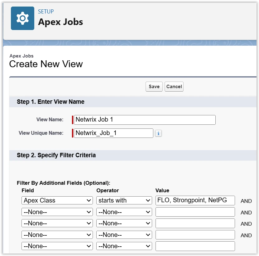

You can create your own Salesforce view for the scanners:
  1. Open Salesforce Setup.
  2. Search for apex jobs or navigate to Environments > Jobs > Apex Jobs.
  3. Click Create New View. Set up a Strongpoint scanner view
  4. Enter a View Name. The system assigns View Unique Name. Netwrix Jobs1 is used in this example.
  5. Select Apex Class for the Field.
  6. Select starts with for the Operator.
  7. Assign FLO, Strongpoint, NetPG for the Value.
  8. Click Save. You can now see the status of all of the Strongpoint jobs. Viewing running Strongpoint jobs
