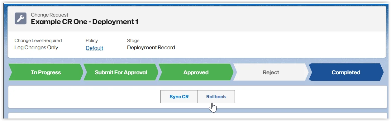

  1. Open the Deployment Record to rollback. To locate the record, click Change Requests and change the view to Deployments.
  2. Click Rollback
    Rollback button is only available for Completed Deployment Records

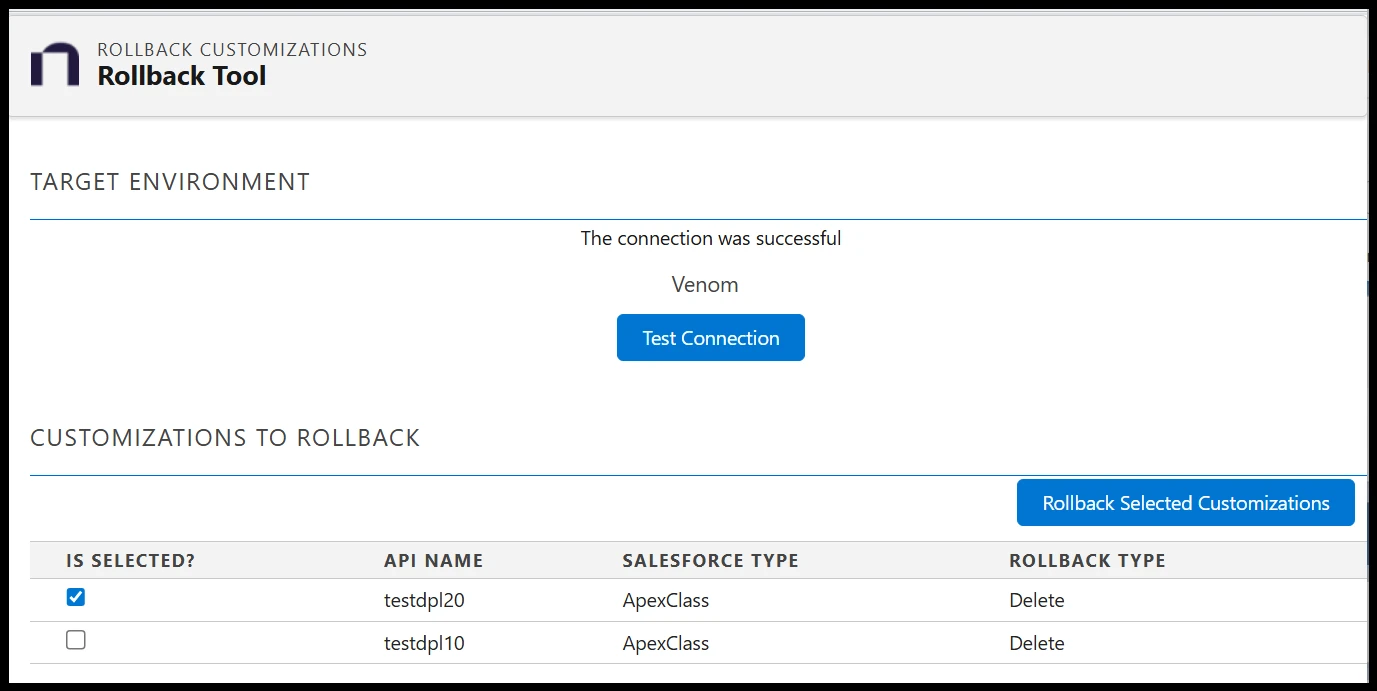

  3. Click Test Connection to ensure your credentials are working. If your credentials are not correct, you can click Save Credentials and edit.
    Rollback selected customizations
  4. By default, all of the customizations are selected for rollback. Deselect any customizations to keep. The Rollback Type specifies the effect of the rollback:
    • Delete: If a customization was created during the deployment, it is deleted during the rollback.
    • Override: If a customization existed in the target environment and was changed during deployment, it is reset to the previous version.

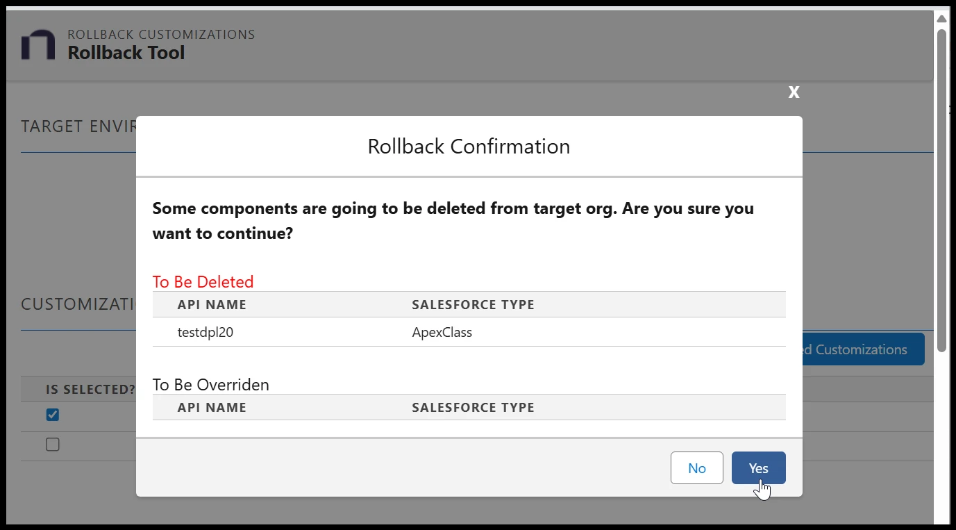

  5. Click Rollback Selected Customizations. The Rollback Confirmation is displayed.
    Rollback confirmation
  6. Click Yes to continue. A Rollback Record is created.
