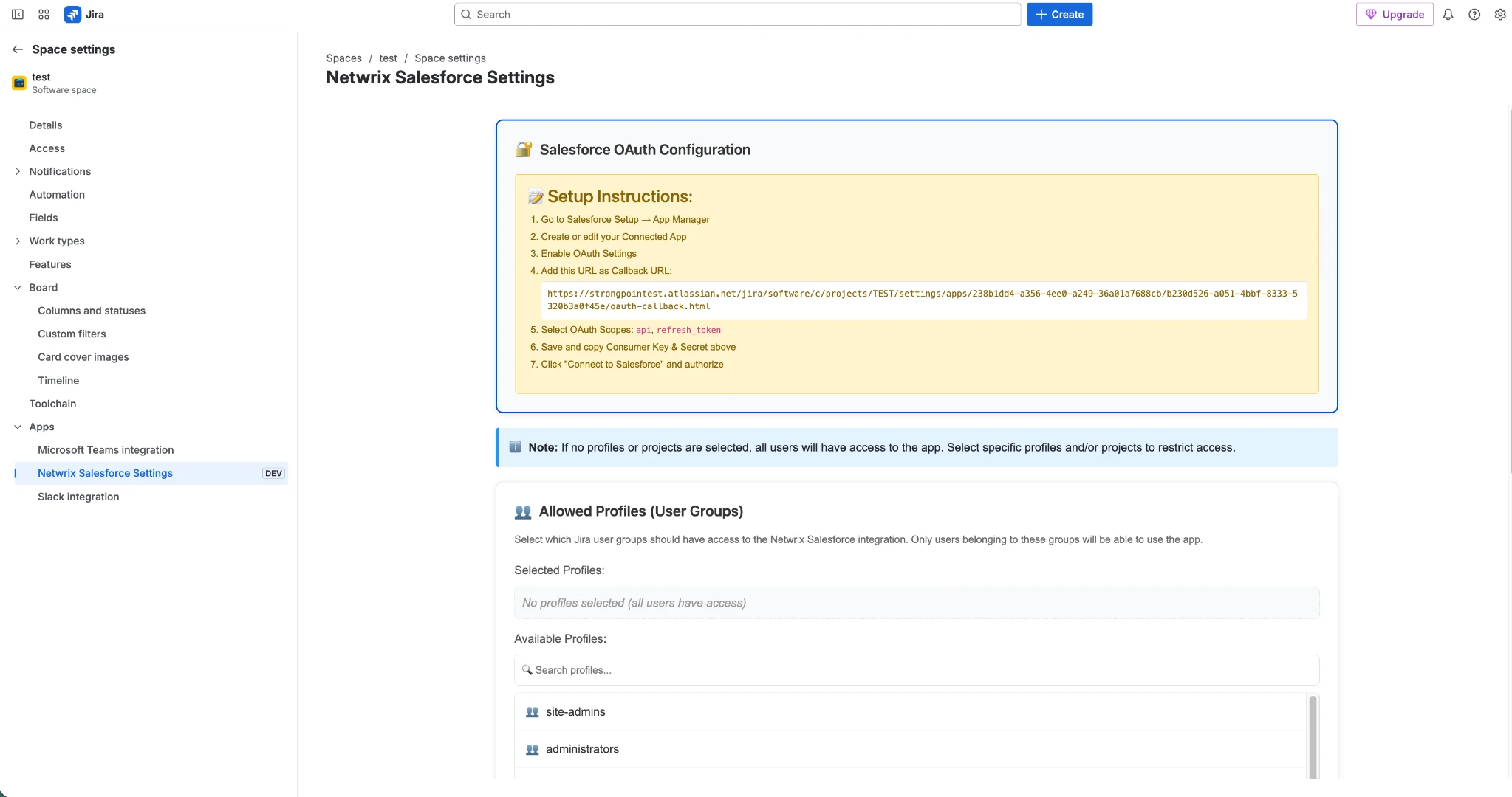

Setting Groups/Profiles Visibility
Access to the Jira Platform Governance for Salesforce integration can also be performed with Profile groups.
Users opening a restricted project receive a information message, instructions for enabling access, and a link to this topic.
The Strongpoint Salesforce Integration is not supported for this project.
Follow the instructions for Restricting Access to a Project or Setting Groups/Profiles Visibility to grant the user appropriate access.
  1. Open a Jira project.
  2. Select Space Settings.
  3. Select the Netwrix Salesforce Settings tab. There are two lists: Allowed Profiles (User Groups) are all of the current groups in Jira Allowed Projects are projects that can see the Platform Governance for Salesforce Jira integration. If Selected Profiles and Projects are blank, all groups have access to the integration.
    Newrix Settings Page
  4. Select an existing group and click Add to include it as a Selected profiles. To remove a group from the selected list, select it and click Remove. If Selected projects is blank, all groups have access to the integration. If there are one or more groups, then access is restricted to the specified group.
