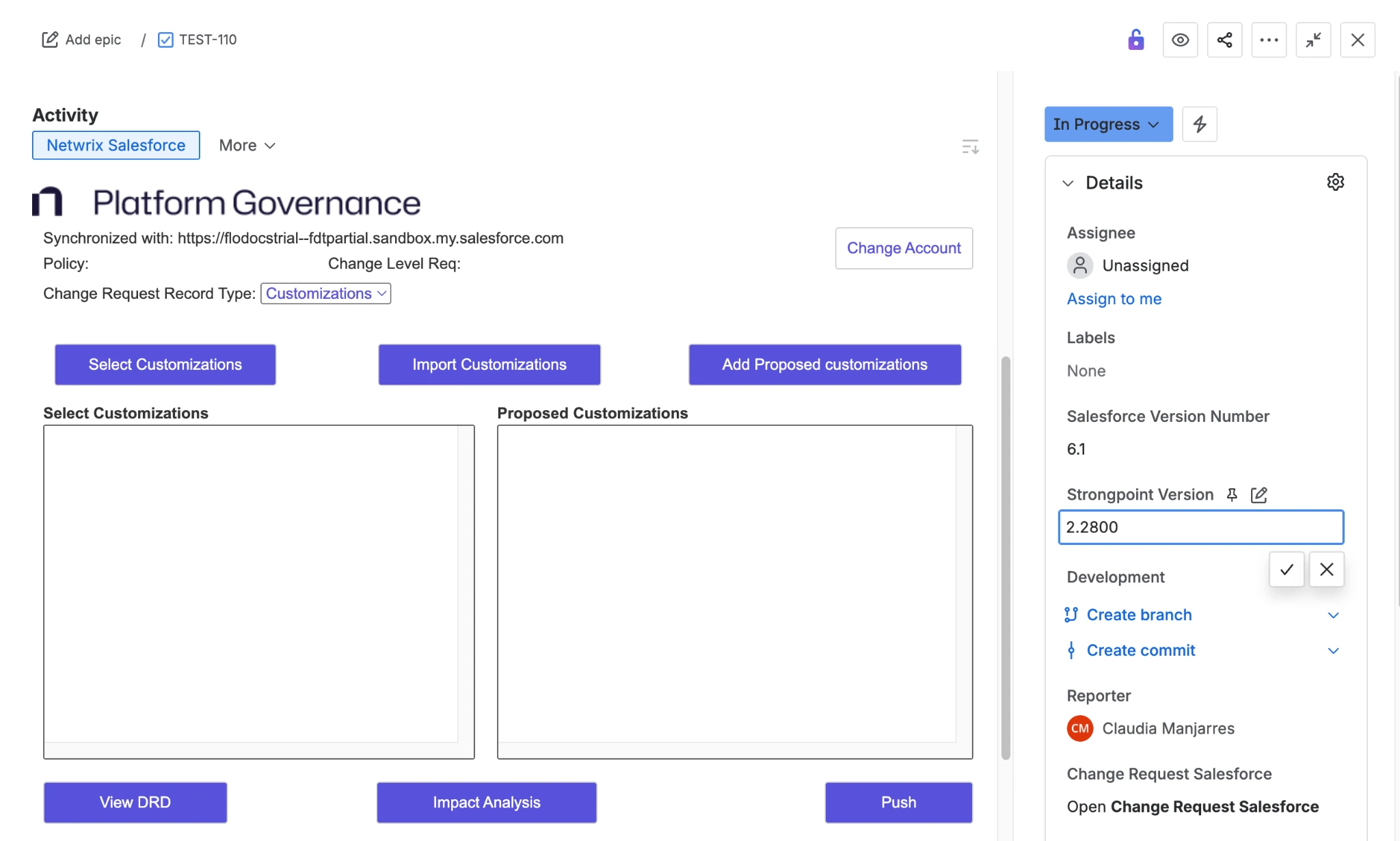

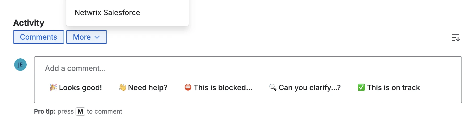

  1. Open the Comments tab and select Netwrix Salesforce.
    Accessing the Strongpoint Salesforce app

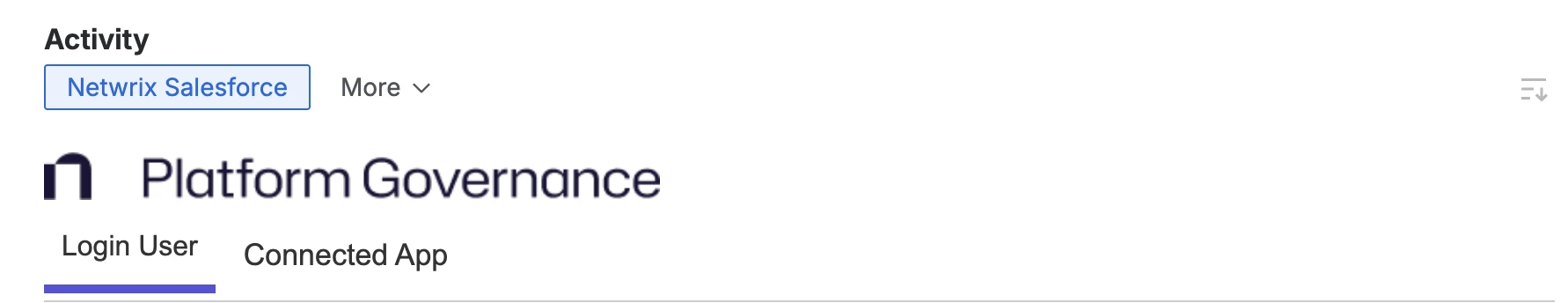

  2. There are two ways to connect: Login User or Connected App tabs.
    Connection options

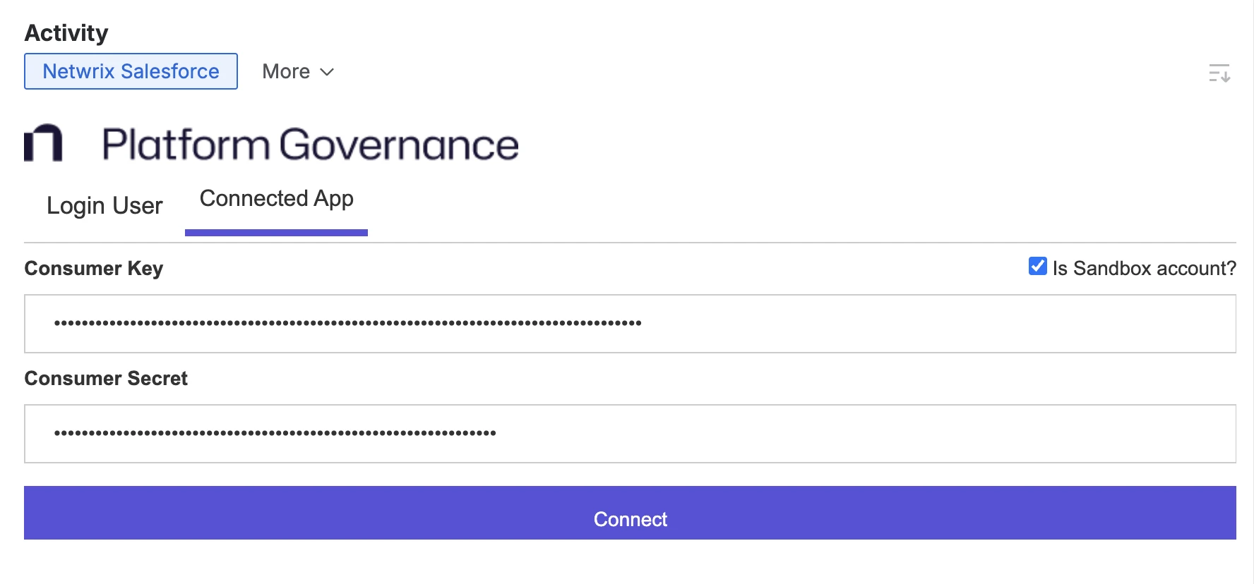

Connected App
Use the Connected App tab if you set up the connected app using the procedure: Access Data with API Integration
  1. Open the Connected App tab.
    Using the connected app
  2. Enter the Consumer Key and Consumer Secret.
  3. Click Is Sandbox account? if you are logging in to a sandbox.
  4. Click Connect. If this is the first time you are using the connected app, you are prompted to select your username. The connected app is configured for you. Once finished, click Close on the confirmation screen. The Strongpoint form is displayed. Your connection persists unless you click Change Account on the integration page.

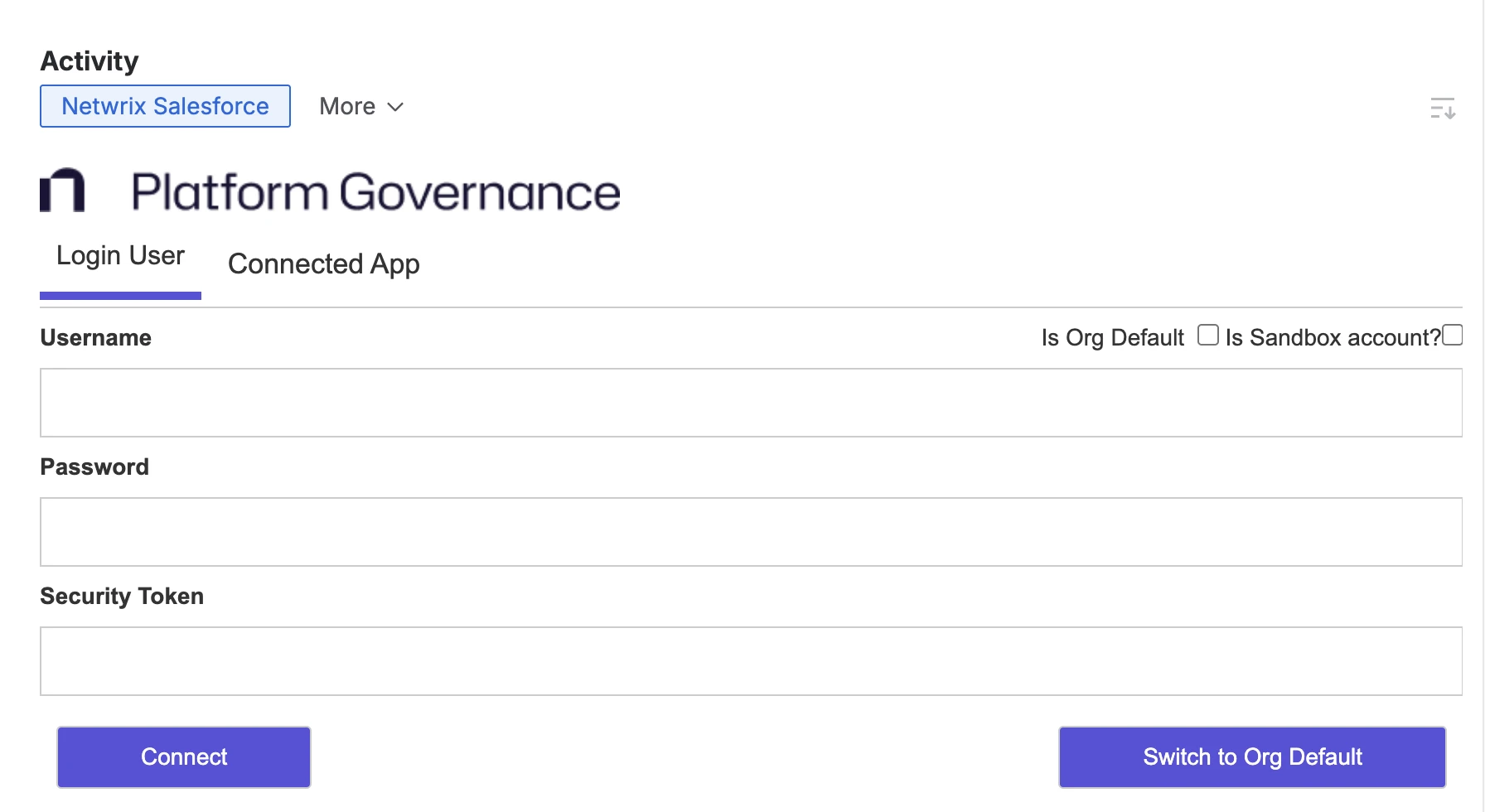

Login User
Enter your Salesforce Username, Password and Security Token. If you are using MFA or SSO: use your SSO Password. The Security token is the changing 6 digit code from your SSO or MFA app.
Enter your Jira credentials
If you do not have your security token, you can use these steps to reset your token:
  1. Log in to your Salesforce account.
  2. Open View Profile > Settings. Open your Salesforce Profile settings
  3. Select Reset My Security Token from the menu.
  4. Click Reset Security Token. Check your email for your new token.
  5. Click Sandbox Account? if you are using your sandbox.
  6. Click Connect. If the connection is successful, the form is displayed (see Add Customizations section). The Synchronized with status displays the org you are logged into for Salesforce.
You cannot login if you do not have the appropriate role permissions to create a change request.
If you do not enter the correct credentials, an error is displayed. After six unsuccessful consecutive attempts to login, your account is suspended for 30 minutes.

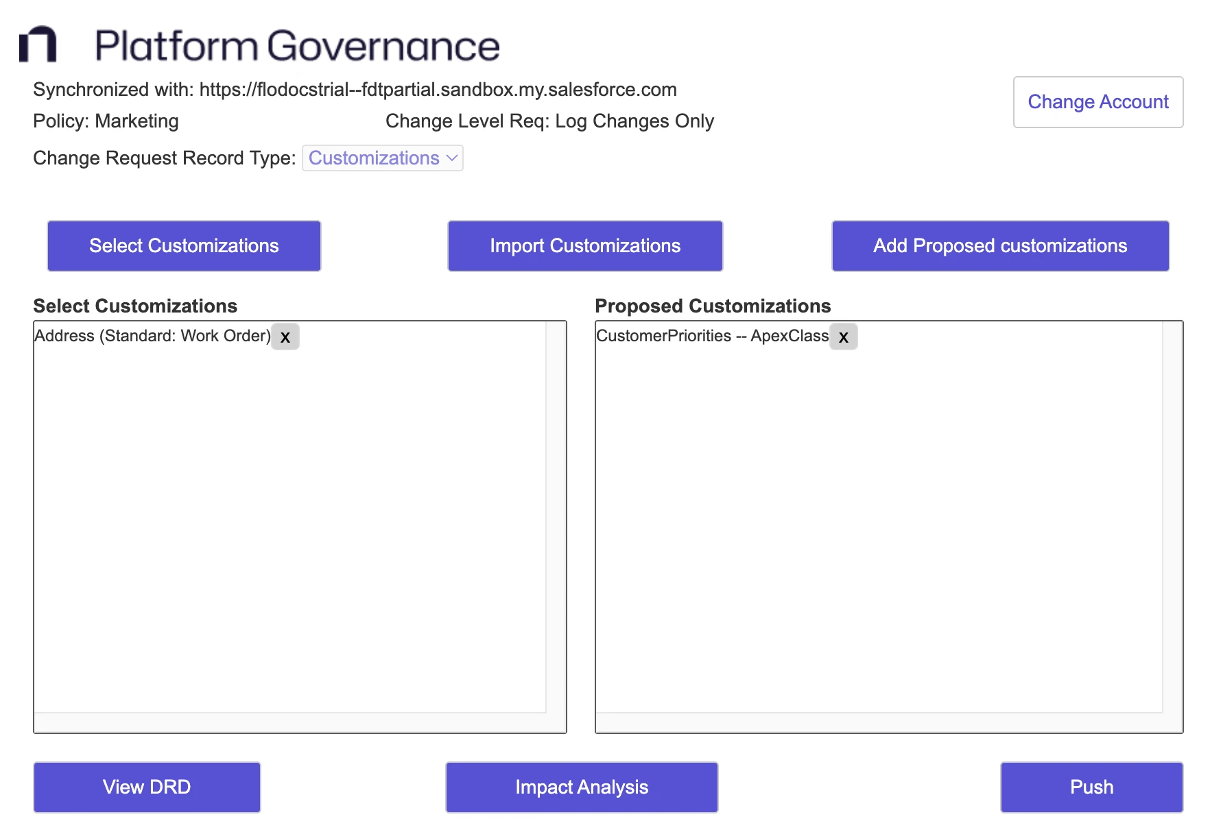

Add Customizations

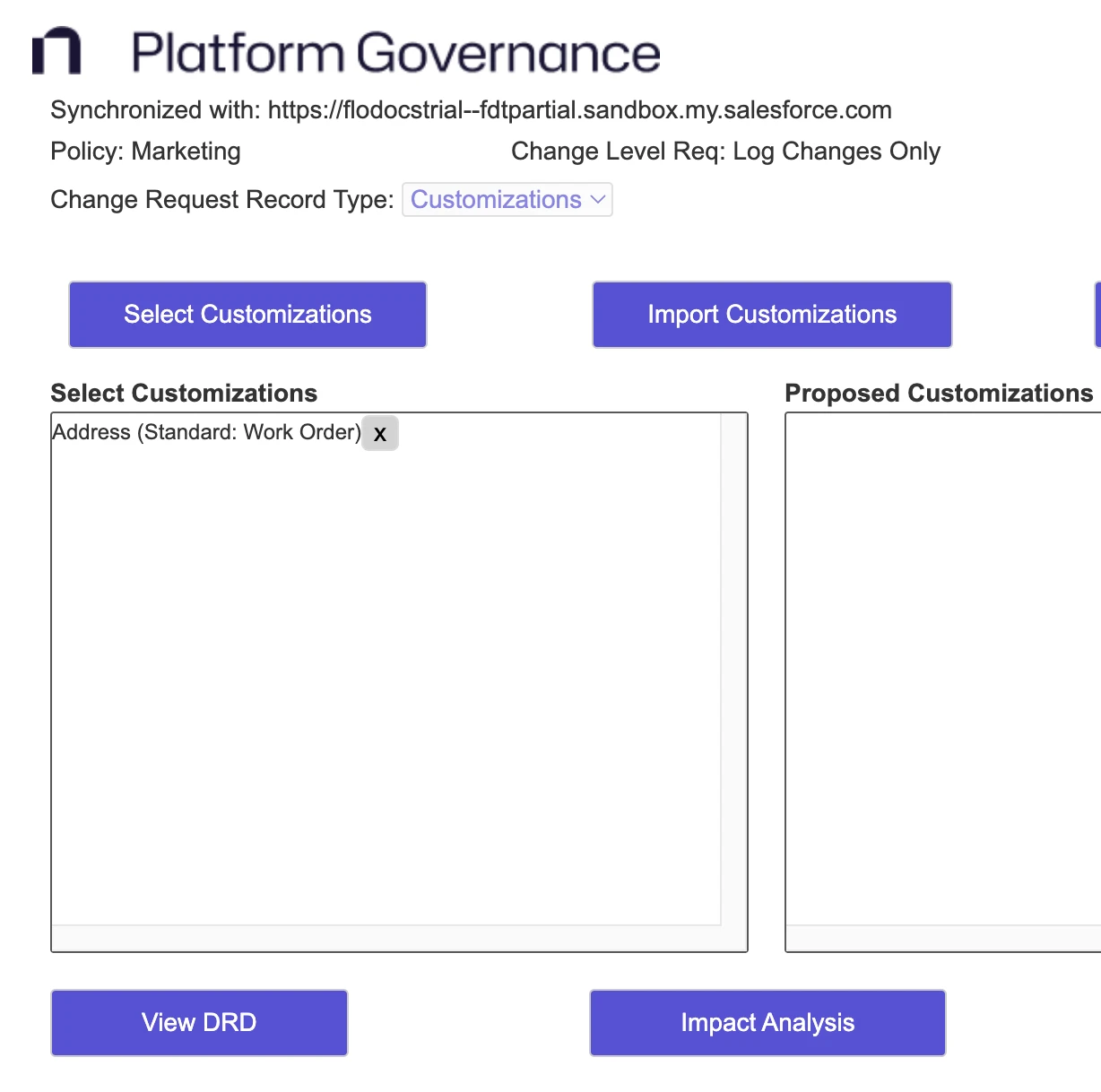

Once you have logged in, the form is displayed.
Connection details for the ticket
  • Synchronized with displays the connected Org. Click Change Account if you need to switch Orgs.
  • Policy is blank until Customizations have been added. The Policy is determined by the Customization with the strictest policy.
  • Change Level Req is blank until Customizations have been added. If there are multiple change levels, the most stringent one is applied.
  • Select Customizations is where you specify the Customizations you are changing or adding. If the Customization exists in your account, it is added to the Select Customizations list. Add Proposed Customizations are added to the Proposed Customizations list. You can delete added Customizations with the delete icon.
  • View DRD and Impact Analysis are tools to Perform Risk Assessment.
  • Push creates the Change Request in Salesforce. Push is also used to manually update your Change Request if you are not using the Automatic Synchronization feature.

  1. Enter a new, valid API Name in the Add Customization for Proposed Customizations field. For this example, enter CustomerPriorities.
  2. Click (Add Proposed customizations) to add it. If the API Name is valid, and does not match an existing API Name, the new Customization is added to the Proposed Customizations list.
    Add a proposed customization
Create the Change Request
Using the Platform Governance for Salesforce Jira integration, your Change Requests are created automatically when you add a Customization. To setup or update the status mapping, refer to setting up the Jira Statuses procedure.
  1. Change the Jira status of your ticket to match the status set up for CR In Progress. For example, In Progress. Refer to setting up the Jira Statuses procedure.
  2. Click Push to create the Change Request if you are not using the Automatic Synchronization feature. The change request is created in Salesforce with the In Progress status.
  3. Expand the Change Request field on the right. The status is now None/In Progress. There is a link to open the Change Request in Salesforce.
    Change Request is In Progress
Note the Policy and Change Level Req reflect the most stringent requirement for your selected customizations, in this example, Marketing and Log Changes Only.
Policy and Change Level Req have been updated

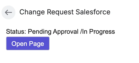

  3. Expand the Change Request field on the right. The status is now Pending Approval / In Progress. There is a link to open the Change Request in Salesforce.
    Change Request in Pending Approval

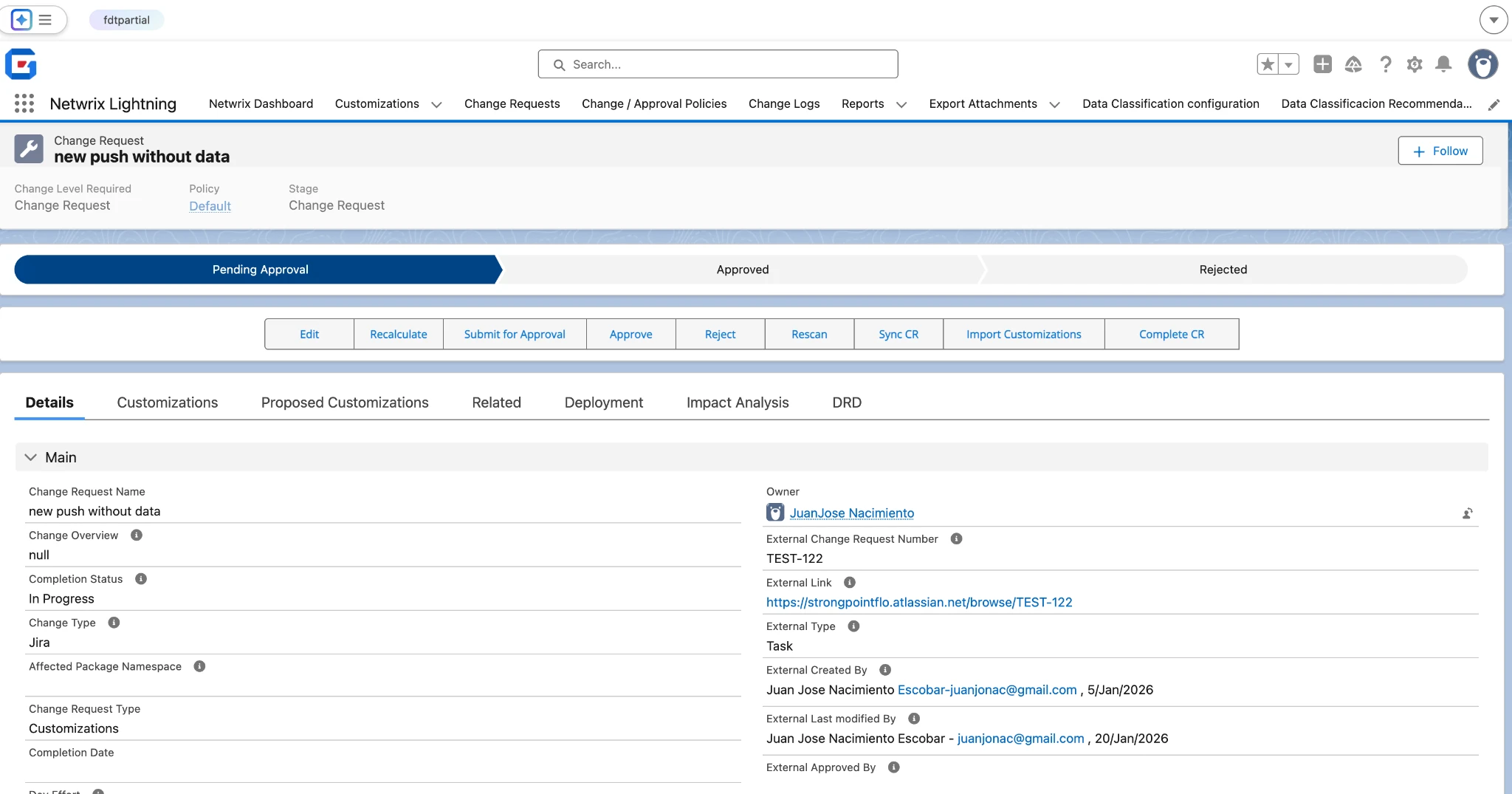

  4. Click the Go To Record link to view the Change Request.
    Change Request is In Progress / Pending Approval

If you open the Change Request in Salesforce:
  • All Customizations added from Jira are displayed.
  • Change Overview is set to the Jira ticket description.
  • Change Type is Jira, and External Change Request Number is the Ticket number.
  • Change Request shows as Completed.
  • External Created By: is the user that created the Jira ticket .
  • External last Modified by: is the last user who modified the Jira ticket.
