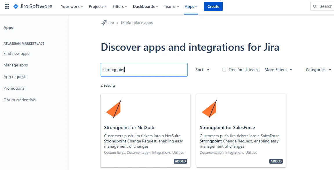

  1. Open your Jira Software Dashboard.
  2. Select Apps > Explore more Apps >
  3. Search for Strongpoint.
    Strongpoint apps in the Jira Marketplace
  4. Click Strongpoint for Salesforce to install the app.

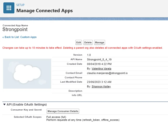

  2. Open the Connected App:
    Setup > Apps > App Manager > Strongpoint (where App Type = Connected)
    Open the Strongpoint Connected App
  3. Click the drop down arrow on the right side and select Edit.
  4. Set the Callback URL to https://spjira.my.salesforce-sites.com/SpHandleJiraAuth
  5. These Oauth Scopes must be selected:
    Full access (full)
    Perform requests at any time (refresh_token, offline_access)
  6. Click Save.
    Your connected app requires 2-10 minutes after you save before it is available.
  7. Click Manage Consumer Details.
  8. Copy the Consumer Key and the Consumer Secret codes to a clipboard. You are prompted for this information when you use the app.

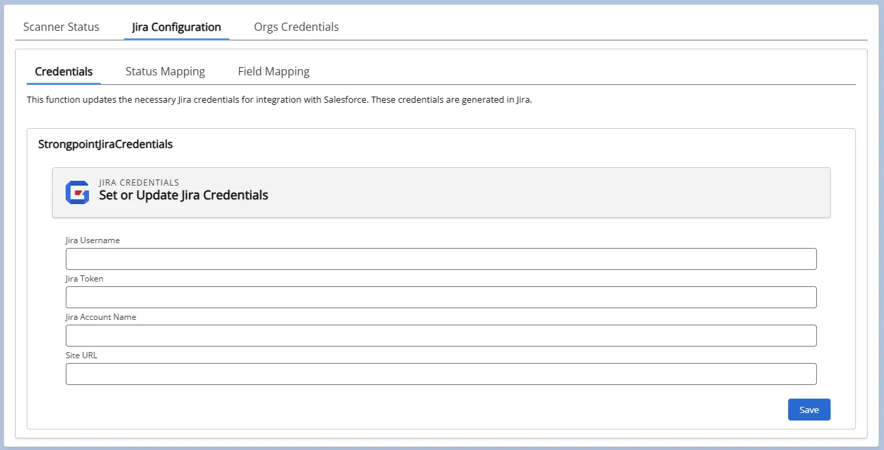

Set Up Jira Cloud Integration Credentials
  1. From the Netwrix Dashboard: click Configuration and Stats in the Resources section, or open Settings > Configuration and Stats.
  2. Open the Jira Configuration tab.
    Open the credentials
  3. Enter your credentials:
    • Jira Username is your Jira login email associated with your Jira API token.
    • Jira Token is your Jira API token. If you do not have your token, follow the steps in the Atlassian documentation.
    • Jira Account Name is the company specific part of the Jira site URL (https://_JiraAccountName**_.atlassian.net**). Only enter the JiraAccountName, not the entire URL.
    • Site URL is https://site.force.secure.com
  4. Click Save.

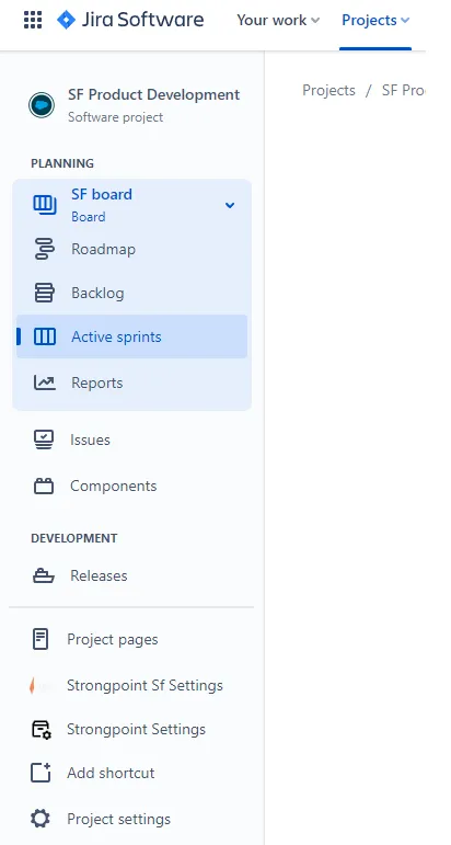

  1. Open a Jira project.
    Open a project
  2. Select Strongpoint Sf Settings.
  3. Select the Project Visability Settings tab.
  4. Enter the name of the project in the Visibility Settings. The specified project is the only one that is available to the Platform Governance for Salesforce integration. Leave Visibility Settings blank to allow all projects access.
  5. Click Save.
Only the specified project has access to the Platform Governance for Salesforce Jira installation. If Visibility Settings is blank, all projects have access.

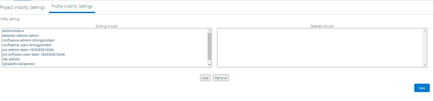

  3. Select the Profile Visability Settings tab. There are two lists:
    Existing Groups are all of the current groups in Jira
    Selected Groups are groups that can see the Platform Governance for Salesforce Jira integration. If Selected Groups is blank, all groups have access to the integration.
    Profile Visibility Settings
  4. Select an existing group and click Add to include it as a Selected Group. To remove a group from the selected list, select it and click Remove. If Selected Groups is blank, all groups have access to the integration. If there are one or more groups, then access is restricted to the specified group.

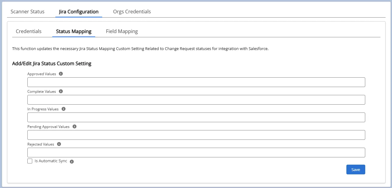

Set Up Status Mapping
  3. Open the Status Mapping tab.
    Set up the Jira status mappings for Change Request status
  4. Enter the mappings between your Jira statuses and the Change Request statuses. You must define your Jira statuses prior to this step. You can enter multiple Jira statuses for each Change Request status, separated by commas. For example, In Progress, Backlog. Assign your mapping for each of the Change Request statuses:
    • Approved Values
    • Complete Values
    • In Progress Values
    • Pending Approval Values
    • Rejected Values
  5. Check Is Automatic Sync to enable Platform Governance for Salesforce to handle the synchronization between Jira and Salesforce when a Ticket status is updated to a mapped status. without having to click Push. If you are using an org where you do not want to create a Change Request, leave this unchecked so you can do your research or testing without generating Change Requests.
  6. Change Requests are not automatically created, as not all tickets result in a Change Request. Tickets must be pushed to Platform Governance for Salesforce to begin the process. If Automatic Synchronization is turned on, then changes to the Status and Customizations are synchronized between Jira and Platform Governance for Salesforce without the need to keep manually pushing the changes.
  7. Click Save.
