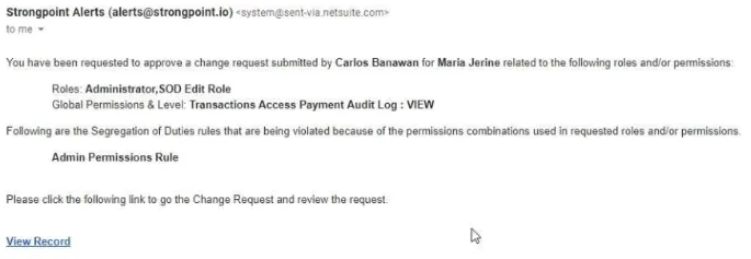

Once a change request is generated,Platform Governance for NetSuite sends email to the approvers. The email shows the requested change, the SoD violation(s) and links to the change request.
