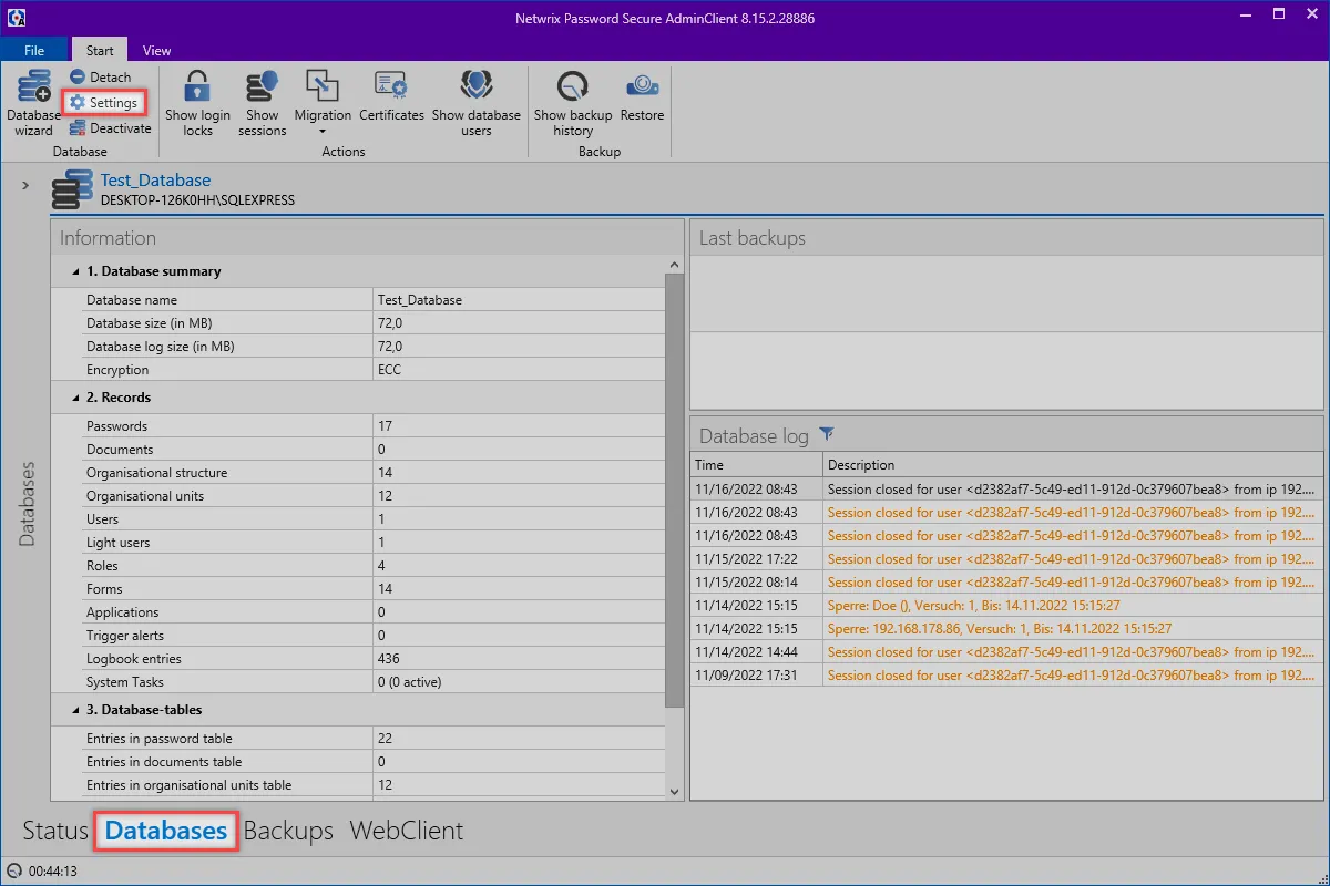

To use multifactor authentication on a database, it must firstly have been activated on the Server Manager. In the database module, open the settings for the selected database via the ribbon.
database settings

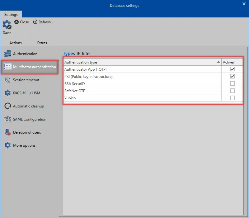

You can separately define in the settings whether it is permitted to use each interface on the database.

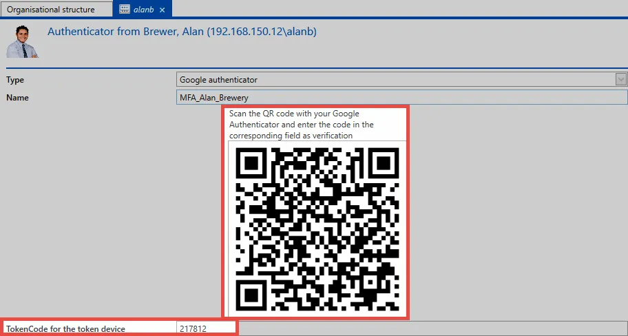

Google authenticator​
The prerequisite for this is that the relevant app has been started on a smartphone. After the name has been assigned for the authentication, you generate a new secret via the corresponding button. A QR code is displayed, which must be scanned using the Google Authenticator app on a smartphone.
google authenticator
After the Google Authenticator app has detected the QR code, it will return a 6-digit PIN. You must then enter it in the appropriate field. Finally, click Create in the ribbon.

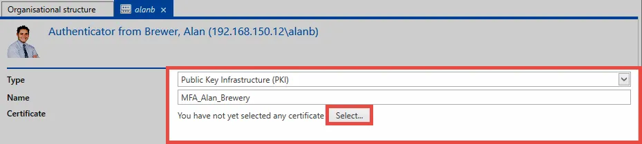

Public key infrastructure​
For PKI setup, the Select button is used to open the menu for selecting the desired certificate. All eligible certificates are displayed.
Select the desired certificate from the list to confirm the process.
