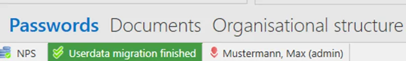

During the migration every E2EE-User of the database has to log in. Keep the client running until the message „Userdata migration finished” appears.
userdata_migration_finished_en
