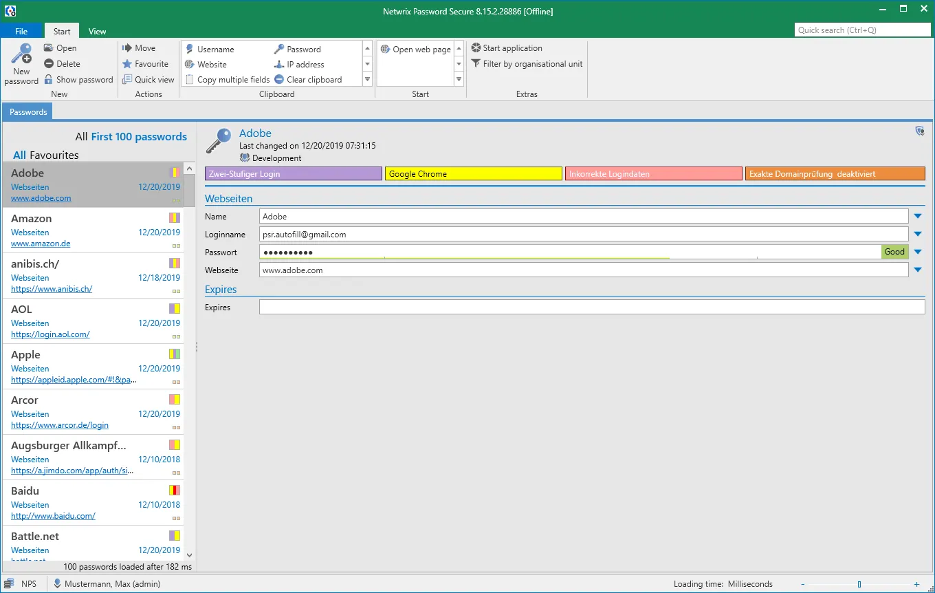

- There is no dashboard
- Only the password module is available
- The filter is not available. Records are found using the Search
- The automatic login data entry can be performed via the Autofill Add-on, independently of the Offline Add-on
