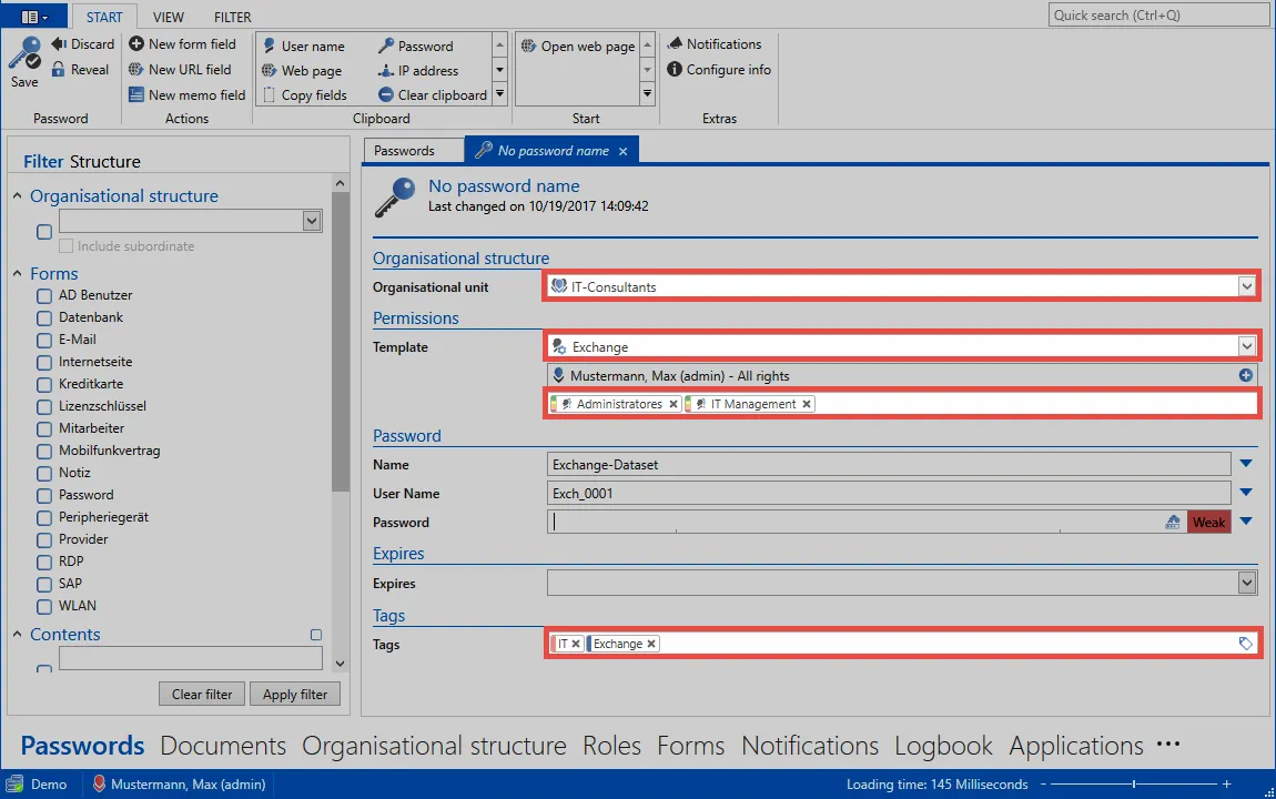

After you have configured Predefining rights, you can then use them to create new records. Proceed here as follows:
  • Select the password module
  • “New password” via the ribbon
  • Select a form
In the next window to appear, the organisational unit “IT” and the template group “Exchange” are selected.
predefined rights

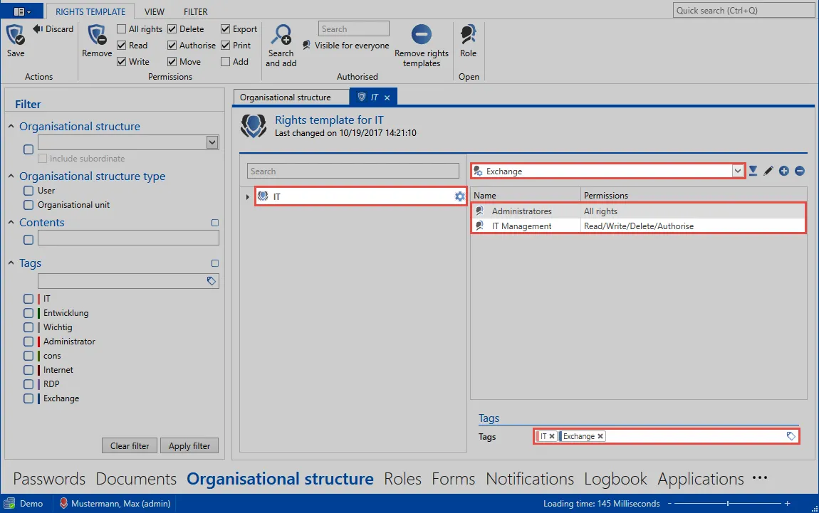

Here is the underlying rights template as a comparison:
example for predefined rights
The relationship between them is obvious. It can be immediately seen that by selecting the organisational unit “IT” based on the rights configured in the rights template, permissions are granted for the roles “IT management” and also “Administrators”. The underlying tags “IT” and “Exchange” are also set.
Preview of the permissions to be set

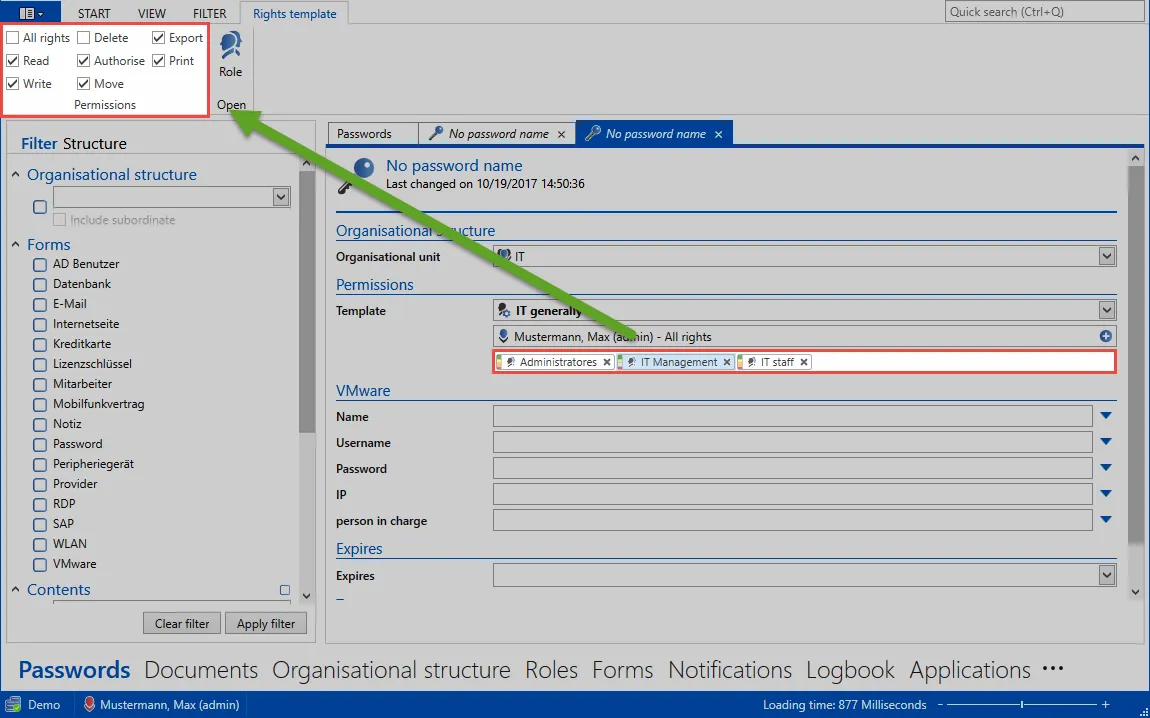

When using rights templates, the permissions to be granted can be very quickly classified via a color table. The actual permissions can also be viewed as usual via the Ribbon. The following color key is used with the associated permissions:
ColorPermission
GreenRead
YellowWrite
OrangeDelete
RedAuthorize
Other rights also exist that are, however, not separately indicated by a color. The overview in the ribbon can be used to see whether the “move”, “export” and “print” rights are set or not. The permissions for the selected role/user are always displayed – in this case for the role “IT management”.
predefined rights permiissions
