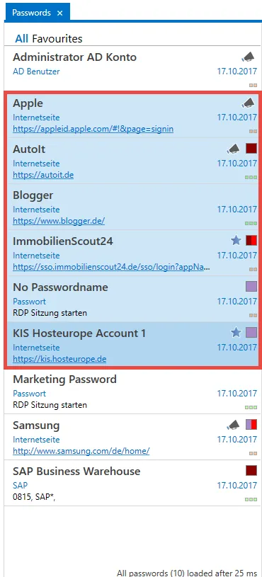

In list view, Shift or Ctrl + mouse click can be used to select multiple records. Permissions can also be granted for these records via the selection. The marked records are displayed in a different color. 6 records are marked in the following image.

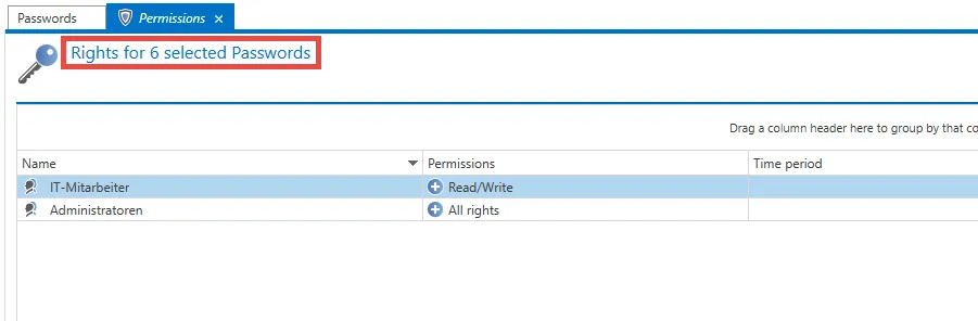

A new tab will be opened in the ribbon above the "Permissions" button in which the permissions can be configured. The tab will display the number of records that will be affected by the defined changes.
rights for selected passwords
NOTE: As the already granted permissions for the selected records may differ, it is not possible to display the permissions here.

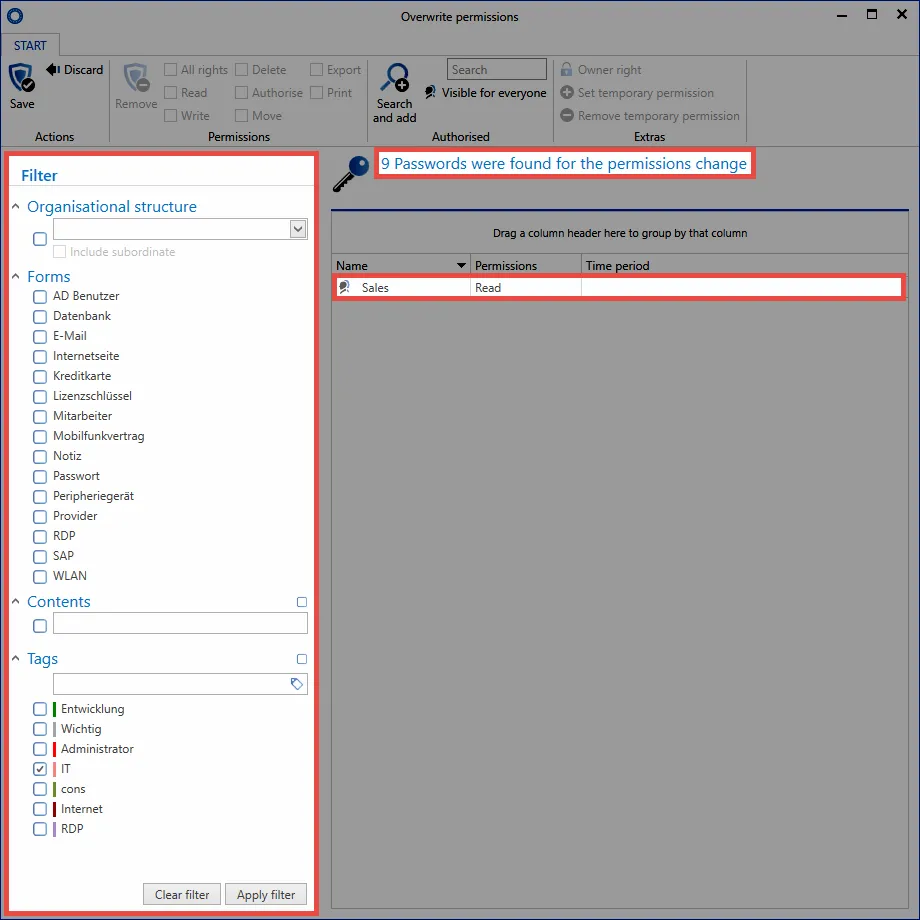

In some cases it is necessary to edit the permissions for a very large number of records. On the one hand, a maximum limit of 1000 records exists and on the other hand, handling a very large number of records via list view is not always the best solution. The Batch processing using a filter mode has been developed for this purpose. This is directly initiated via the ribbon.
In the subsequent dialogue, you define whether you want to expand, reduce or completely overwrite existing permissions. If you select expand or reduce at this stage, the same logic as for editing via list view is used. No permissions will thus be overwritten.
In the option overwrite permissions, the existing permissions are removed and then replaced by the newly defined permissions.
CAUTION: It is important to proceed with great caution when overwriting permissions because this function can quickly lead to a large number of records becoming unusable.
permissions adapted on a filter
The filter itself defines the selection criteria for the records to be edited. The currently configured filter will be used as default. The records that will be affected by the changes are also not displayed in this view. Only the number of records is displayed. In the following example, 9 passwords are being edited to add the read permission the role "Sales".

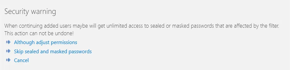

Sealed or masked records cannot be edited using batch processing. If these types of passwords are selected, a dialogue will be displayed when carrying out batch processing to inquire how these records should be handled.
security warning because of sealed or masked passwords
It is possible to select whether the affected records are skipped or whether the seal or password masking should be removed. If the remove option is selected, the process needs to be confirmed again by entering a PIN.
security warning
CAUTION: The removal of seals and password masking cannot be reversed!
