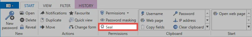

All seal configurations are performed in the wizard. Both the application of new seals as well as the processing and removing are possible. The current state of a seal can also be viewed in an overview, which is accessible via the button in the ribbon. When the seal wizard is opened via the ribbon, the wizard appears in the case of unsealed data sets, which runs in four steps through the configuration of the seal.
seal button

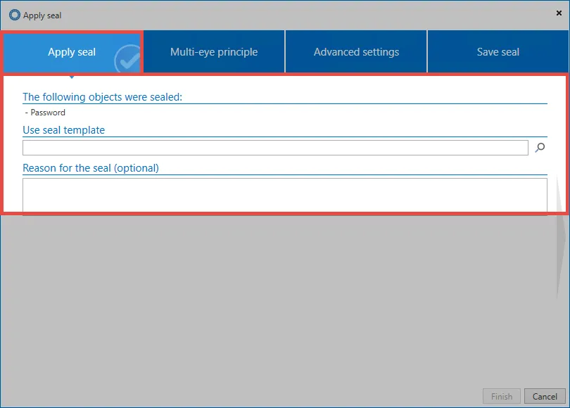

1. Apply seal
multi-eye principe
All objects that are sealed are displayed at the beginning. Depending on the data record, this can be one object, or several. It is also possible to use existing Seal templates. Optionally, you can enter a reason for each seal.

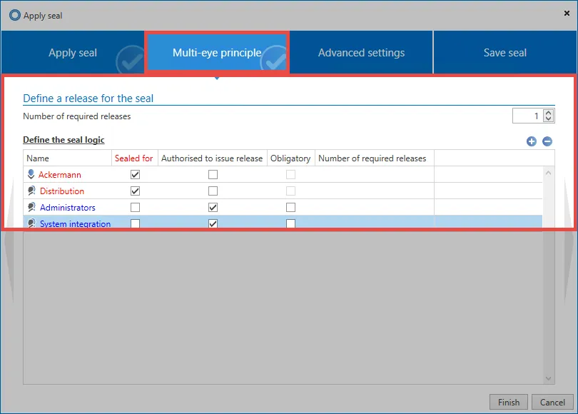

2. Multi-eye principle
The seal logic is the most basic element of this protective mechanism. Here, you define for which users or roles the record should be sealed or released in the future. All those for whom the record is to be sealed are displayed in red, while all users with the required permissions to issue a release are displayed in blue.
example permissions
NOTE: All users and roles for which the data set is not sealed and which are not authorized for release are displayed in green. These can use the data record independently of the seal.
To avoid having to perform any configuration manually, roles and users are copied directly from the authorizations of the data record. Compare with the "permissions" for the record (can be viewed via the ribbon).
example permissions
Supervisors should issue the releases for their employees. Therefore, the checkbox also follows the existing authorizations. The following scheme is used:
NOTE: All users and roles that have the authorize permission to the record are "authorized to issue a release" for the seal by default. All users and roles that do not have the authorize permissions to the record are copied directly into the "Sealed for" column.

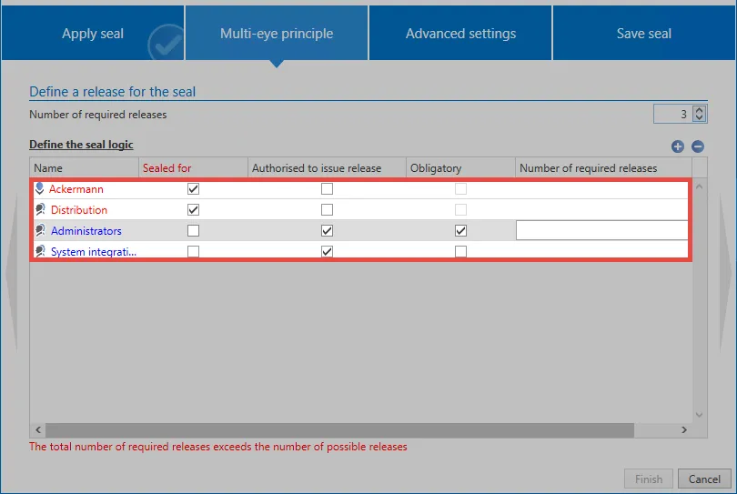

Adjusting the seal logic
Although standard authorizations are used as a basis for the sealing concept, these can be adapted. The number of releases generally required is as configurable as the required number of releases from a role. In the following example, the seal has been extended so that a total of three release authorizations are required in order to release the seal (Multi-eye principle). The role of the administrators has been marked in the mandatory column. This means that it must grant at least one release. In summary: A total of three releases must be made, whereby the group of administrators must grant at least one release.

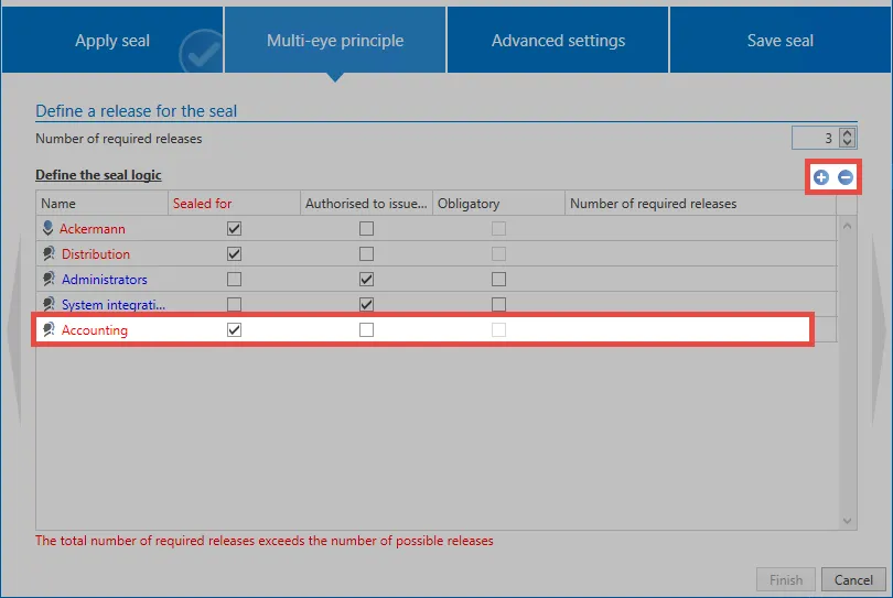

In order to be not only dependent on existing authorizations on the data set, other users can also be added to the seal. The role accounting under "sealed for" has been added below.
define permission for the seal
NOTE: When a role or a user is added to a seal, these users also receive permissions on the record according to the authorization granted in the seal. A role that is added under "Sealed for" receives the Read permission on the record. When you add authorization permissions, these will include the Read, Write, Delete, and Authorize permission.
CAUTION: All the roles that were once added to the seal can no longer be removed via the seal logic. This is only possible directly via the authorizations of the data record!

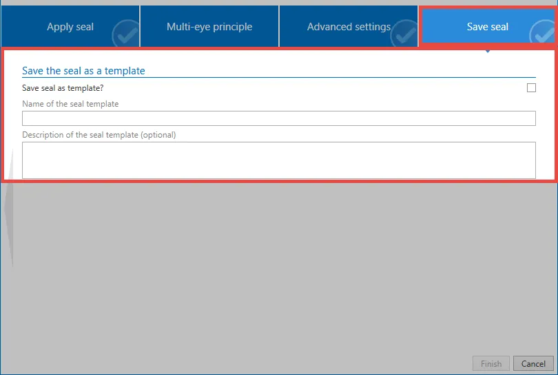

4. Saving the seal
Before closing the wizard, it is possible to save the configuration for later use in the form of a template. Seal templates can be optionally provided with a description for the purpose of overview.
