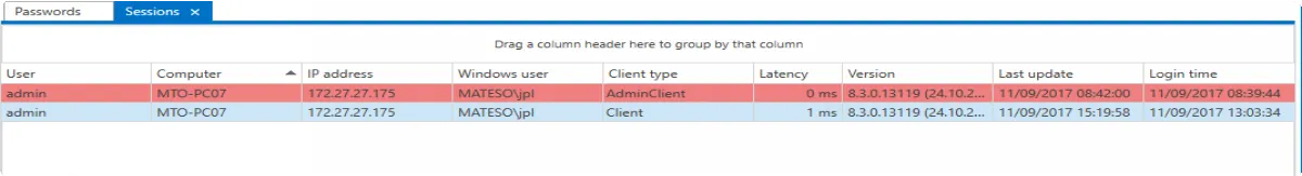

Sessions
Via the menu item Sessions, all users connected to the database can be displayed. This page is purely informative in character and thus no configurations can be made here.
installation_with_parameters_120
The session view starts in the currently active module in a separate tab.

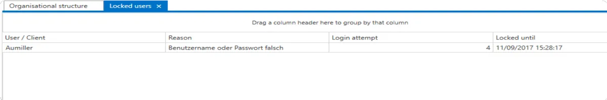

Locked users
All currently locked users can also be retrieved. There are two scenarios here:
  1. User name correct, password incorrect: The user name is displayed
  2. User name incorrect: The client is displayed
In addition, the number of attempted logins and the length of time that the user was locked in each case can be seen.
