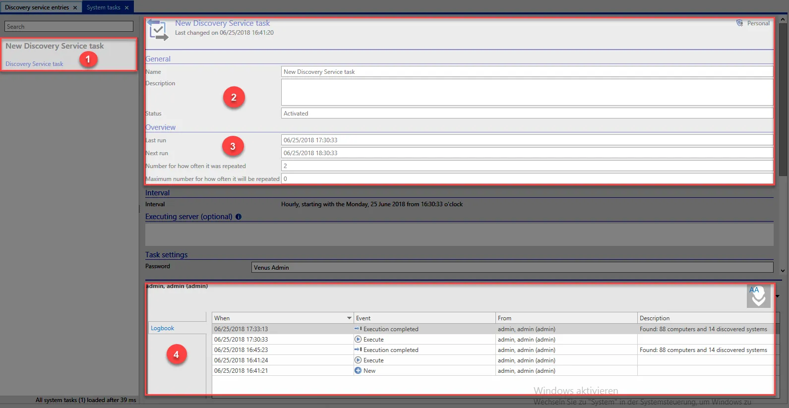

Discovered entries
The entries for the Discovery Service are discovered using a Discovery Service Task. It can take some time for all the data on the systems for the entered IP network to be collected. This can be easily recognized by the blue arrow symbol on the Discovery Service Task and a corresponding message is also shown in the General display. Once the Discovery Service Task has been completed, the data will be shown in the Discovery Service module.
new discovery service task
The Discovery Service Task needs to be carefully configured. The configurable sections are described below.
  1. Discovery Service Task: Display of the status: this can be updated in the preview and logbook using the F5 button. Red hand: Deactivated Blue arrow: Activated and being executed Boxes: Corresponds to the assigned tag
  2. General: The latest information about the Discovery Service Task is shown here. A message will be shown to indicate an active Discovery Service Task.
  3. Overview: Current data for the Discovery Service Task about its progress and subsequent executions are shown here.
  4. Logbook: The logbook can be found in the footer of the Discovery Service Task. The latest activities carried out by the Discovery Service Task are shown here.
NOTE: The data is not kept up-to-date while the task is being executed and does not always show the latest status. Therefore, the data should be regularly updated using the F5 button!

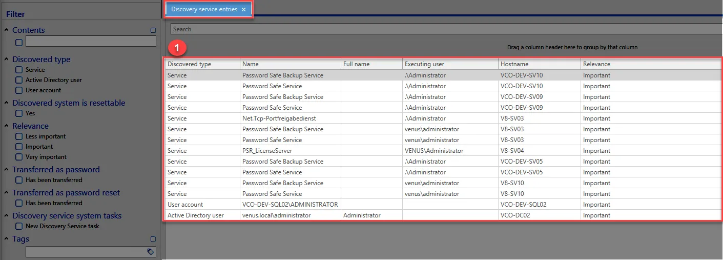

Using the Discovery Service entries
The successful execution of a Discovery Service Task is a requirement for the Discovery Service entries. The discovered data is listed in table form in the Discovery Service module and can be correspondingly organized using the Discovery Service System Task filter.
discovery service entries
In this section, the Discovery Service entries that were discovered by the Discovery Service Task and selected for the Conversion Wizard are displayed.

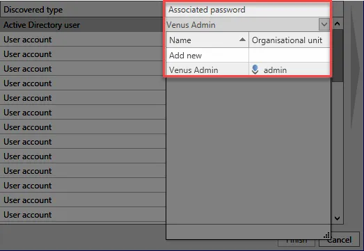

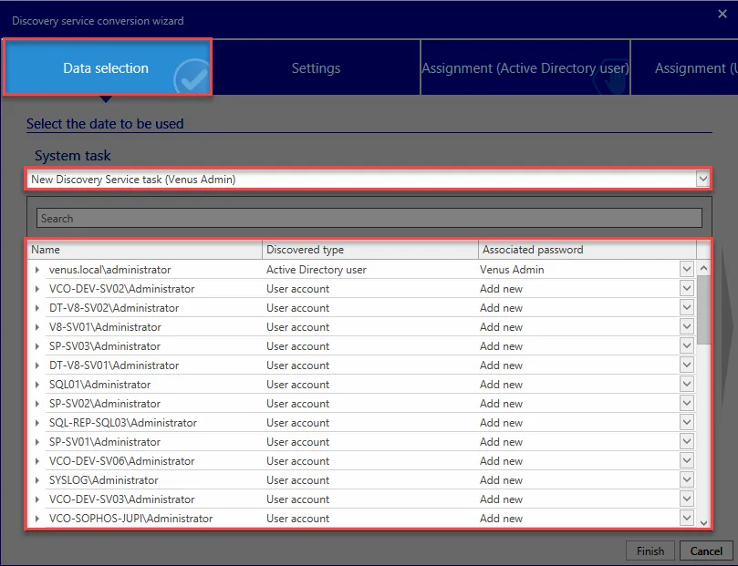

Multiple selection of Discovery Service entries
If multiple entries are selected for a Password Reset, a corresponding number of passwords and Password Resets need to be added in the Conversion Wizard. Depending on the entries selected (service, Active Directory user, user account), it is necessary to carry out corresponding assignments in the Conversion Wizard for the passwords.
Discovery service conversion wizard
Every line must be connected to a password in the end. Therefore, it is necessary to carry out an assignment process in the Conversion Wizard for every entry.
For Active Directory users, it is possible to assign an existing password.
NOTE: The subsequent process is carried out in the same way as when only one Discovery Service entry is selected.
