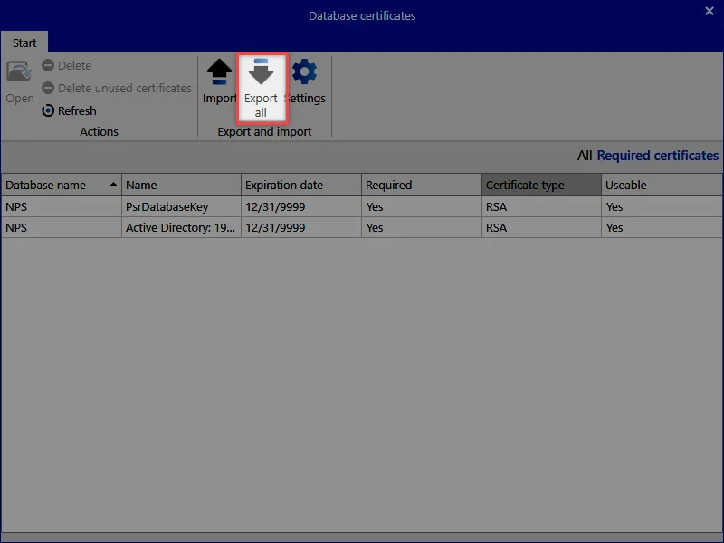

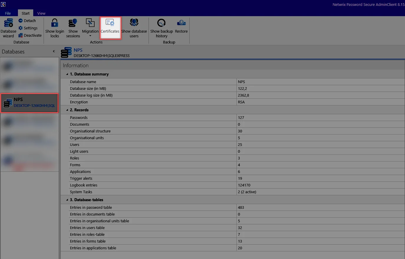

  • Backup all certificates using the Netwrix Password Secure Server Manager
Only certificate backups made through the Server Manager are valid.
Certificates
Export certificates

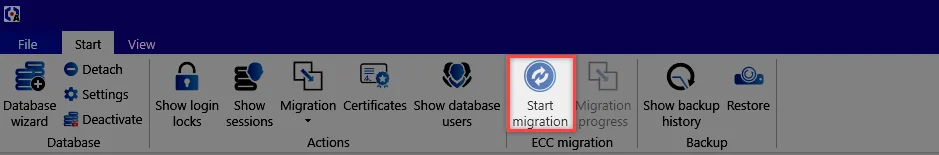

Start migration
Clicking on the icon “Start migration” in the databases' module to start the migration process
start migration

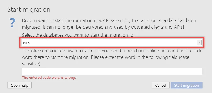

Select the database you want to migrate and enter the code-word.
Remember, The code word is “Start”. ensure that you have read the whole documentation. Otherwise, data loss might occur.

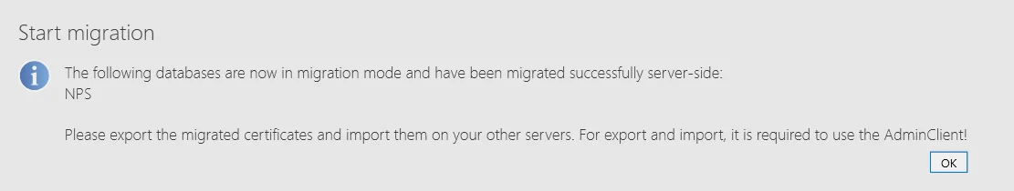

You should see the message, that the selected databases are now in migration mode:
start migration
As written in the message, export all required certificates via the Netwrix Password Secure Server Manager. If you have multiple servers in use import the certificates via the Server Manager at the end of the migration process.
If certificates are missing the migration can't be continued.

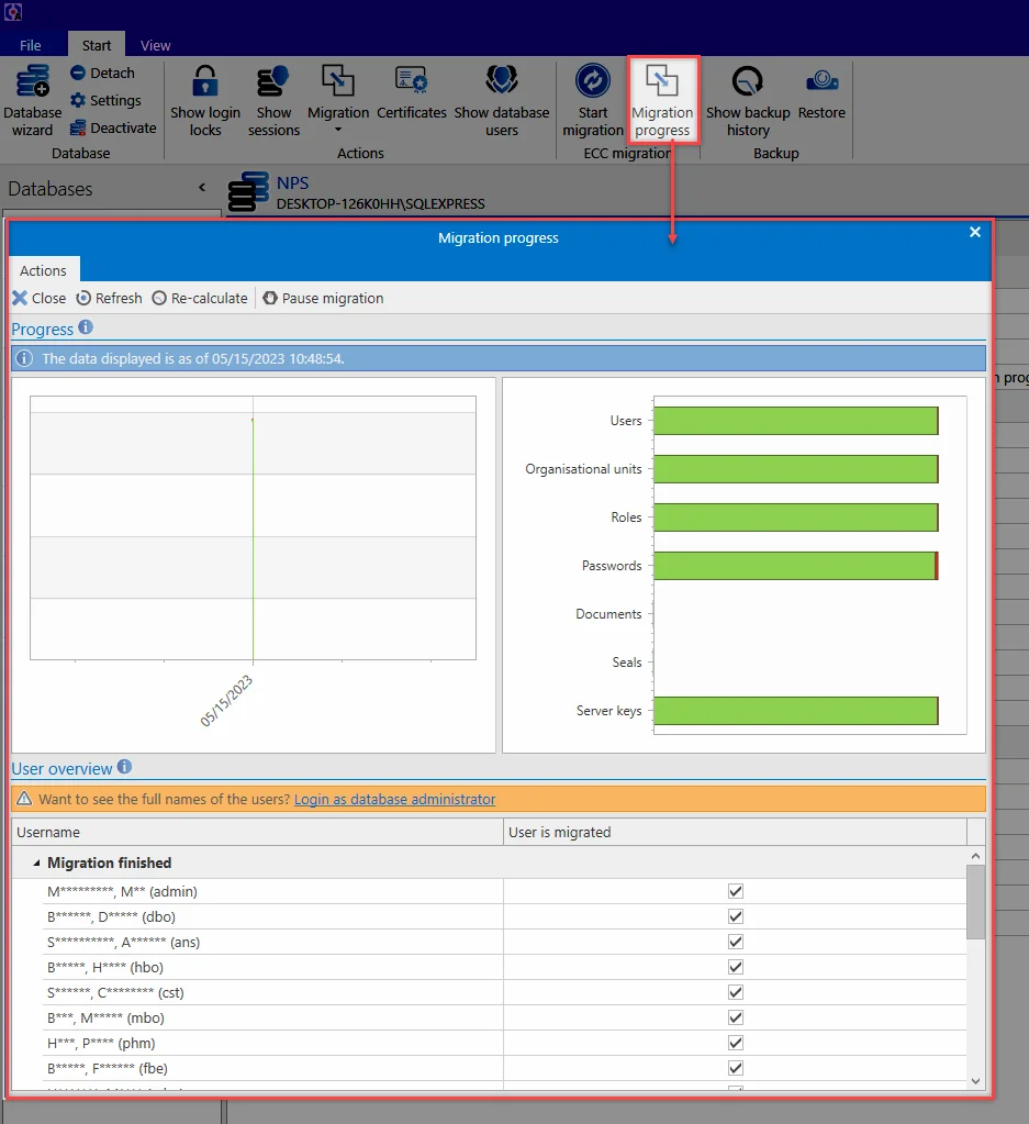

Watch the migration process
In the migration process you find all information about the current process, what's already migrated and what still needs to be migrated
migration progress

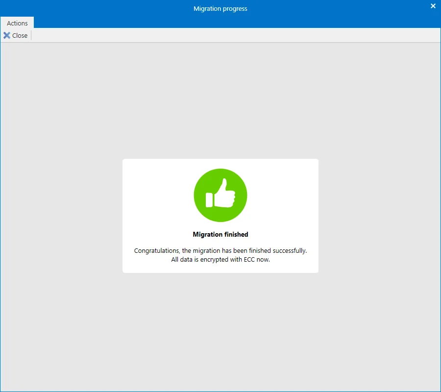

After each user has logged into the database and has been successfully migrated, the migration is complete.
migration finished
