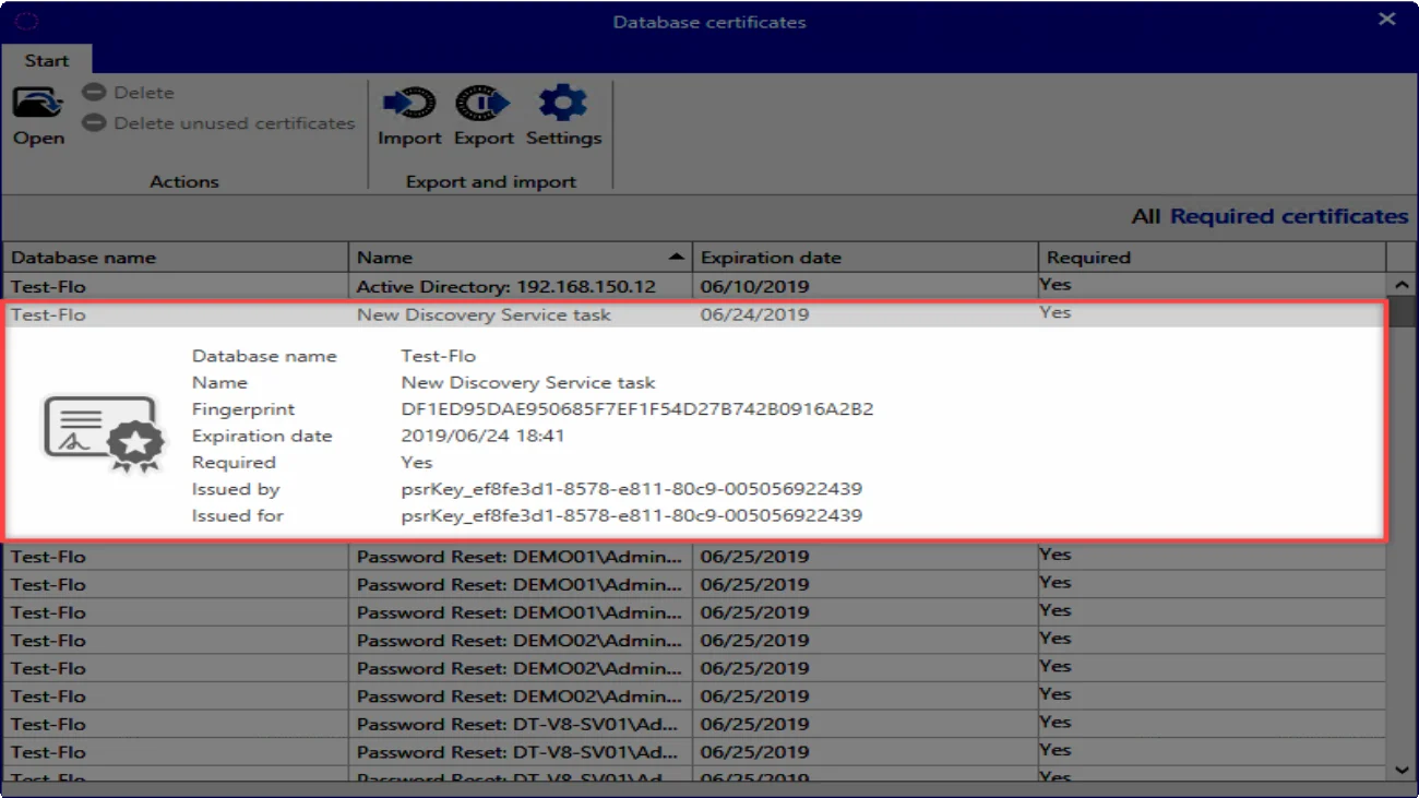

What is a discovery service certificate?
If a discovery service is created, a corresponding certificate is also created:
installation_with_parameters_202
NOTE: The discovery service certificate cannot be replaced by your own certificate.
NOTE: The certificates for the discovery service have an expiry date. However, this is not checked. The certificate thus does not need to be renewed.
CAUTION: If the database is being moved to another server, it is essential that the discovery service certificate is also transferred!
Exporting and importing the certificate
The section Certificatesexplains how to back up the certificate and link it again.
