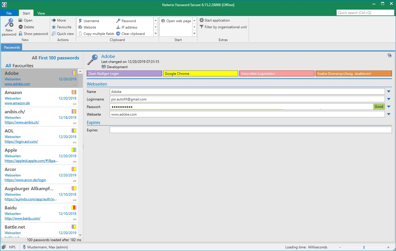

The Offline Add-on lets you work without an active connection to the Netwrix Password Secure server. If the corresponding setting has been configured (Setup and sync), the local copy of the server database will be automatically synchronized according to freely definable cycles. This ensures that you can always use a (relatively) up-to-date version of the database offline.

Operation of the Offline Add-on is generally based on the Operation and setup. Since the Offline Add-on only has a limited range of functions, the following must be taken into account with regards to its operation:
  • There's no dashboard
  • Only the password module is available
  • The filter isn't available. Records are found using the Search
  • The automatic login data entry can be performed via the Autofill Add-on, independently of the Offline Add-on
