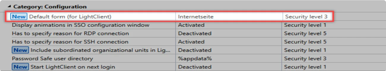

installation_with_parameters_156_795x595
NoDefaultForm
No standard form was selected. The form can be stored in the settings under Standard form (for the Basic view).

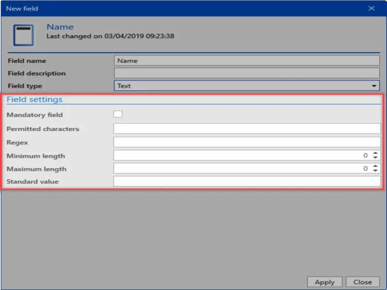

DefaultFormMissingFields
The form has been set correctly. However, the field types in the form must be checked. At least required: Text, user name, password, URL.
DefaultFormImpossiblePlausibility
When creating a password for an application, there's a field which isn't displayed. Therefore, the plausibility in fields should be checked.
