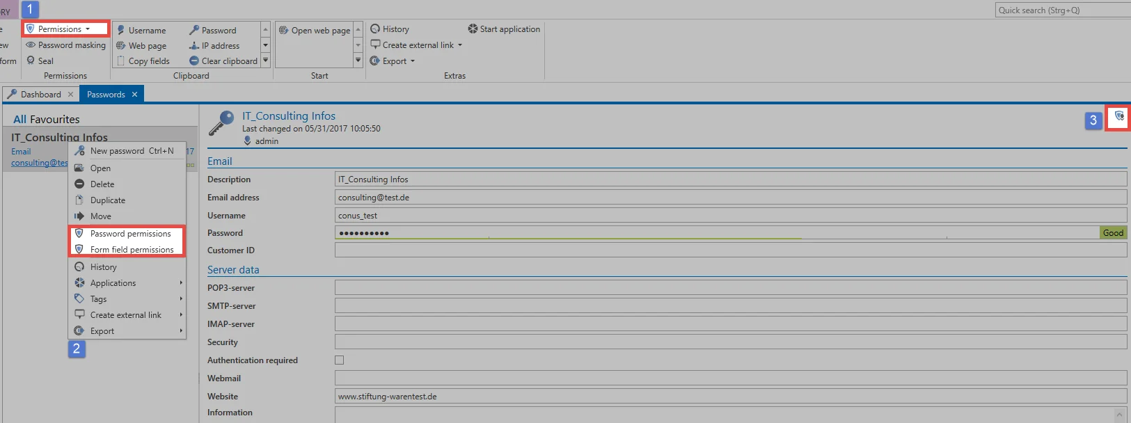

In the previous section, it was clarified that permissions are granted either directly to the user or to several users grouped in a role. With this knowledge, the permissions can be set manually. In the Passwords, there are three different ways to access the permissions in the list view:
  1. Icon in the ribbon
  2. Context menu of a data record (right-click)
  3. Icon at the right edge of the reading pane
The icon on the right of the reading pane shows the information whether the record is personal or public. In case of personal data records, the user that's logged on is the only one who has permissions.

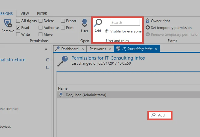

The author is created with all permissions for the record. As described in the Permission concept and protective mechanisms, you can now add roles and users. 'Right click - Add' inside the userlist or use the ribbon "User and roles" to add a user. The filter helps you to quickly find those users who should be granted permissions for the record.
add user and role
The search Filteropens in a separate tab and can be configured as usual.
seach filter

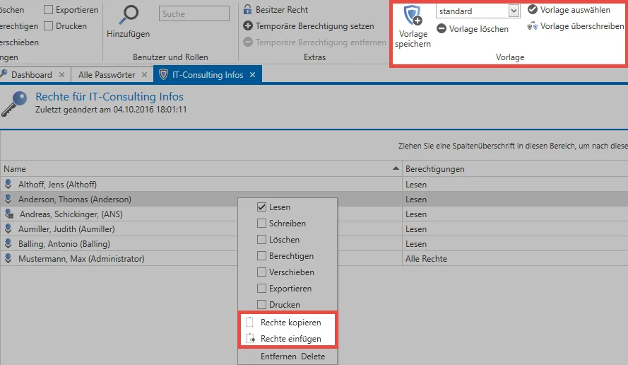

Transferring permissions
A simple right-click a user lets you copy and transfer permission configurations of users or roles to others in the context menu. In this context, the use of permission templates is also very practical. In the “Template” area of ​​the ribbon, you can save configured permissions, including all users, and reuse them for other records.
preset menu
The transfer of permissions and their reuse can be an important building block to create and maintain entitlement integrity. This method can't rule out misconfigurations, but it'll minimize the risk significantly. Of course, the correct configuration of these templates is a prerequisite.

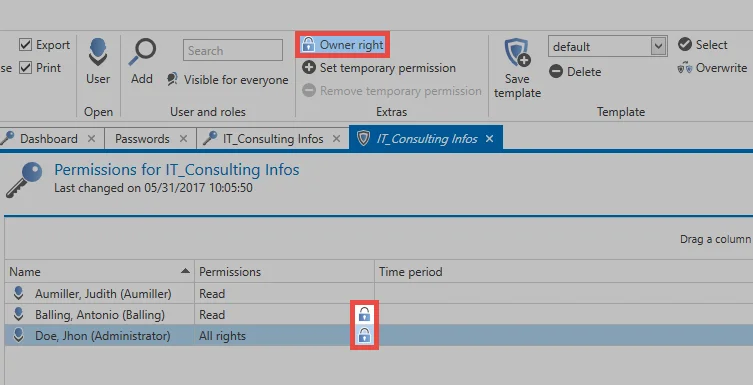

The owner permission
The "owner" permission can be set for a user. This permission is more of a guarantee. Once assigned, there's no way to remove the user or role. This is only possible by the user or the role itself, as well as by users with the permission “Is database administrator”.
owner permission
The owner permission prevents other users who have the “Authorize” permission from removing someone with the owner permission from the record.
The owner permission doesn't protect a record from being deleted. Any user who has deletion permission can delete the record.
