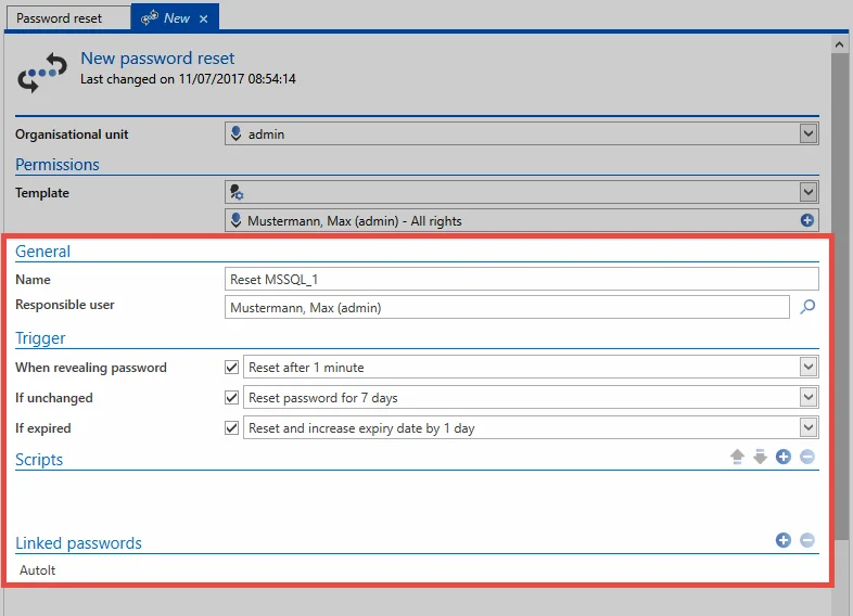

The configuration of a new Password Reset comprises four steps. All of the necessary conditions and variables for the configuration are defined in the following areas: "General", "Trigger", "Scripts" and "Linked passwords".
configuration password reset
General
  • Name: Designation for the Password Reset
  • Responsible user: All completed Password Resets are also recorded within Netwrix Password Secure (logbook,…). To ensure these steps can be allocated to a user, a user who's registered in Netwrix Password Secure is selected in the field "Responsible user".
Trigger
Triggers describe the conditions that need to be fulfilled so that a Password Reset is performed. There are a total of three possible triggers available:
  • Reset the password x minutes after the password has been viewed
  • Reset the password when it hasn't been changed for x days
  • Reset the password when it has been expired for x days
At least one trigger must be activated so that the Password Reset is activated. Deactivating all triggers is equivalent to deactivating the Password Reset. All three triggers can be activated and deactivated independently of one another. Only one selection can be made in each of the three categories.
A separate system task within Netwrix Password Secure checks every minute whether a trigger applies.
Scripts
A new dialogue appears after the selection in which the type of system "to be reset2 can be defined.
new script password reset
  • Script type: You select here from the possible script types.
  • Password: The credentials for the record that will ultimately carry out the Password Reset. The required information is specifically requested in each case. For example, if the reset is for an MSSQL user, the MSSQL instance, and the port used needs to be entered.
The functions and configuration process are described in detail in the section Scripts.
It isn't possible to create a Password Reset without an associated script.
Linked passwords
All records that should be reset with the Password Reset according to the selected trigger are listed under “Linked passwords”. Multiple objects can be entered. The linked Password Reset is also visible in the footer of the reading pane after it has been successfully configured.
