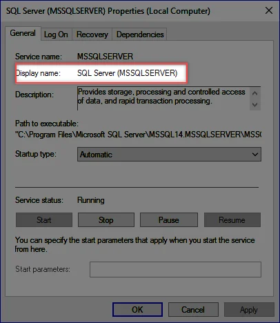

Service accounts
This script changes the access data within a service. Both the user and also the password can be changed. The host name – i.e. the target computer – and the service name are saved here.
Service accounts scripts
Please note that the display name for the service needs to be used.
display name service
The access data in the associated password can be saved as follows:

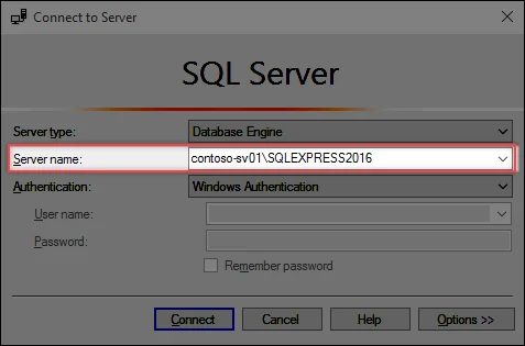

MSSQL user
This script resets passwords for local MSSQL users. It is only necessary to enter the MSSQL instance and the port.
MSSQL user script
The name of the MSSQL instance can be taken from the login window for the SQL Management Studio.
MSSQL user script
If a domain user is being used to log in to the SQL server, the user needs to be managed via the script Active Directory user.
