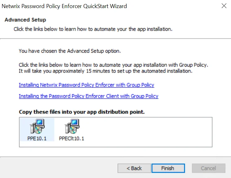

Copy PPE912.msi into the Distribution Point
Step 1 – Start the Password Policy Enforcer installer (PPE912.exe).
Step 2 – Read the license agreement, and then click Yes if you accept all the license terms and conditions.
Step 3 – Select the Advanced option, and then click Next.
Step 4 – Right-click the PPE912.msi icon, click Copy, and then paste the file into the distribution point.
installing_ppe
Step 5 – Give the Domain Controllers security group read access to the PPE912.msi file in the distribution point.
Step 6 – Click Finish.

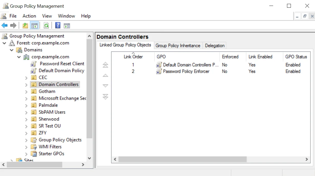

Create a Group Policy Object
Step 1 – Start the Group Policy Management Console (gpmc.msc).
Step 2 – Expand the forest and domain items in the left pane.
Step 3 – Right-click the Domain Controllers OU in the left pane, and then click Create a GPO in this domain, and Link it here...
Step 4 – Enter Password Policy Enforcer in the provided field, and then press Enter.

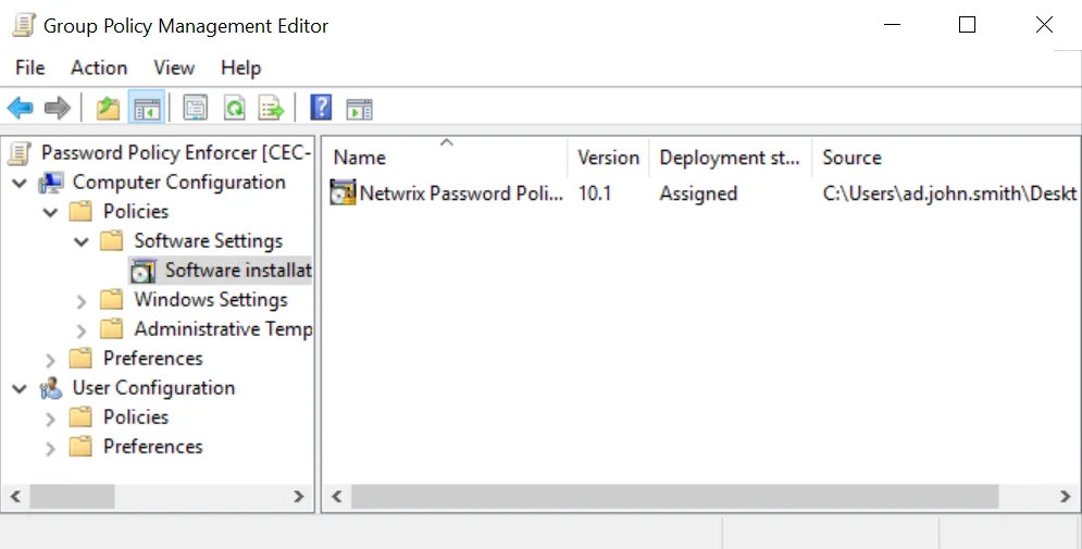

Edit the Group Policy Object
Step 1 – Right-click the Password Policy Enforcer GPO, and then click the Edit... button.
Step 2 – Expand the Computer Configuration, Policies, and Software Settings items.
Step 3 – Right-click the Software installation item, and then select New > Package...
Step 4 – Enter the full UNC path to PPE912.msi in the Open dialog box.
NOTE: You must enter a UNC path so that other computers can access this file over the network. For example: \file server\distribution point share\PPE912.msi
Step 5 – Click Open.
Step 6 – Select the Assigned deployment method, and then click OK.
installing_ppe_2
Step 7 – Close the Group Policy Management Editor.

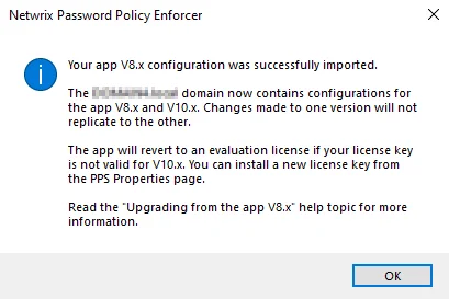

Open the Password Policy Enforcer V9.12 management console immediately after upgrading to automatically import the V8.x configuration settings into the new version.
installing_ppe_4
The management console imports valid subscription license keys, but it will not import V8.x perpetual license keys as they cannot be used with Password Policy Enforcer V9.12. Password Policy Enforcer will revert to a 30-day evaluation license if it cannot import the license key. Open the PPS Properties page page after an upgrade to check your license details. See the Configuration topic for additional information.
You can run a combination of V8.x and V9.x Password Policy Servers, but extended use of both versions is not recommended as it adds administrative overhead. Maintain both versions only for a short time while you roll out Password Policy Enforcer V9.x.
NOTE: Any configuration changes made from the V9.12 management console will only affect V9.x domain controllers. Likewise, any changes made from the V8.x management console will only affect V8.x domain controllers. You must make configuration changes in both management consoles until all domain controllers are upgraded to V9.x. Failure to do so may lead to inconsistent enforcement of the password policy.

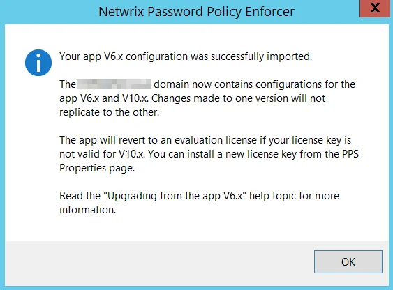

Open the Password Policy Enforcer V9.12 management console immediately after upgrading to automatically import the V6.x configuration settings into the new version.
installing_ppe_7
The management console imports valid subscription license keys, but it will not import V6.x perpetual license keys as they cannot be used with Password Policy Enforcer V9.12. Password Policy Enforcer will revert to a 30-day evaluation license if it cannot import the license key. Open the PPS Properties page after an upgrade to check your license details. See the Configuration topic for additional information.
You can run a combination of V6.x and V9.x Password Policy Servers, but extended use of both versions is not recommended as it adds administrative overhead. Maintain both versions only for a short time while you roll out Password Policy Enforcer V9.x. If you are using Password Policy Enforcer's Maximum Age rule and would like to enable the new extended maximum age feature for long passwords, then you must first upgrade the domain controller holding the PDC emulator operations master role to Password Policy Enforcer V9.x. See the Rules topic for additional information.
NOTE: Any configuration changes made from the V9.12 management console will only affect V9.x domain controllers. Likewise, any changes made from the V6.x management console will only affect V6.x domain controllers. You must make configuration changes in both management consoles until all domain controllers are upgraded to V9.x. Failure to do so may lead to inconsistent enforcement of the password policy.

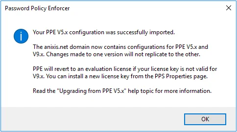

Open the Password Policy Enforcer V9.12 management console immediately after upgrading to automatically import the V5.x configuration settings into the new version.
installing_ppe_8
The management console imports valid subscription license keys, but it will not import V5.x perpetual license keys as they cannot be used with Password Policy Enforcer V9.12. Password Policy Enforcer will revert to a 30-day evaluation license if it cannot import the license key. Open the PPS Properties page after an upgrade to check your license details. See the Configuration topic for additional information.
You can run a combination of V5.x and V9.x Password Policy Servers, but extended use of both versions is not recommended as it adds administrative overhead. Maintain both versions only for a short time while you roll out Password Policy Enforcer V9.x. If you are using Password Policy Enforcer's Maximum Age rule and would like to enable the new extended maximum age feature for long passwords, then you must first upgrade the domain controller holding the PDC emulator operations master role to Password Policy Enforcer V9.x.
NOTE: The Maximum Age rule in Password Policy Enforcer V5.x granted users one grace logon after their password expired. Password Policy Enforcer V9.x does not allow grace logons, but some grace logons may occur until all domain controllers are upgraded. See the Rules topic for additional information.
If you have deployed the Password Policy Client and will be using the passphases feature, then update your existing Password Policy message templates to let users know that they may not have to comply with all the rules. See the Managing Policies and Configuration topics for additional information. You can use the new [PASSPHRASE_NOTICE] macro instead of hard-coding the message text into the template. Password Policy Enforcer replaces the macro with this text "You may not have to comply with all these rules if your password contains [n] or more characters."
NOTE: Any configuration changes made from the V9.12 management console will only affect V9.x domain controllers. Likewise, any changes made from the V5.x management console will only affect V5.x domain controllers. You must make configuration changes in both management consoles until all domain controllers are upgraded to V9.x. Failure to do so may lead to inconsistent enforcement of the password policy.
